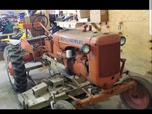

Not mine. Sure to sell quickly. Its in Saegertown, PA, but nobody knows where that is. It is near Erie.
And yes, it has a CA's wfe on it.
Comment in ad suggest non-runner - carb issue (bring spray bottle with gas to bypass carb issues and see how it runs.).

Picture shows it to be a Johnny Cash tractor. C rear end with CA front
Points: 93378
Post Options Post Options   Thanks (0) Thanks(0)   Quote steve(ill) Quote  Post ReplyReply Direct Link To This Post Posted: 08 Jul 2021 at 7:20pm
not a bad looking tractor.. ! mower is worth over half the price.

I'm trying to go look at it.  It doesn't look bad and I can use the mower.

I'm bringing it home tomorrow.  Mower is in good shape, tin is straight, has an alternator conversion on it, doesn't have as many oil leaks under it as the Super C it sat next too either.  The only negatives as far as I could see besides it not running was welds on wide front end, front tires are pretty bad with cords showing, magneto ignition not a distributor, no muffler, fuel system was cobbled up.  It will be a good mower for my 10 year old once I get it running.

It ran 4 hours after I got it home but it has a terrible backfire and the governor is surging badly.  Looks like an under hood muffler so plenty quiet.  It will shift thru all the gears, seems like that is sound.  I'm happy with it, even though I am still scratching my head a bit.

"Terrible backfire"
1. Exhaust valve too tight - never fully closes/burnt valve-pops worsen as engine warms up.
2. Exhaust leak(s) at exhaust port(s) and running very rich
3. Timing way too advanced
4. Multiple of the above.

Found two manifold bolts rusted away and gasket blown out. I think I have it figured Kmag, should be good in a week or so. The carb was the dirtiest I've ever cleaned.
