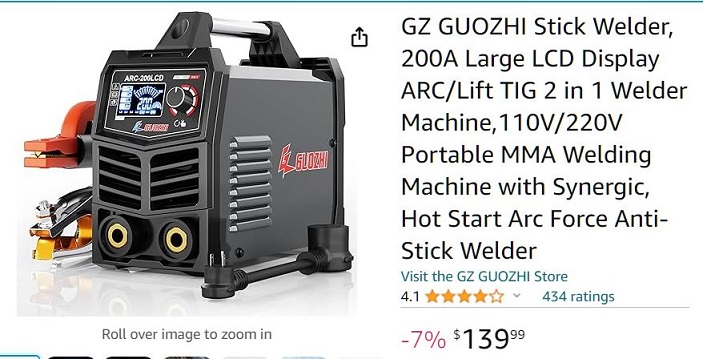

Well, i ended up ordering one of these welders on Amazon.. Looked at the reviews of several brands. The review on THIS BRAND mentioned that the power cable was 7.5 ft long, stinger and ground clamps were 500 amp models and the cables were 10 ft, 2 gauge instead of 4 ga.  All the brands look about the same and have basically the same power rating if your looking at the 200 amp models. They are 110 - 220 volts input.. There are smaller 130 amp models that run on 110 v only. Didnt want that.. This one also had $30. off last week so i got it for  $120. including tax.

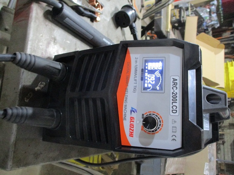

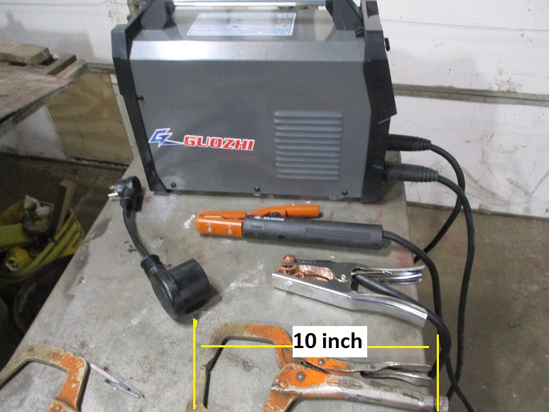

You can see the physical size of the stinger and ground clamp compared to a 10 inch vice grip.. Also gives you and idea of the welder size. And the weight is about 10- 12 pounds.
Points: 93505
Post Options Post Options   Thanks (0) Thanks(0)   Quote steve(ill) Quote  Post ReplyReply Direct Link To This Post Posted: 03 May 2024 at 12:56pm
No time to read the directions ( Wink.. ) ... Just plugged it into a 220 v 50 amp welding receptical and go... I thought there were going to be several "buttons" on the front to select rod size, hot start, etc... no... there is a resistor knob that goes from 20 - 200 amps and you see that on the digital read out. I normally weld at 90 amps on my MILLER.. Set this at 90 amps and it "says" your good for 3/32 rod ( 2.5 mm) .... Go to 92 amps and the readout says 3.2 mm rod..... guess that just gives you an idea of the amps needed if you know the rod size..

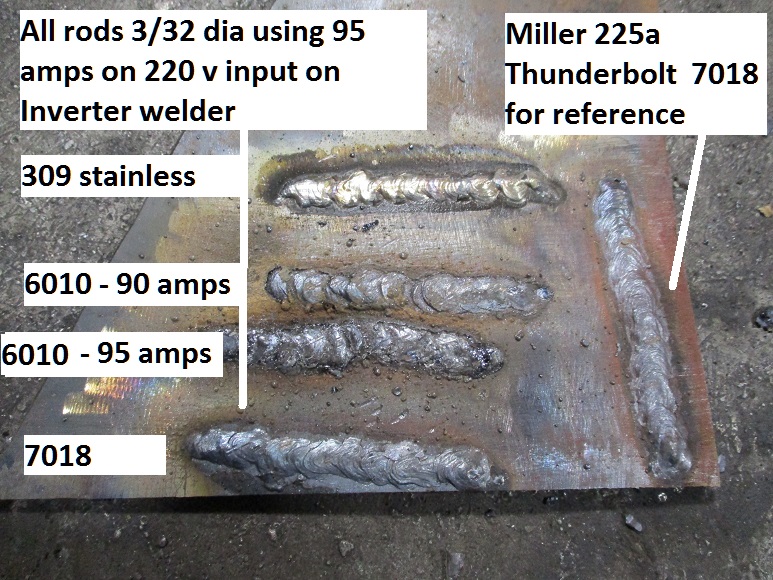

Just played with it 15 minutes before lunch.. Rand a 309 stainless rod, 6010 rod and 7018 rod... all i use is 3/32 rods and normally around 90 amps.... This gives you an idea of the quality of the weld.. ..  weld on the right is using my Miller 225a DC Thunderbolt ( 25 years old) as a reference of my ability. I tend to WEAVE a little side to side , so these  beads are like 5/16 inch wide.

I then got the "adaptor plug" that goes from 220v to 110 and plugged it in. You dont have to select anything.. The welder changes Internally to the correct input voltage... Tried to weld 6010 and somewhat disapointed at 90 amps.. Tried 95 and 100 amps. You could weld about 1/2 inch and then it would "stick" or "pop" and you had to start again.. I was hoping it would work better than that... Guess i will  READ THE BOOK and trie it a few more times. I planned to use the 220 90% of the time.. but would be handy to have the 110 available in some areas... Maybe using a 1/16 inch rod would work better as you could set the power down to  50- 60 amps... but i always use 3 /32 rod.
This is also a STRATCH TIG welder, but it does not come with that torch head. you have to buy that extra.. I didnt plan on ever using that options.. Just wanted a very BASIC portable stick welder.
SUMMARY .... does seem to do the job.. Seems like you have to "pay more attention" to what your doing... but maybe thats just me and only 15 minutes of testing ??

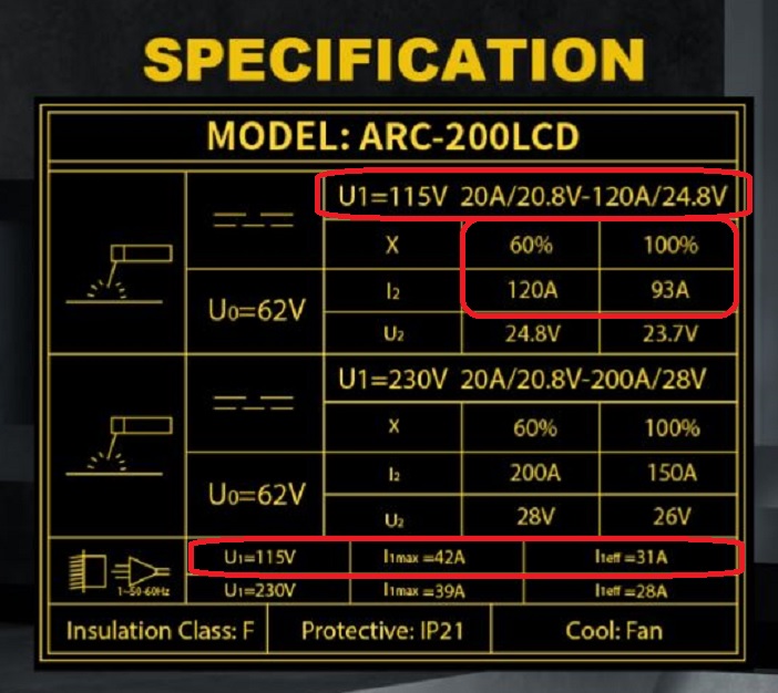

Played with the welder for 30 minutes yesterday. Getting better at understanding the difference between an inverter and transformer welder..
230v works great on 3/32"  7018 , 6010 and 309 stainless... I also have some Super 600 and MG500 that i "inherited" from a past life. That rod is .075 inch diameter or half way between 1/16 and 3/32 ..... I think you can weld it at 60 amps instead of 90 like i use on the 3/32 ..
The problem is when your plugged into 115v , the welder wants to pull 30 amps INPUT  to get 90 amps output.. Most house circuits are 20 amps so your only going to get about 60 - 70 amps OUTPUT... Thats why the 3/32 rod spits, sputters, and sticks.. You set it to 90 amps output, but i think your only getting 60.... I tried the Super 600 and MG500 and they weld GREAT.. so i think that proves the point.. I do have a 30 amp 115 v supply in the work shop, i may try that with the 3/32 rod to see how it goes.. Also have 5-10 pounds of the MG500- 600 rods so that should last forever if i need to weld on 115 v 20 amps INPUT in the future.
------- if i am readying the SPEC sheet right... you need 31 amps INPUT on a 115v line to get 93 amps OUPUT at the stinger..

Post Options Post Options   Thanks (0) Thanks(0)   Quote jaybmiller Quote  Post ReplyReply Direct Link To This Post Posted: 05 May 2024 at 7:25am
I read it as ...you need 42 amps to strike the arc, then  31 amps to lay the bead.

I think it says at
60% duty cylce, you get 120 amps OUTPUT to the stinger using 42 amps INPUT.
100% duty cycle you get 93  amps OUTPUT to the stinger using  31 amps INPUT
and that is on the 115 volt input... ( who has 30- 40 amp 115 volt service in the shop ??)
so using the abve numbers, at 20 amps INPUT you could get 60 amps output, which is plenty for the 1/16 inch rod or the .075 inch MG rod.... but NOT 3/32.

Post Options Post Options   Thanks (0) Thanks(0)   Quote jaybmiller Quote  Post ReplyReply Direct Link To This Post Posted: 05 May 2024 at 2:58pm
Unlike traditional pure  'transformer' based welders , inverters aren't necessarily 'linear'.
It'd be nice to see a real datasheet and schematic.

according to this website....
... 12AWG
BUT, and this is a big but.....
That drawing shows I1max to be 42 amps ! That should blow the 20A breaker the unit's plugged into.
What is 'weird' is that at 230 input, I1max is 39 amps ! ???
Normally when you double the volts, amps gets halved.....

Post Options Post Options   Thanks (0) Thanks(0)   Quote steve(ill) Quote  Post ReplyReply Direct Link To This Post Posted: 22 Sep 2024 at 8:47am
If your using a 3/32 rod you will need about 90 amps OUTPUT  on the welder.... On a 120 v system that would pull about 40 amps INPUT... on a 240v system that would be about 20 amps INPUT.... The 240 v setting on the chart is for 200 amps OUTPUT.. your not welding with a 3/32 rod at 200 amps..
This is why i say this are a little FUZZY on the "explainations".... YEA, you need 40 amps ( or 35) at 120v to get the correct output for 3/32 rod... Problem is like JAY says, your only going to get 20 amps INPUT at most houses.. so your OUPUT is going to be in the 40-50 amp range.. You can barely weld with 3/32 rod at that setting.. You can throw out goobers and gum balls, but hard to do a GOOD JOB..
I was able to weld with 6010 3/32 rod and do a half assed job on 120v... the 7018 rod would weld 1/2 inch bead then STICK.. over and over and over... you COULD do a small weld, but it was not easy....

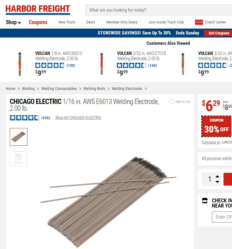

If i was going to try  a 120v welder, i would expect it to try to pull close to 20 amps. Using a 12 gauge extension cord ( or a section of 12-2 ROMEX) would be the best bet.. With a 14 gauge wire you can only pull 15 amps and that might not do so good.
Here is the VERY SMALL ROD that would probably be best to use with a 120 v welder.

Post Options Post Options   Thanks (0) Thanks(0)   Quote jaybmiller Quote  Post ReplyReply Direct Link To This Post Posted: 22 Sep 2024 at 9:13am
There is a problem in trying to 'do the math' as these are inverter tech welders and not just a transformer.
With the 'old skool' AC transformer there is a simple power in-power out math, however inverters change input power 120v/20a/60hz to  high frequency DC and store in capacitors, so you CAN get high amps out ,for a short while (aka 'duty cycle' ).
Points: 93505
Post Options Post Options   Thanks (0) Thanks(0)   Quote steve(ill) Quote  Post ReplyReply Direct Link To This Post Posted: 22 Sep 2024 at 9:19am
i would agree to some extent Jay.... but a 3pound welder dont have much room for a big capacitor... and the SPEC sheet clearly said it puts out 120amps a 42 input amps and puts out 90 amps at 31 input amps....( at 120v input)....... thats about 3 to 1 ..... so i say at 20 amps INPUT ( normal house), you MIGHT get 60 amps output..... VERY MINIMAL for 3/32 rod..

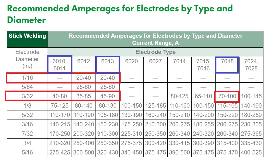

this chart shows how you MIGHT be able to weld 6010- 6011 3/32 rod with a small welder... the 7018 would be very questionable..
The 1/16 inch rod is easy to get in the right amps.... remember, what ever the OUTPUT amps is listed, you need about 1/3 of that as the INPUT AC POWER.
