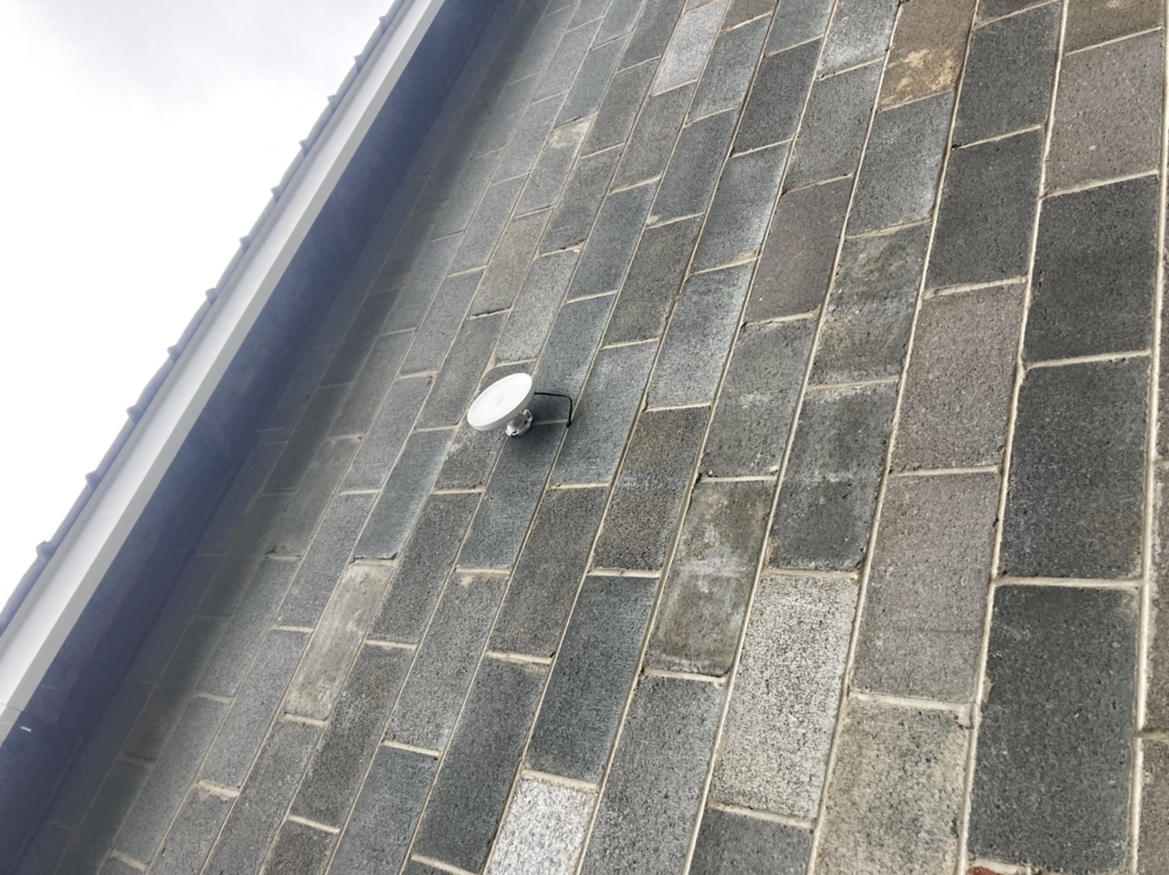

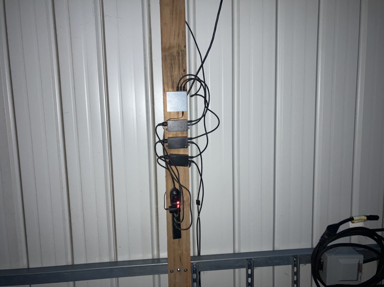

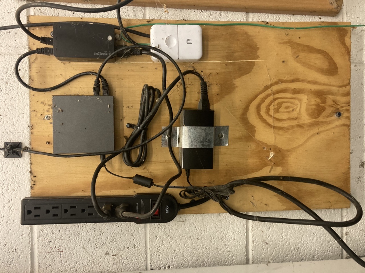

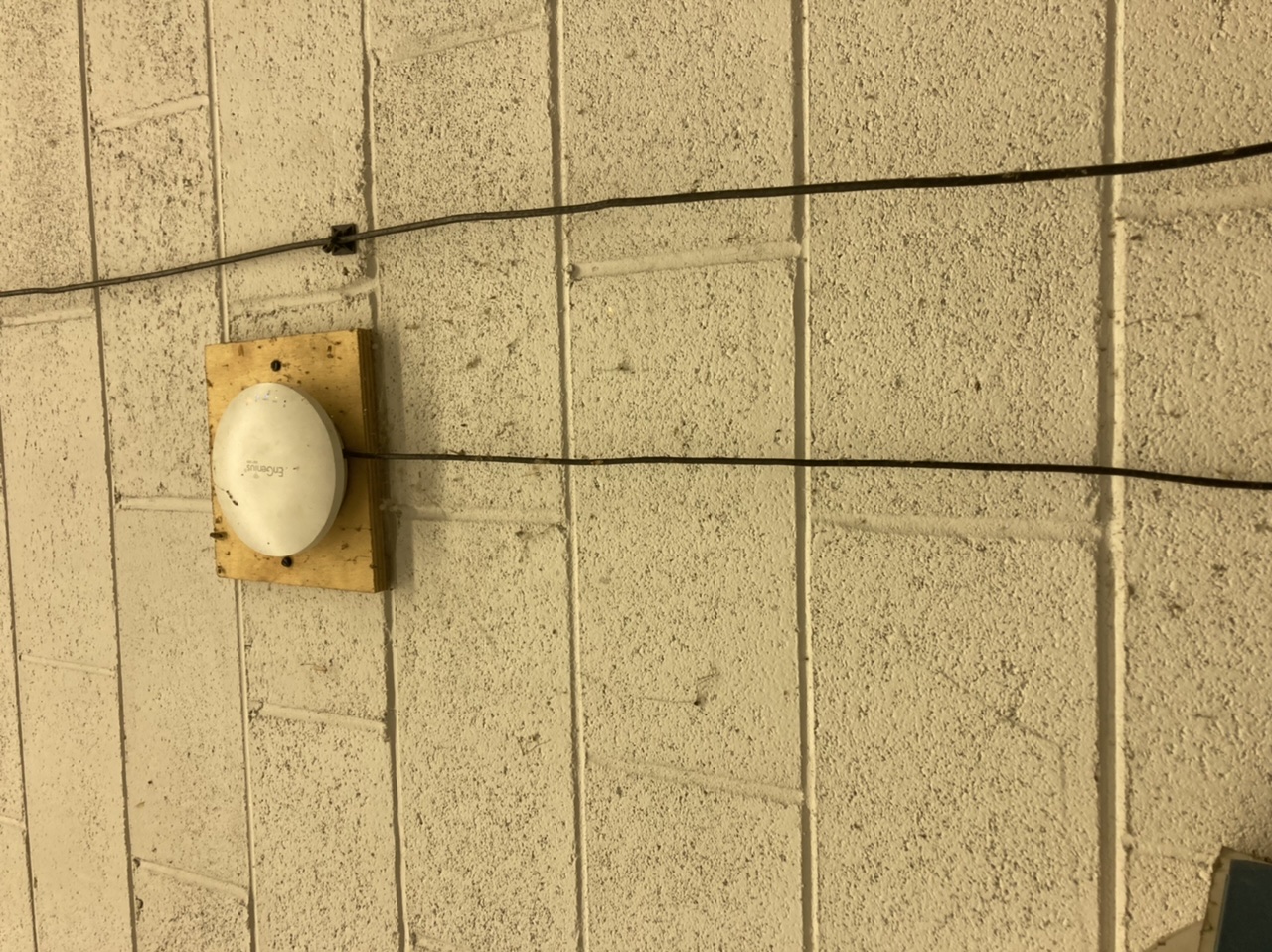

Trying to post pictures of my set up with pictures of the antennas and the control panel that helps run it
Red Bank View Drop Down
Joined: 18 Apr 2018
Location: Germanton NC
Points: 1051
Post Options Post Options   Thanks (0) Thanks(0)   Quote Red Bank Quote  Post ReplyReply Direct Link To This Post Posted: 16 Aug 2021 at 8:42pm
Wherever the signal terminates or passes through there is a control panel. The only exception is I have one antenna shooting the signal at my parents house and they don’t have an antenna to receive it so depending on distance you may not need the control panels. I have three networks in my house, my parents have their own network, there are two networks at the barn and two at the shop.
