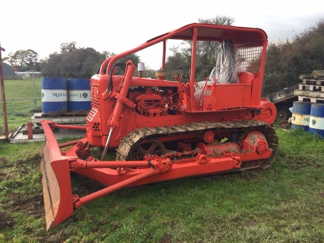

Hello all,
Tried searching for information on this and only found repair information, no basic mechanical/operator advice.
I've read the operator's manual, and it's fairly vague. Here's what I've got:
1962 AC HD6-B (15483)
The previous owner claims to have rebuilt the starter and the engine.
I purchased it this week ($4500, plus two batteries) and it was delivered this afternoon.
Due to the location it was being stored in (cramped backyard full of vehicles), I didn't have the opportunity to operate it myself before buying it. I took the owner's word for it that the steering clutches work. I forgot to ask about the brakes.
When it was loaded on the trailer, he joked with the hauler about it not having brakes to speak of.
After a very frustrating first operation, wherein I learned it goes forward and backward great, but only turns a very small amount when you first get going in reverse, I adjusted the clutch levers (per the manual - 3" of free travel) and attempted to adjust the brakes, with no real success. The band that holds the brakes against the drum(?) has 1/4"+ wiggle on either side. I imagine the brake pads have just disintegrated.
So here's the argument, and the place where you get to instruct a novice operator (first time I've ever used a bulldozer)
The previous owner claims the steering clutches are not worn out on account of two pieces of evidence:
1. The dozer moves in a straight line and, according to him, would not do so if the clutches were worn out. He says it would either only run one track or neither track.
2. The clutches DO actually work, but only under load. (it's true! They do! But cutting your blade into the ground is not a very efficient way to turn, imho)
I need plenty of advice:
1. Should the dozer be turning with the steering clutch lever pulled all the way back with no brake engaged? How long of a turn would that be? 20'? 50'?
2. If the clutches need attention, should I try a solvent bath before pulling them out and attempting a rebuild?
3. Do you need brakes to turn the tractor without the blade under load?
Any other advice is welcome. It's not a real argument and even if I need to rebuild the steering clutches, I still think I got a good deal on the dozer for the amount of care it has been given already.
(10' blade, has the winch. Starts right up every time. Could definitely use some love.)

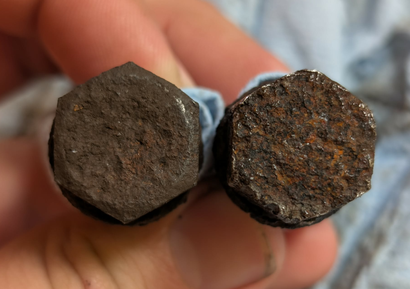

Earlier this week I removed the battery boxes. Or, more accurately, the squared battery rings. No top and bottoms rusted away.
Today I finally stole enough time to look into the grease pits. What a mess!
Left side: adjuster nut broken in half.
The support bolt (underneath the chassis) is sheared off 1/4" long. That's going to be a headache.
Right side: adjuster nut is frozen.
The pin that holds the band together? Also frozen.
Both clutch casings are just FULL (metaphorically full; They're more "caked") of grime. Having read some ideas on clean-out, since I'm not presently attempting to rehab my clutches, it seems the best course may be scraper, scooper, and a big old bottle of simple green.
My plan in a beat case scenario:
Remove the brake bands, clean them up, inspect them for wear (by which I mean send photos to y'all for review), check the components to get an order list together, and order parts.
While I wait for parts to come, clean out the housings and source gasket material (unless someone here knows where to look for that)

A note here...
The bolts towards the center have "smaller" heads than the outer bolts. I have tried a good handful of 3/4" wrenches and accessories on them and each one consistently fails. An 18mm crow's foot just fits on them, though 18mm box ends and sockets don't seem to want to. I've only managed to get one out so far (this has been a major setback) and it's so chewed up from the pipe wrench I ended up resorting to that it's hard to tell if some surface area has simply rusted away over time or...
In any case, it's clearly rust-pitted, perhaps more so than the outer bolt I'm comparing it to.
Looking at the image, they appear indistinguishable, but the same 3/4" wrench is tight on the left bolt and sloppy on the right.
I'm not sure what the best way forward is, besides the obvious "buy new grade 8 bolts to replace them" (RIP my wallet).
gemdozer View Drop Down
Points: 1131
Post Options Post Options   Thanks (0) Thanks(0)   Quote gemdozer Quote  Post ReplyReply Direct Link To This Post Posted: 06 Sep 2026 at 4:51pm
Maybe the exowner had repair the stering cluch and reused the better bolts but it could be 20 years ago and the bolts outside drum are 1 3\4 inch and the other side they are 1 inch .

Post Options Post Options   Thanks (0) Thanks(0)   Quote Stevie Quote  Post ReplyReply Direct Link To This Post Posted: 06 Sep 2026 at 6:09pm
Could be, I can't really say for sure.
I'm waiting for a parts cleaning bucket to show up and then I'll dunk them all in and see if any obvious pattern appears.
Pulled out 10 bolts from the center, 8 bolts from the outside. The clutch is free and moves side-to-side and pivots, but is still stuck on that lip and I'm losing daylight. May take one more crack at it before calling it quits for the day.
Wait wait wait...
I just re-read this.
On my machine, there were 10 bolts on the center side, which were 1 3/4" and what a pain to negotiate. I believe this is the clutch side.
On the outer side, the final drive side, also the brake drum, there were 8x 1" bolts. Are you saying those sides were reversed?
Points: 1131
Post Options Post Options   Thanks (0) Thanks(0)   Quote gemdozer Quote  Post ReplyReply Direct Link To This Post Posted: 07 Sep 2026 at 8:40am
Sorry I make a mistake for the side bolts
