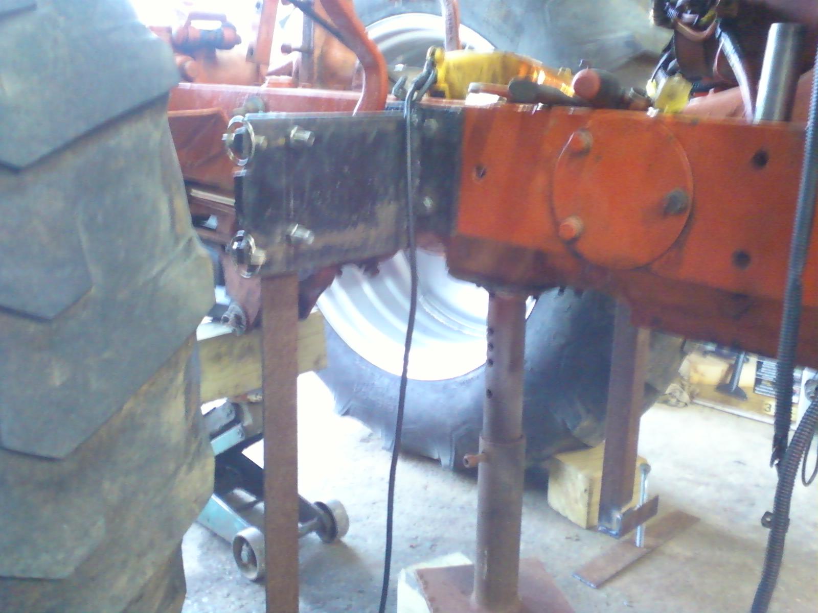

I supported the tractor on each side with two braces with adjusters to help stabilize the tractor.

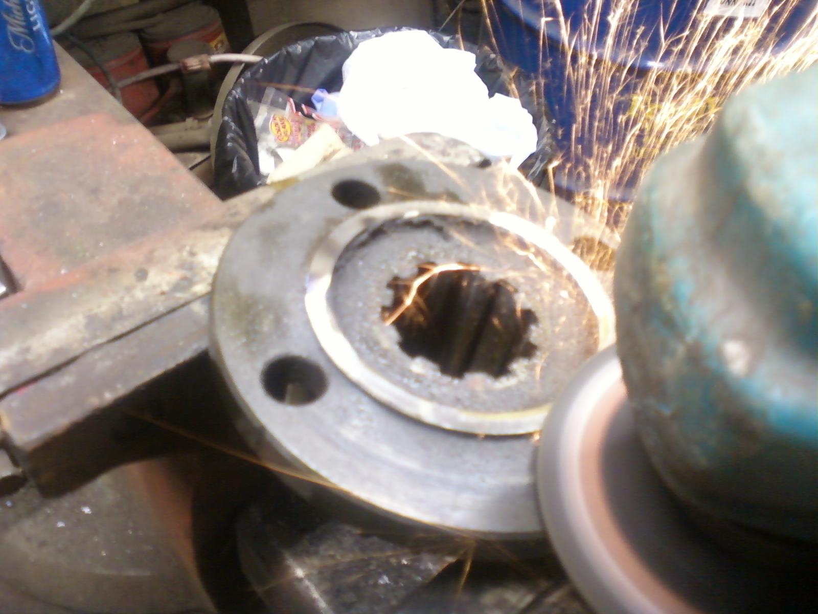

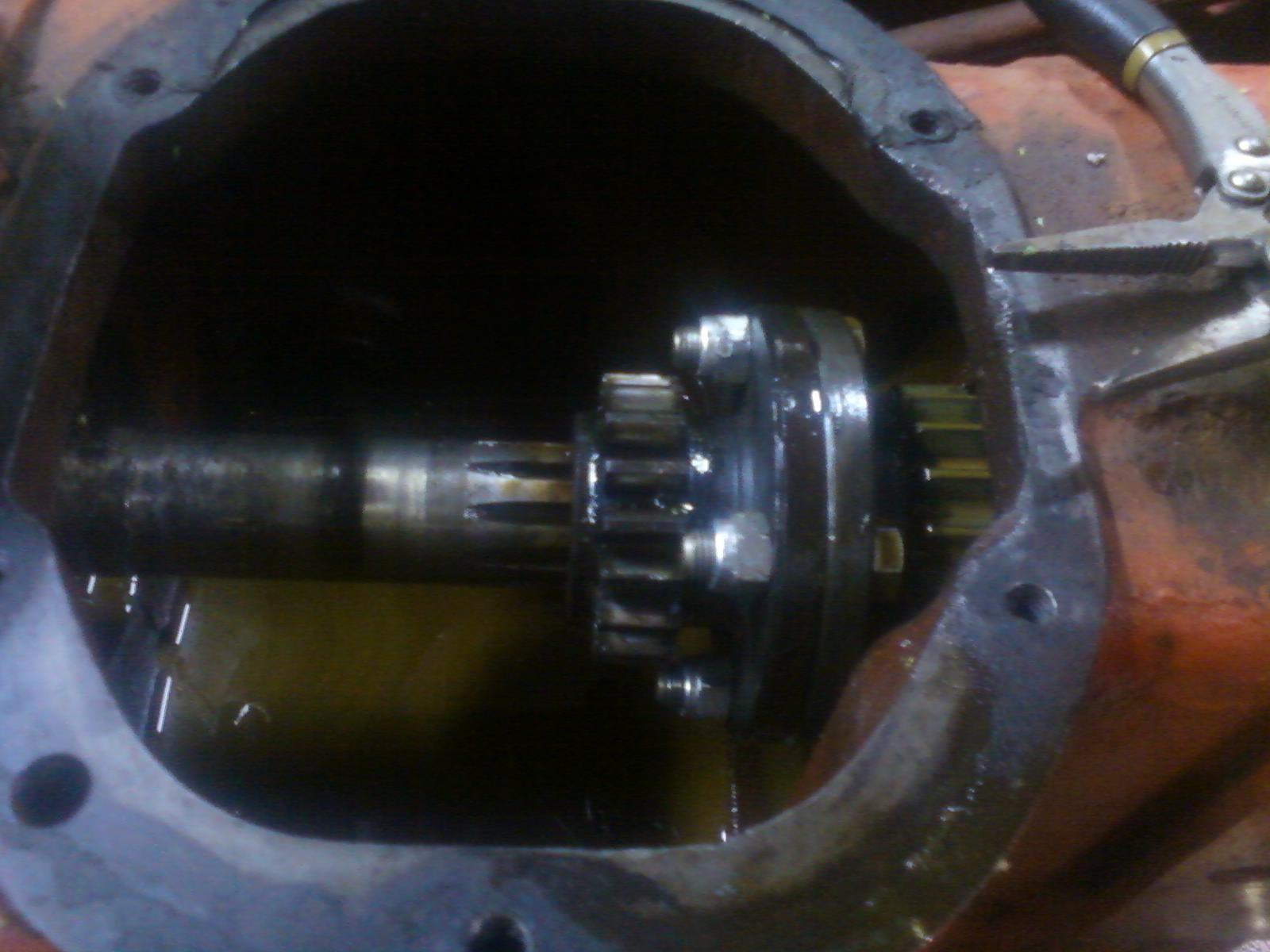

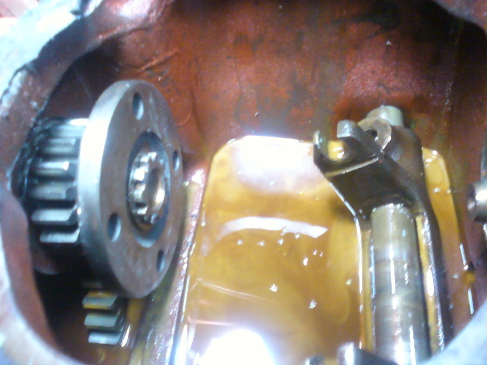

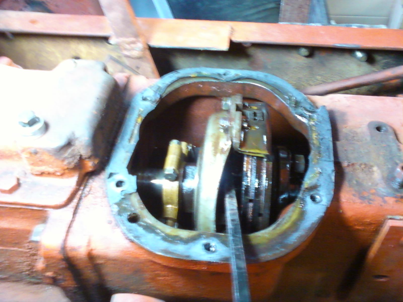

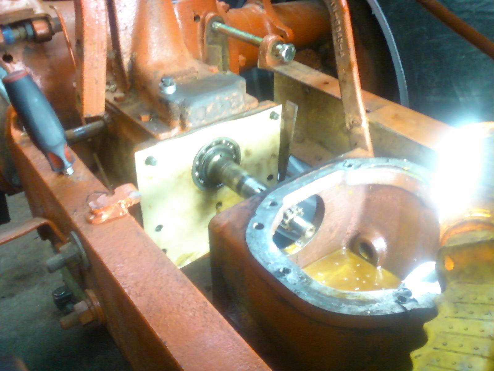

  This is no big deal. I built some simple stands to bolt to the frame to help stabilize the tractor when it was split. I used 10" bolts in the frame to allow for enough roll apart room but again keeping it stable. Remove the clutch pack, remove PTO gear, Grind off lip on both gears, put the gears in and roll back togather. Without removing the frame rail on the right side the only way to remove shifting fork and shaft is by cutting it off little at a time as it comes out. There was no suprizes, just as it was told on here. THANKS AGAIN EVERYONE!!!!!!

So you reused the pto gear?

thats the way to do one.   I just used all thread in the rear to roll the rear back enough to remove .

Yes, reuse the original, and get another gear to turn around and bolt together.
