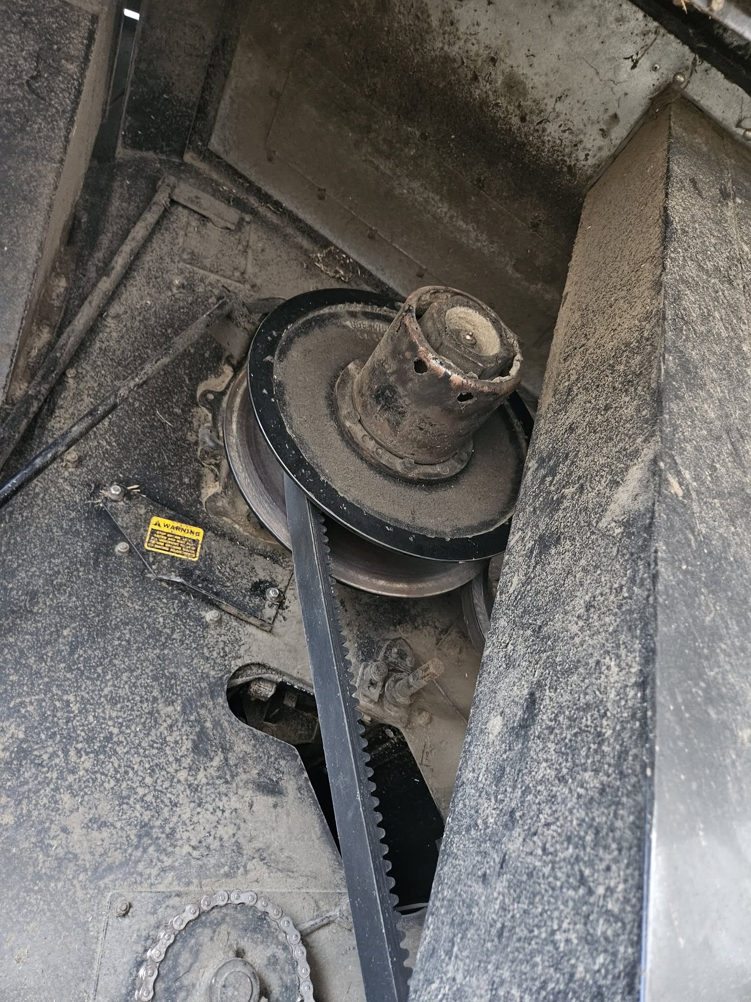

Is it possible to repair/rebuild the torque sensing hub on rotor drive sheave? Pretty confident i'm starting to have some issues with mine on my early R52. When running wheat i plugged the rotor but the engine never slowed down so i didn't realize what was happening until i burnt the belt off. Anytime i've plugged the rotor in the past it would pull the engine down and stall it unless i hit the separator switch. Put on a new belt and finished wheat but plugged it a few more times without pulling the engine down, would maintain cylinder speed fine until you started pushing it a little and the rotor would stall. Went from running 3-4mph down to 1.5mph.
It looked like the drive pulley might've been seeping a little so i did a full rebuild with new o-rings, guides, and pins and that all seems to be good now. Started beans this week and still acted the same. Cylinder speed around 750, get into a tough spot around 2.5mph and plugged the rotor without pulling the engine down. Noticed the rotor belt was a little loose as i unplugging the rotor as well. Talked to my local Gleaner dealers and they told me the hub isn't available anymore, and there isn't a parts breakdown from Agco so only option is a used one. I took their advice and pumped most of a tube of grease into the hub and ran the speed up and down, and after a few hours of cutting beans it seems to be working a lot better but still has me nervous.

That needs to be greased DAILY without fail. If it seems to be working now, keep greasing and cycling the speed up and down fully to spread the grease around internally. If you want to disassemble completely, there will be some areas on the cams that may need to be dressed up with a grinder or a file to make them smooooth again.

I've had several of those apart on N series. I think these are similar. Needed a press to take them apart. Big spring in there. If you make it through harvest, I would take it apart before next harvest for sure. Definitely replace the spring. I've seen the cams break before. Either replace them, or if they're not too bad, do like doc says. Also, there is a thrust bearing in there in between two thrust washers, check them over really well. And at the very least, clean em up good, best to replace them. Could be flat spots on the little rollers, or gouges in the thrust washers

Thought a lot of grease and cycling had it "fixed" but after plugging it twice today only running 2.2mph it for sure has an issue. Beans are pretty tough so not overly surprised.
So now my question is, how does it come off? Do i just need to take the tension off of the belt and then pull the nut off the end of the gearbox shaft? Will i need to take the bolts off the sheave hub or will that stay on?

Please don't stone me for misinformation, as it's been over 26 years since I've done one. But, if memory serves me correctly, take the ring of bolts off of the outer sheave half on the main shaft (remove the hydraulic rotary coupler first) to get the belt basically off. Then take the outer sheave off the torque sensing hub up on the gearbox, and I believe that it can be wiggled past the elevator and off and out of the way. Now, the inner half of the sheave, I am pretty sure can be removed by taking out a ring of bolts also, which will be inside, so remove the big nut and pull the hub out far enough to make removing the ring of bolts easier. Then the sheave half should be able to get tapped off and stay hanging on the gearbox input shaft, and torque sensing hub should come off and clear the elevator. This is all a little sketchy in my memory banks, but I think that's how it all goes. If I was there looking at it, other things would probably come back to me on it.

Been 30 years for me. Get the belt off. Start taking it apart one bolt at a time. The outer sheave slides off the shaft at an angle to clear the elevator.  It will come apart !!! Just a lot of wrenching to clear the elevator.   EDIT:   I made a tool/plate with two short legs that after removing the big shaft nut, I would then thread on an extension to the gearbox shaft that had a six inch long length 3/4" of redi-bolt welded to it for my tool plate to slide over. I could them compress the spring can, remove the snap ring and disassemble the torque sensor one piece at a time to direct my efforts towards the area that needed attention. I don't have that tool anymore and only used it twice. But this saw to it I didn't have to tear everything apart. The belt still needs to be moved up and out of the upper sheaves so it isn't trying to spread the sheaves apart.

Hopefully this problem is solved now, and it appears Agco isn't lying when they say this spring hub isn't serviceable. Took the nut off the gearbox shaft and the whole assembly just slides off, and i see no way to disassemble or service it. To me it looks like they compressed the whole assembly together then either welded the can around it or rolled the ends over to hold it all together.
Appears what happened was the 3 pins that stick out of the bottom of the cam that engage the outer sheave had sheared off so the sheave was spinning on the hub. It scored both hubs and had worn a decent bit off the outer hub as well. Luckily i found a guy an hour away parting out a early R52 and he sold me entire upper sheave assembly for $400. Did a precise test of the spring tension by standing on the spring can's, my original one compressed about 3/4" and the new one maybe 1/8", so fingers crossed it should be better.
