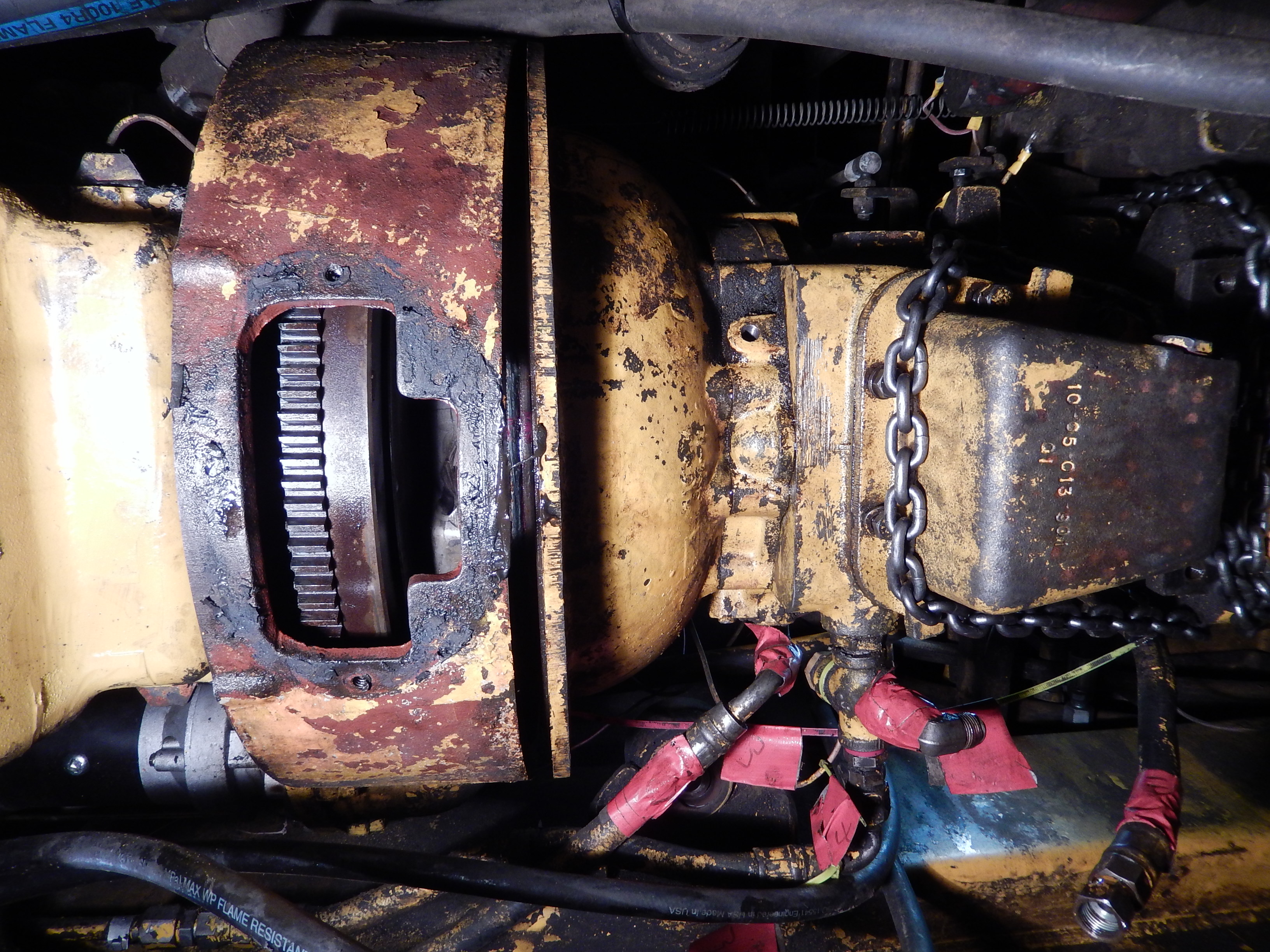

Posted By: Dgrader
Date Posted: 16 Jun 2015 at 7:51pm
The dipstick your talkin about is for the torque converter and it takes atf fluid. I don't know the quantity as I've never changed it and couldn't find it in the service book. The plug to check the transmission is on the right side if your lookin at it from the back of the tractor. Ours has 90 wt. in it. Sounds like your problem is in the torque converter. I just changed the transmission in ours and it's not a bad job.
Ya cain't fix stupid.
Posted By: Eric B
Date Posted: 17 Jun 2015 at 12:44am
If the oil that is leaking is from the fwd rev transmission it's very likely from the oil pump that is driven by the converter. If the flex plate that the converter is mounted to is cracked then the converter starts to wobble...then the converter neck that propels the fwd rev trans pump gets damaged, the seal starts leaking and once the pump is no longer driven you have no pressure and no power to the wheels. You described a noise in the driveline...this would be my first suspicion.

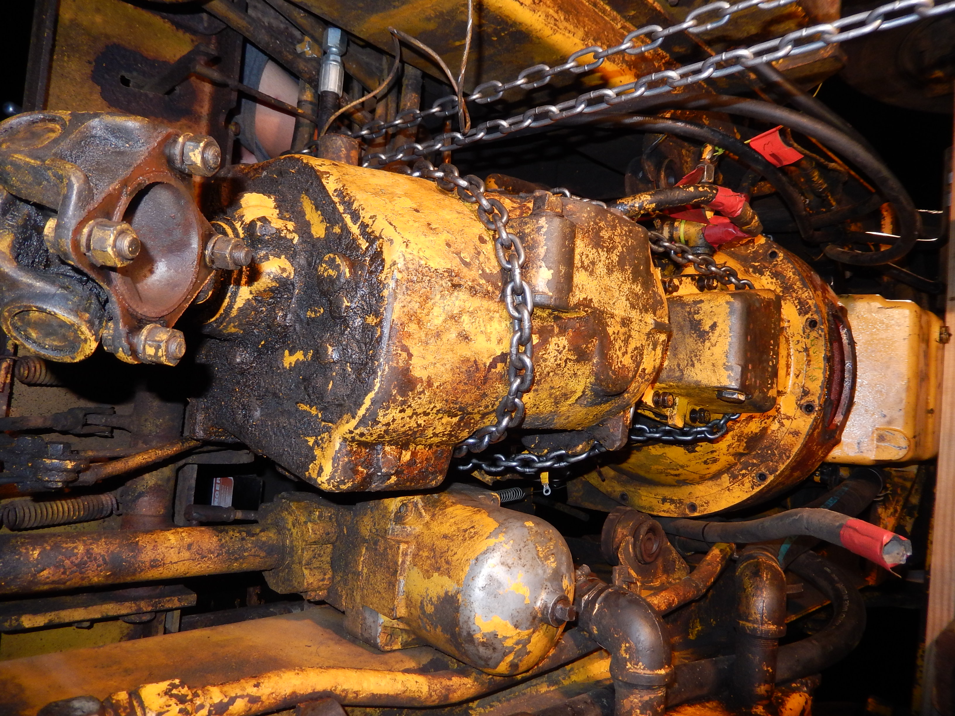

Posted By: FarmerJoeVT
Date Posted: 07 Jul 2015 at 2:29pm
When I push the pedal the valve in the trans moves freely in and out.

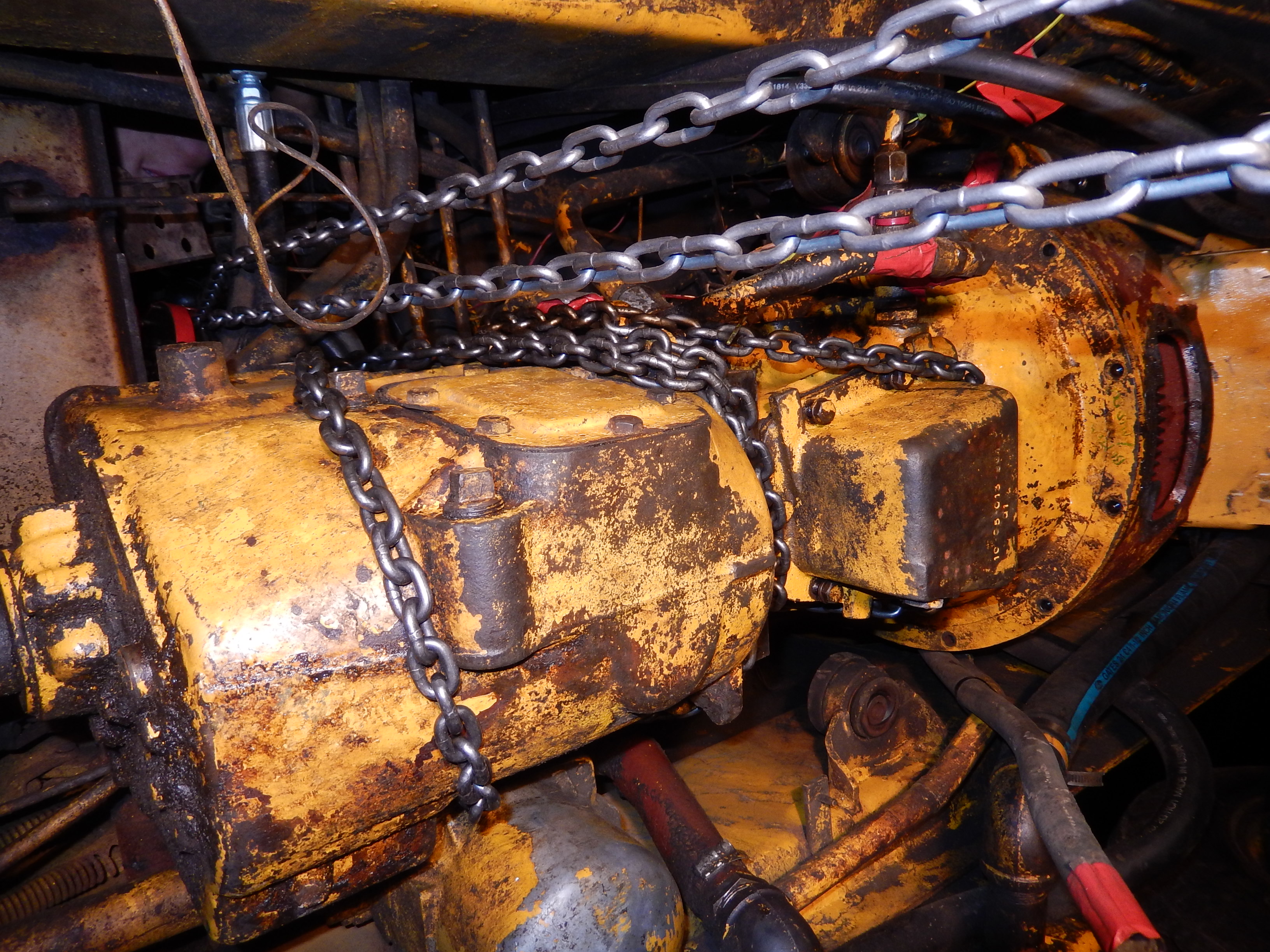

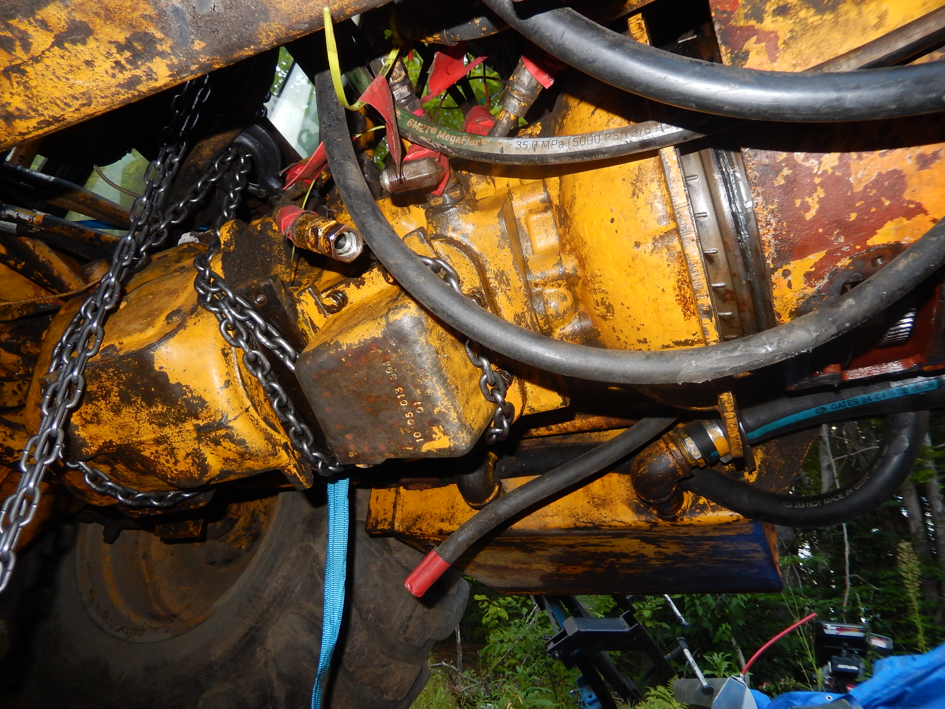

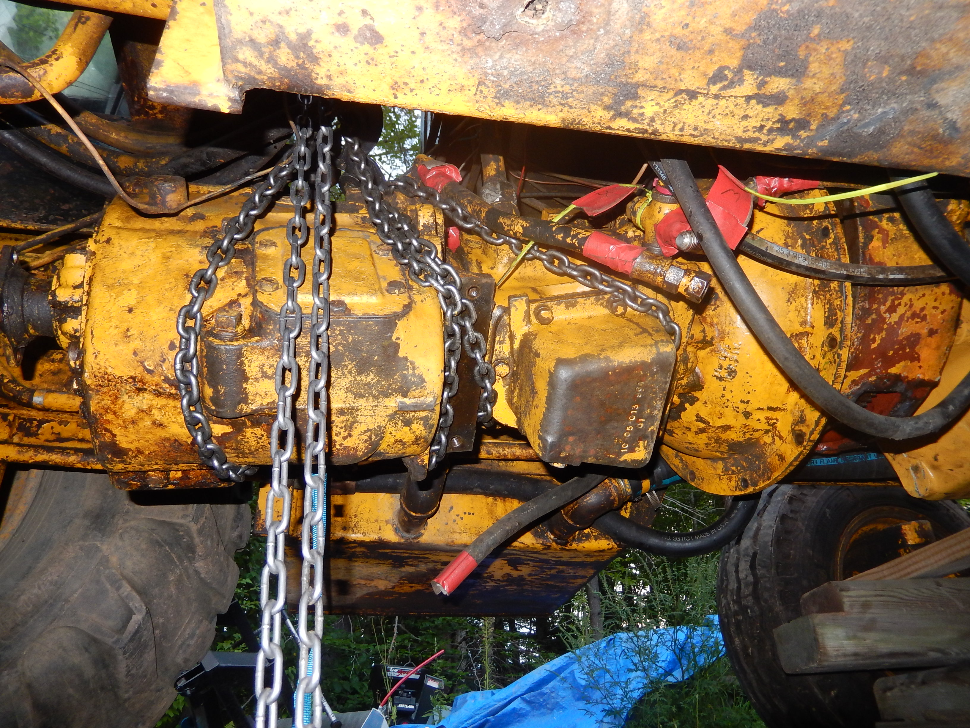

Posted By: Eric B
Date Posted: 08 Jul 2015 at 1:25am
It's not hard to replace the pump once you can get at it. You have to remove both transmissions to access the pump. There may not be much wrong with the pump itself but as mentioned earlier in this thread if the flex plate is broken and the converter starts wobbling the drive set up for the pump and seal get ruined. If the pump doesn't turn there is 0 pressure. Once you pull it apart you'll see how it's supposed to work. You were talking about oil leaking...it's likely the oil pump seal around the converter neck is leaking. Last time when I was buying a new pump ordering it as a kit (pump, seal, gasket and bolts) was the best deal. However, don't order parts until you have it apart and you see what you need.

Posted By: Eric B
Date Posted: 08 Jul 2015 at 9:18pm
Well Brian, it's not fun to have a machine that won't move...I have been there myself. Unfortunately it was no easy fix. I think I have given you all the advice I have. Running out of fuel would have no influence on the tranny. The oil leak you describe is right below the converter, if the seal or the oil pump leak that's where the oil comes down. The starter failing can make trouble in the converter housing if a piece let go from the starter itself. On one machine I had, the starter drive disintegrated and wedged itself stuck between the ring gear and the engine block...it still boils down to having to disassemble and investigate where the problem originates. It may still be an idea for you to reread this whole thread and ponder everyone's input. I wish you all the best on your repair. Be sure to tell us what you find and how you fixed it.  Eric
Posted By: Eric B
Date Posted: 08 Jul 2015 at 9:35pm
By the way Brian, the link you have for an oil pump looks to be an oil pump for the engine (notice it says engine parts at the top). The reason it fits your machine and several others is the Perkins engine. You (likely) need a pump for the forward reverser transmission. Here is the place and price from last year when I bought one...most likely the same one in your machine. You could always contact them for particulars. As I said previously however, don't order any parts 'til you know what you need.

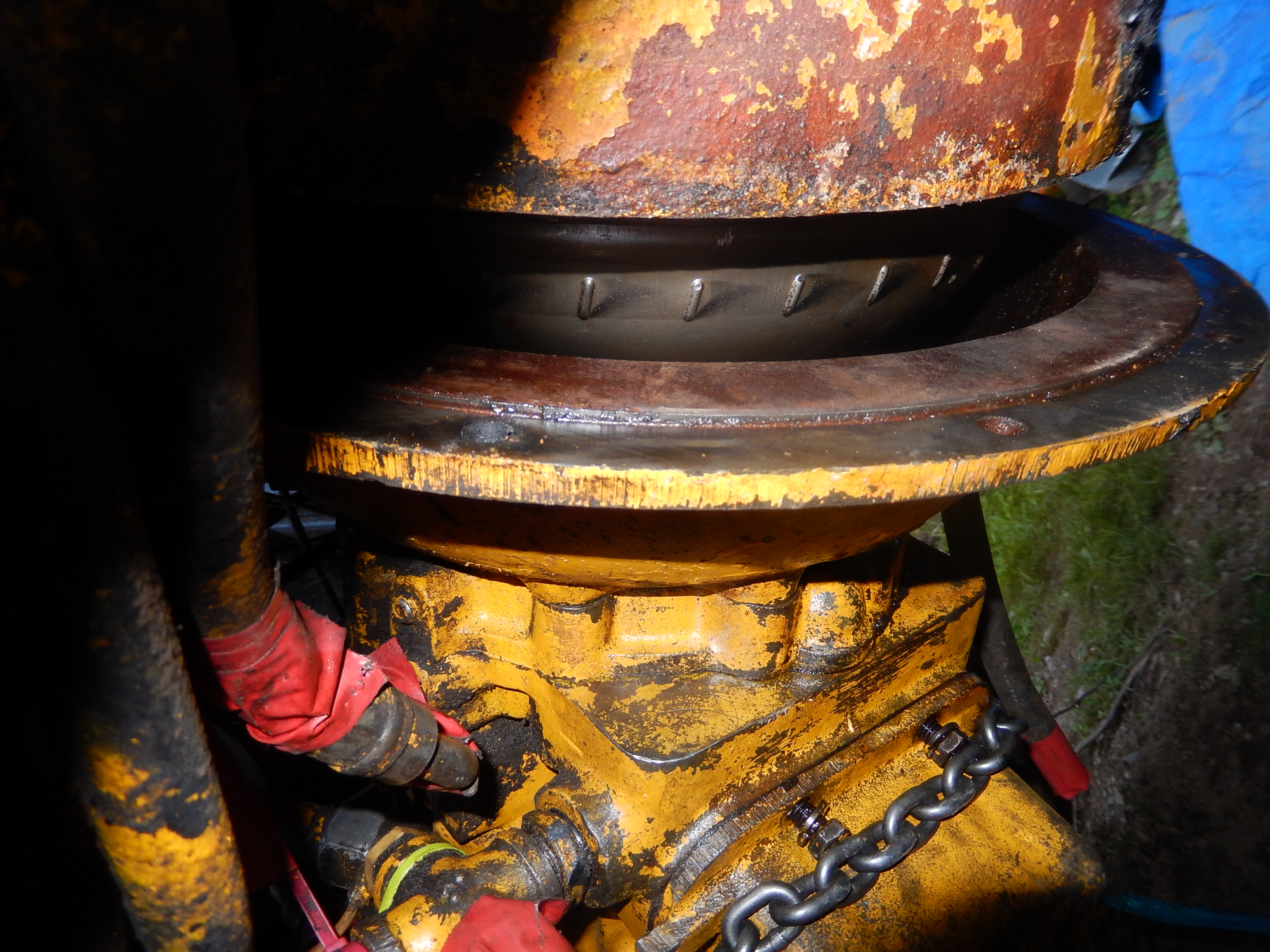

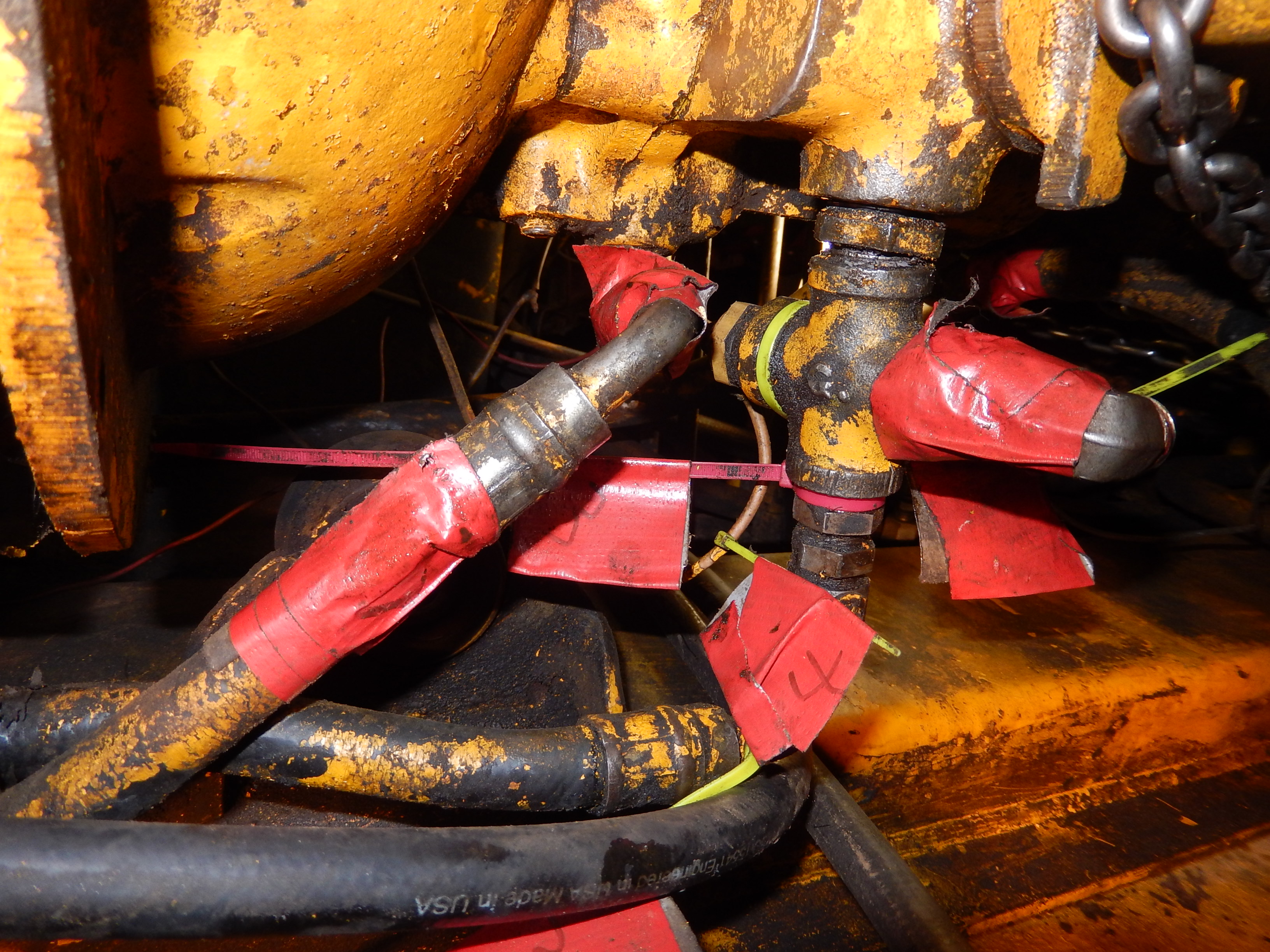

Date Posted: 09 Jul 2015 at 7:58am
Thank you Eric. I sincerely value the support you and everyone has given. I also, appreciate the clarificatoin on the part needed to repair this issue. Thou I had hoped it would be a quick easy fix, sometimes it just happens not to be that wat and thats ok. Do you have any advice on the best way to remove the bad pump for the forward reverser transmission and install a new one?
Thanks you in advance.
Brian

Posted By: JayIN
Date Posted: 09 Jul 2015 at 11:42am
you had starter problems. you have pump problems. the flexplate is the common denominator, it drives the pump. If it is cracked it will ruin the starter and waller out the pump till it has no pressure. Been there, done that on a Turbo Hydro 400 on an old Jeep pickup. Starter would not act right and then no transmission pressure. Flex plate was nearly broken clear into. check that. keep us posted.
Posted By: Eric B
Date Posted: 09 Jul 2015 at 12:30pm
I liked dealing with Reliableaftermarketparts...you should try to confirm on the phone that this fits your 715, personally I'm sure it's the right one. Remember DON NOT ORDER ANY PARTS BEFORE  YOU GET IT APART! You have to raise the machine with enough clearance to get the transmissions out from under the machine. You will probably find all the instructions in your 715 Manual. The first time this happened to my machine THE OIL PUMP WAS OK, I DID NOT NEED TO REPLACE IT! But the converter neck needed repair because the flex plate was broken and needed to be replaced. A new seal was put in the pump but the pump itself was perfectly good. The pump is mounted right at the front of the fwd/rev trans, it's the first thing you see once you pull the tranny away from the engine. You need to be working on concrete and be using a really good transmission jack. My mechanic used a forklift with side shift to move the trannies away from the engine and then lowered them down. You may need to hire help to do this work, it is not an easy procedure if you haven't done it before.
Date Posted: 09 Jul 2015 at 3:55pm
Just to help describe where the fluid is leaking out of I found this diagram online and have marked with an arrow to better identify the source of the leak.
Thank you for all the collective knowledge and helpful steps. (Eric, Carl, Coke, etc. - your awesome)
Date Posted: 03 Aug 2015 at 2:59pm
Update: received the 2 ton hoist in the mail, attached it to a logging chain strung up and around the cab and ran through the floor around the transmission. (as suggested by a genius on this site, if I hadn't I'd still be trying to figure out that step) :)
Next: figuring out how and what order to break it all down and safely lower it to the ground and not on my face, figure out whats broken, order replacement parts from ?, install parts, and lift / secure it back on the tractor.
Posted By: Dgrader
Date Posted: 03 Aug 2015 at 5:16pm
That hoist should handle the whole piece. Take out driveshaft and unbolt from engine and let her down.

Date Posted: 05 Aug 2015 at 10:20am
I started labeling and prepping everything last night. I removed the c-clips from the u-joint on the driveshaft and the one end cap that has bearings in it. But I am unable to slide it apart or remove the rod. Is a trick or something I am missing.
Any and all help is greatly appreciated.
Posted By: Eric B
Date Posted: 05 Aug 2015 at 12:15pm
You see the four bolts to the right in the picture, they hold the flange in place. Remove the bolts and use a bar to push the shaft back just slightly. Taking the U-joints apart is the hard way...you can easily lose some of the needle bearings in there too.
Date Posted: 05 Aug 2015 at 12:56pm
Thanks Eric, I will give that a try tonight. :)
Date Posted: 05 Aug 2015 at 5:31pm
Update: we have dropped the driveshaft, removed the bell housing inspection cover, and flywheel bolts. Whats next? Please help.
https://youtu.be/fJMAh9L4CgA - redoing this video now for better quality.
Date Posted: 05 Aug 2015 at 5:38pm
Heres a better quality video of what we have accomplished thus far. Need guidance on what to do next, to lower the transmission out and where to unbolt it from.
Link to video: https://youtu.be/6cDHTBGd0vI
Posted By: Eric B
Date Posted: 05 Aug 2015 at 7:25pm
If you look at the back of the bell housing (round circumference with bolts all around) all these bolts have to be removed, don't take out any bolts right a the back of the oil pan. I'm not sure which mounting bars are on the 715, side or bottom? Remove these mounts leaving enough room to lower the trannies. Hopefully you have removed the cooler lines and all linkages related to both trannies. You must make sure to have chains hooked one to each end so it doesn't tip when it's loose. This is very important as someone working underneath could be severely injured. Separate (pull back) the trans at the bell housing making sure the torque converter stays with the transmission but be careful because if the trannies lean forward the converter can fall off. As soon as there is room tie a wire across the front of the trans. to be sure the converter does not fall off unexpectedly. You can remove it nicely when you have room...oil will come out of the centre, lay it down and cover the hole with a clean rag. I'm sure you can see when everything is ready to be lowered to the ground. Once you get that far I would celebrate like maybe go to DQ or...?? LOL
Date Posted: 05 Aug 2015 at 11:43pm
Unbolted all the bolts around the bell housing, unmounted the support bracing, detached the selector lever for forward/reverse, and one hose of many. But not sure what is still holding her in place. Attaching pictures to show everyone the progress, hitting the hay after several hours of work.
Video: https://youtu.be/fi1gTYqiFgY
Posted By: Eric B
Date Posted: 06 Aug 2015 at 1:12am
You have made a lot of progress!Clap Be sure to support the back end of the engine (under the bellhousing is good) before everything is separated. From your video it looks like the trannies are ready to drop down at any moment. You may need to use a suitable pry bar at the bellhousing . The next thing is more important at installation than at removal but to install a couple of studs into the bolt holes of the bellhousing (just cut the heads off two bolts and cut screw slots in the ends so you can thread them in and out using a screw driver) one on each side for the purpose of maintaining alignment of the components (as you are separating them or putting them back together). Next time we hear from you you've probably got it dislodged and all the way down.
Date Posted: 06 Aug 2015 at 5:01am
[TUBE]http://youtu.be/fi1gTYqiFgY[/TUBE]
Looks like its hung at the top of the bell housing.  try moving the chain foreward, to get better balance...
Date Posted: 06 Aug 2015 at 6:47pm
Need some help trying to figure out how to get the bell housing to break free so we can lower the transmission. Please help. :)
http://youtu.be/or_598D58eE" rel="nofollow - http://youtu.be/or_598D58eE
Posted By: Eric B
Date Posted: 06 Aug 2015 at 11:45pm
I believe you said earlier that you removed all the bolts holding the converter to the flex plate? If the converter is freed from the flex plate and it is still in line with the shafts coming out of the front of the fwd/rev trans, you can keep it tucked in as close as possible to the tranny to clear space needed to drop it. Judging by the pictures and the video I'm concerned that the converter is partially away from the shafts and with dropping the weight down you could be doing damage to those shafts? If the converter is half way it's blocking the lowering movement. Given that you have enough room at the driveshaft end you should just keep moving it back. You may have enough resistance from the chains that backward movement is difficult. Just so you understand...even if you did not remove any bolts from the converter to the flex plate it would still slip apart from the front of the fwd/rev trans. as the converter simply slips over splined shafts. This does require a number of inches of movement away from the engine bell housing in order to come clear. Some mechanics remove the 4 speed trans. first to give more maneuvering room, others drop them still together.
Posted By: Eric B
Date Posted: 07 Aug 2015 at 11:48am
Brian: I thought back to some of the pictures you posted...in one I could still see the driveshaft. Have you disconnected the driveshaft from the differential as well? Unless you get it totally out of the way there won't be enough room to pull back the trannies. They need to come back in straight alignment with the engine, this is an absolute must upon installation procedure especially.
Date Posted: 07 Aug 2015 at 1:00pm
The drive shaft is completely out of the way. We have the section a few inches out of the bell housing, but it is not enough to break her free. So we are trying to figure out a way to pull her even more out toward the back, so we can drop it down. Ill take some more pictures so you can all see what we are dealing with.
Thanks for all the help everyone. :)
Date Posted: 07 Aug 2015 at 1:05pm
Heres what I am seeing:
https://picasaweb.google.com/113281734833083132500/BackhoePictures8715?authuser=0&authkey=Gv1sRgCImU3fGv3OLXMA&feat=directlink" rel="nofollow - https://picasaweb.google.com/113281734833083132500/BackhoePictures8715?authuser=0&authkey=Gv1sRgCImU3fGv3OLXMA&feat=directlink
Posted By: Eric B
Date Posted: 07 Aug 2015 at 3:53pm
Good pictures!! That makes it much easier to see what's happening. I can see that your flex plate is caught and stuck in the bottom of the bell housing...you're going to need to lift your trannies up enough to be more perfectly in line with the engine before you can make progress, hope you haven't forgot one bolt that is hanging onto the converter?. Be sure to check that nothing from the frame, pipes, hoses, chains etc is interfering anywhere with movement toward the back. The flex plate looks quite warped at this point, if it wasn't previously broken it may have to be replaced before re-assembly. Keep at it!! You'll eventually get there.
Date Posted: 07 Aug 2015 at 5:30pm
Yup, I picked up on the flex plate tension, too.  Looks like its in a bind, and holding up the works...
Date Posted: 10 Aug 2015 at 8:45am
Just a quick update: We had to drive one of my brothers back to Ohio, ahead of him starting his senior year of high school over the weekend. Arrived back early this morning (5:30am), I am now up and going. With nothing planned today other than removing that tranny. :) So I will try and level her out, aligning the bell housing and flex while continuing to move it toward the rear. I will post updates often and with any luck, she will be out and we can begin figuring out what parts need to get ordered. :)
Thanks again for everything you guys.
Very respectfully,
Brian
Date Posted: 10 Aug 2015 at 10:39am
Still cant get it out, going to tractor supply or Lowes to get a come-long. Will update as soon as I can. Its still hung up on the flex plate. :(
Date Posted: 10 Aug 2015 at 3:07pm
Tried a come-along and to give it a small tug with the truck and nothing. We verify the there are no remain bolts, that all hoses are not caught, and that the flexplate is not hung up and still no dice. Any is greatly appreciated.
Links to pictures, showing what we are seeing:
https://picasaweb.google.com/113281734833083132500/105NIKON?authuser=0&authkey=Gv1sRgCOeKr-Wwp523Gg&feat=directlink%20" rel="nofollow - https://picasaweb.google.com/113281734833083132500/105NIKON?authuser=0&authkey=Gv1sRgCOeKr-Wwp523Gg&feat=directlink
Date Posted: 10 Aug 2015 at 8:37pm
Update: we got it out. :) (Pain in the a$$, but its out)
See pictures: (same as earlier only with photos added to album)
https://picasaweb.google.com/113281734833083132500/105NIKON?authuser=0&authkey=Gv1sRgCOeKr-Wwp523Gg&feat=directlink" rel="nofollow - https://picasaweb.google.com/113281734833083132500/105NIKON?authuser=0&authkey=Gv1sRgCOeKr-Wwp523Gg&feat=directlink
Anyone have any suggestions to what order to break this down to isolate the issue? Or is it best to just order a new pump, flexplate (for sure), and torque convertor?
Very respectfully,
Brian
Posted By: Eric B
Date Posted: 10 Aug 2015 at 11:03pm
Congratulations...you got it!! I think I have said most everything there is to say in terms of help to this point. As for the internal repairs I can only recommend that you find a reputable shop (or mechanic) that know their way around transmissions like this. When you go to put the machine back together you don't want to have any doubts that all components are in working order. Looks like your flex plate was OK until it got warped trying to take the trannies out. Pump drive looks OK. You don't want to settle for guess work when you are going to all this trouble. If anyone on this site with all the know-how leads you through the process that's fine, otherwise you need to consult a place in person to get all the help you need. I know I wouldn't disassemble the forward reverser myself. Even a forklift repair shop may know all you need help with. It's so so important that you deal with people you can trust and are reasonable at the same time.
