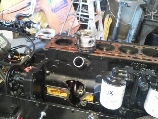

Posted By: Bob C IL
Date Posted: 19 Apr 2014 at 11:30am
MINE AT 60 PSI
Posted By: 200 allis
Date Posted: 19 Apr 2014 at 1:01pm
Bob what turbo u running
Posted By: Bob C IL
Date Posted: 19 Apr 2014 at 1:26pm
At that time a hx50 now a s300
Date Posted: 19 Apr 2014 at 1:57pm
I'm going to run hx35 u made me nervous with pic
Posted By: O.P.S. Heads
Date Posted: 19 Apr 2014 at 10:18pm
If your connecting rods are properly hardened you will not have any issues no matter what turbo you choose or what the boost is. Be sure to use new rod bolts when you assemble things. If you run the HX35 with the 12cm exhaust housing and the gate tied shut you will see 45 - 55 lbs. of boost. That should be just fine with your hardened rods.
Bob, you had the HX35 on yours when the connecting rod failed if I remember correctly.
