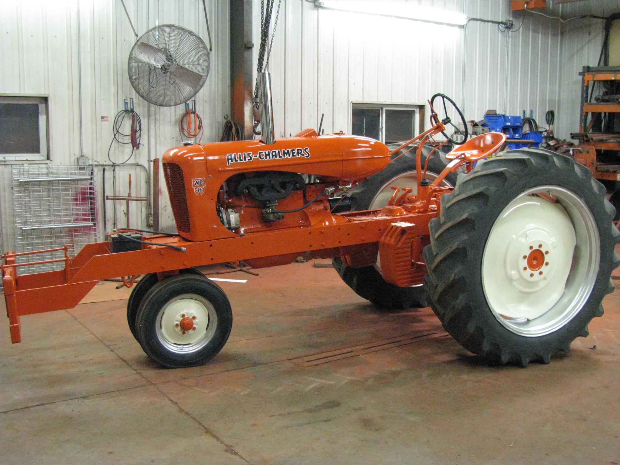

Here's a pic of my WD-45 with some free 15.5X38 tires I scored, I cut the 9 bolt pattern out and welded an 8 bolt repair center in, the regular 5-15 fronts.
"see what happens when you have no practical experience doing something...... you end up playing with calculators and looking stupid on the internet"
what were these rims originally on?

those rear wheels were some light pressed steel 9 bolt wheels that have been on the farm here forever used as duals on a small tractor for seeding.  The centers were torn up, and I had bought a real nice set on an auction so I used the junky set for the Allis and moved the centers for a 60" tread spaceing when put on the WD-45 and welded the 8 bolt repair pattern in.  They are from a John Deere, but I don't know what.  A trip to the sandblaster and the tire shop, some new tubes, switching 2 pairs of tires and a pile of my time.
I never weighed the fronts, but I know the narrow front I took out of the WD-45 is HEAVY.  That tractor pictured weighs about 3800# with no weights and a 190# driver on it.  Nothing's stripped off, and just a little added weight for the front and center weight brackets.  We don't have much around here for light classes, most places start at 4500# and up, once in a while there's a 4000#.  The tracks are hard enough that you need to add the weight to the front anyway.
