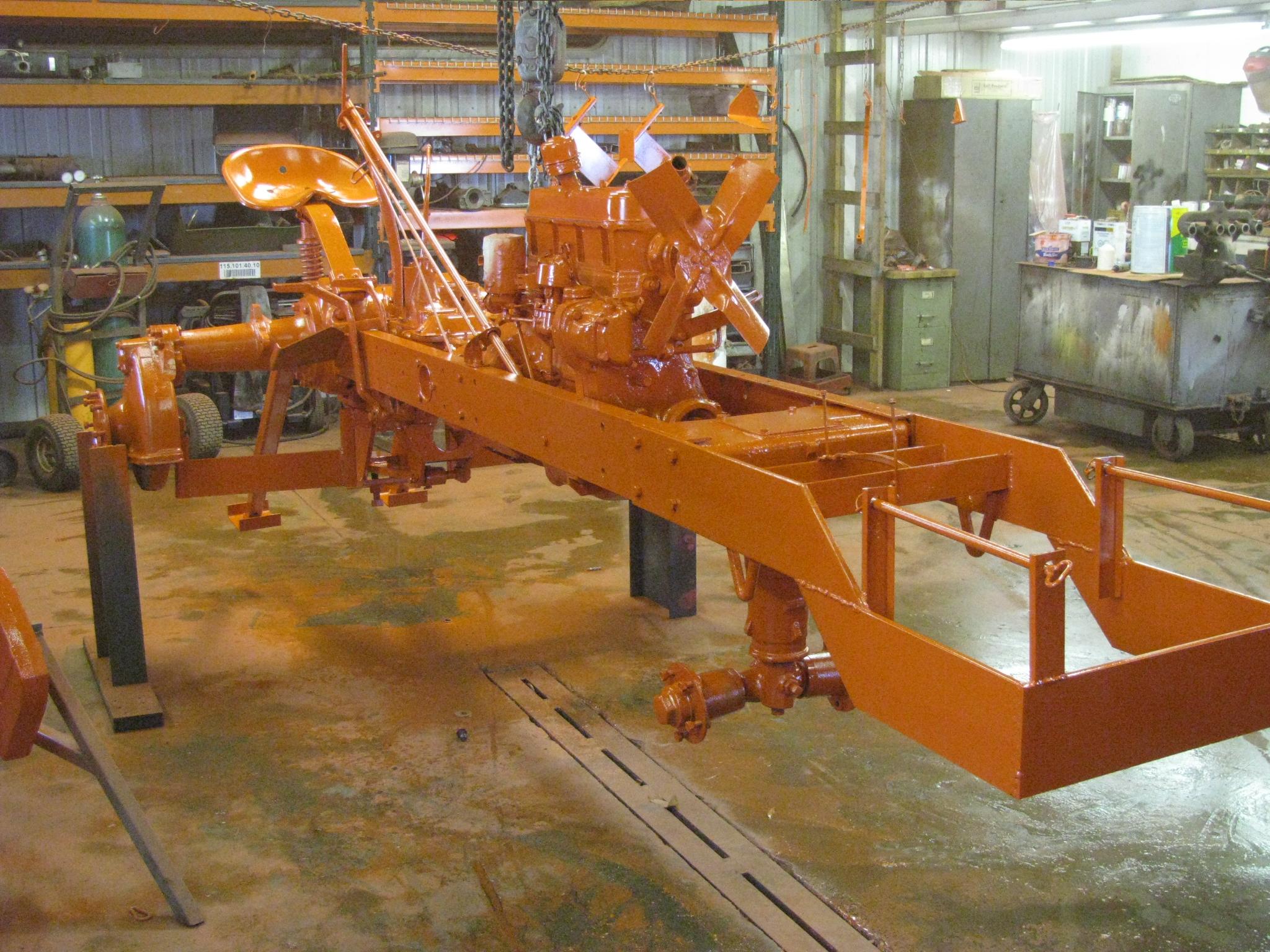

Posted By: Ken(MI)
Date Posted: 17 Dec 2012 at 2:28pm
Not positive that this is the correct coupling or not, but I made some like this to eliminate the hand clutch, easy, simple and effective, no bolts, no cobble job, and no slip.
