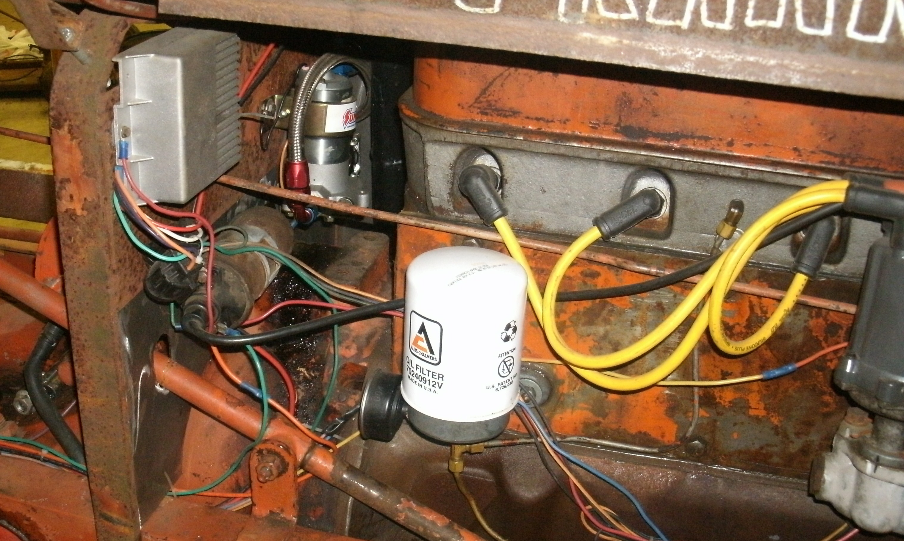

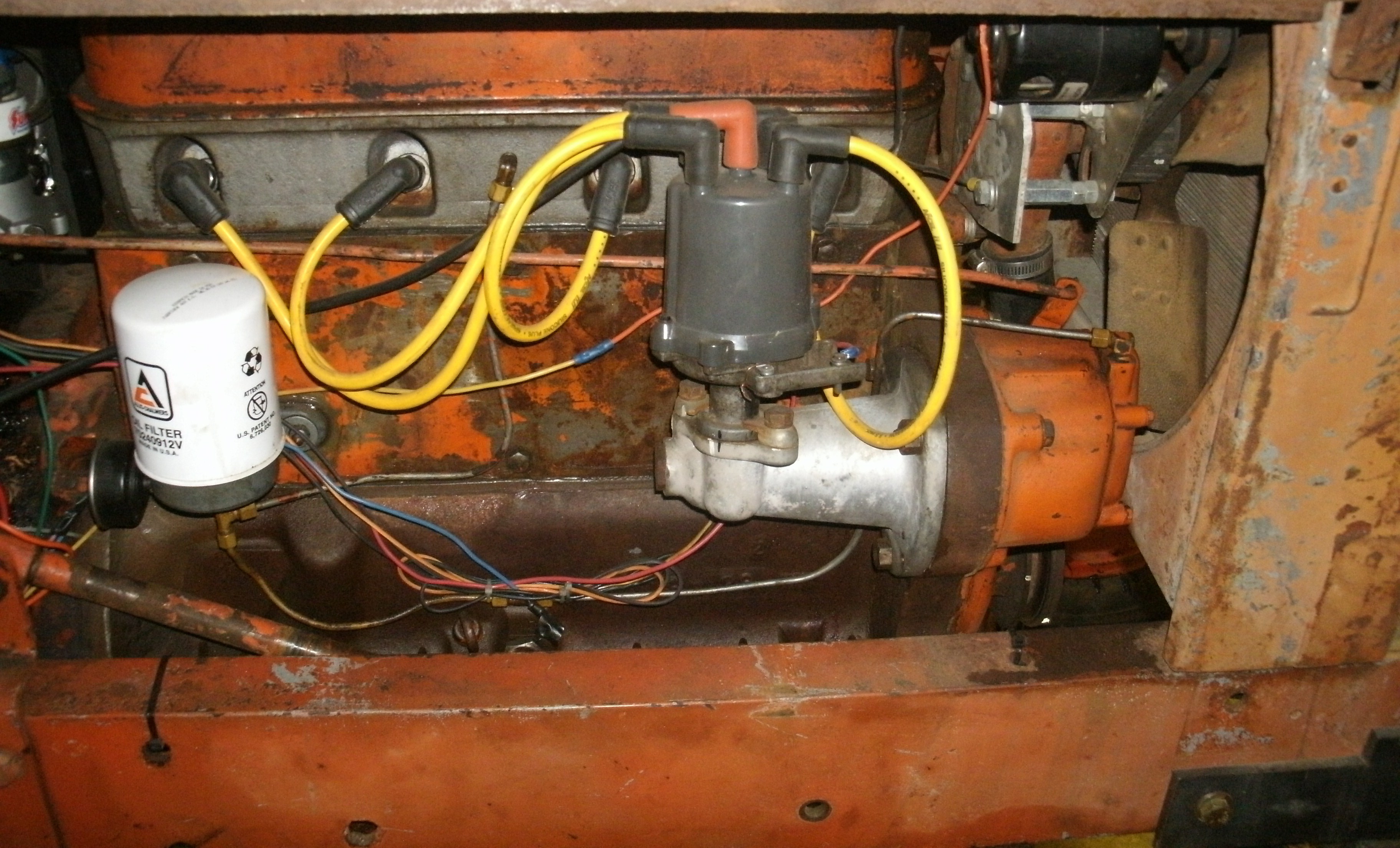

Heres some pics of the ignition system we are running, distributor is from a 2.3 litre ford engine commonly used in rangers and mustangs. Pretty simple turned outer housing down in my old lathe then shortened shaft slid gear on and drilled new hole for the roll pin. Then used some wiring from donor vehicle and the ford box. A msd box could just have easily been installed, but we had the ford one. Did away with the vaccum advance and installed light springs on mechanical advance so they would open up sooner. Waaaaayy better than the fairbanks morse mag that was on there. Wc block, 45 crank, flat top pistons, bigger valves in the head.

Funny you posted that . Was looking at my old engine that was in my mini mod circle track car which was 2.3 . Guess you have that figured out. Nice post d21 puller. Thanks for pic I may contact you for specs . :-)

D21 its the same to make the hei work. Just dont have to have the box unless your wanting more spark.   The allis 226 flat cylinder head and flat crank is the automotive rage for 2012/13 but some try to reinvent it to the 80s instead of things that need to be upgraded to the, 980s like ignitions.

Those parts were laying around the shed, really have nothing invested other than time. The problem i had with pertronix was after a while the pick-up module would quit after it got hot. Then there you are on the phone ordering one and waiting for the man in a brown truck to drop it off. Ford parts are everywhere!!!!!!! Would have used HEI and tried one but the cap will not fit with the aluminum wd-45 or d-17 style distributor housing. Guessing thats why mitch used the delco mag adaptor distributor drive housing.
