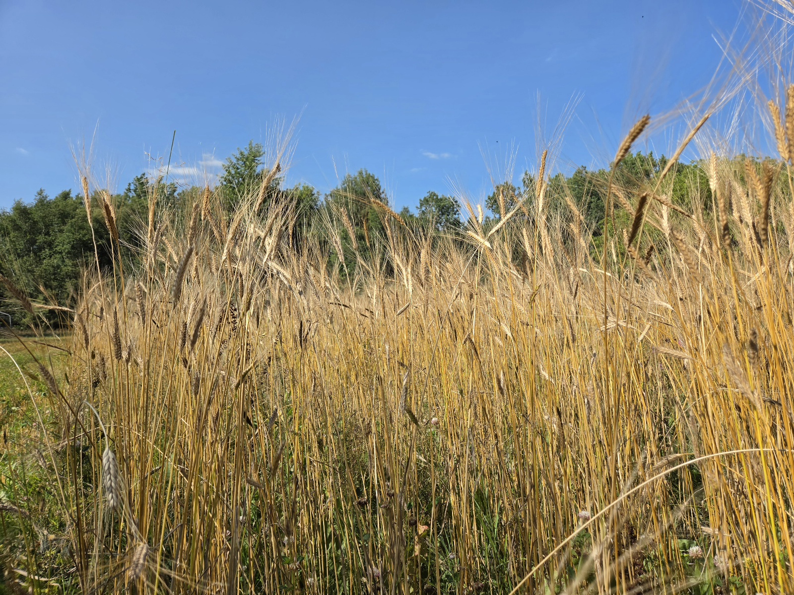

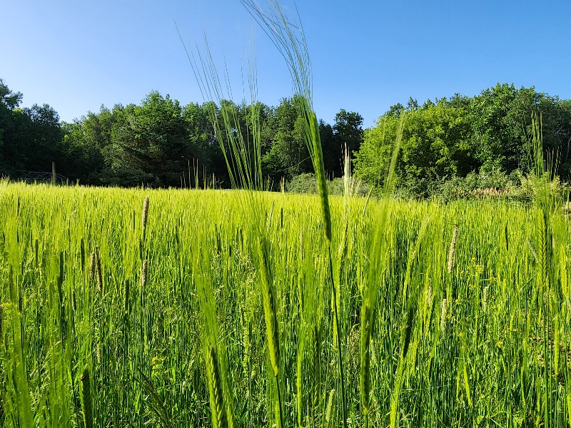

Ok fellas- here's where I am.

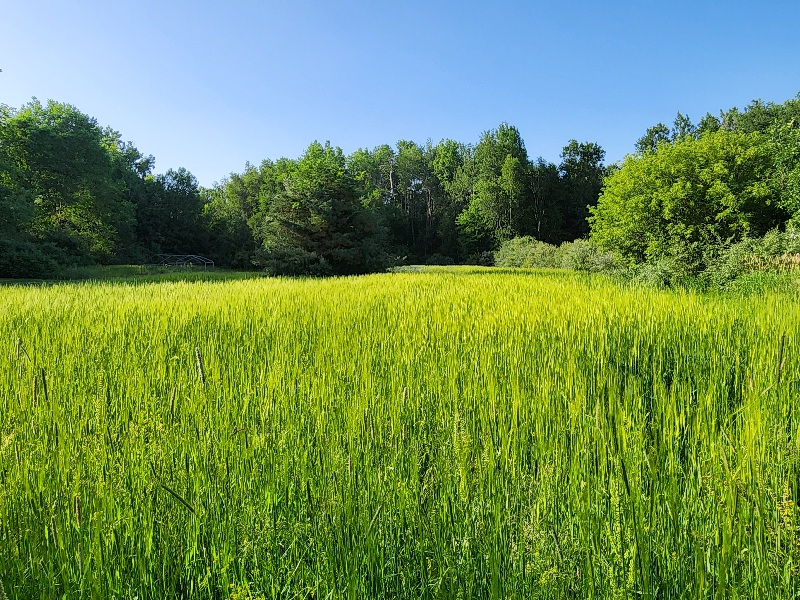

I planted einkorn last fall and to my surprise, the deer did not destroy my small 2 acre plot of wheat. It now looks amazing and is headed out, still green but headed out.
Question- Grandads 66 Big Bin combine has a pick up head on it. I assume I can use a sickle bar mower to cut the wheat, Rake it, the combine it. The Big Bin last combine Oats some 7 years ago. Do I need special screens for the combine or is there an adjustment for the smaller wheat grain? Yes I'm a newbie to the all crop, but willing to learn! Thanks!

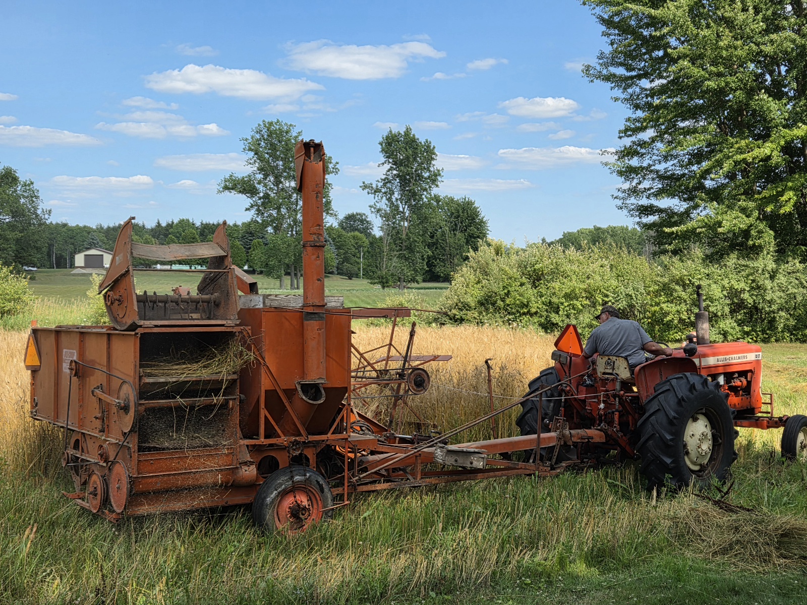

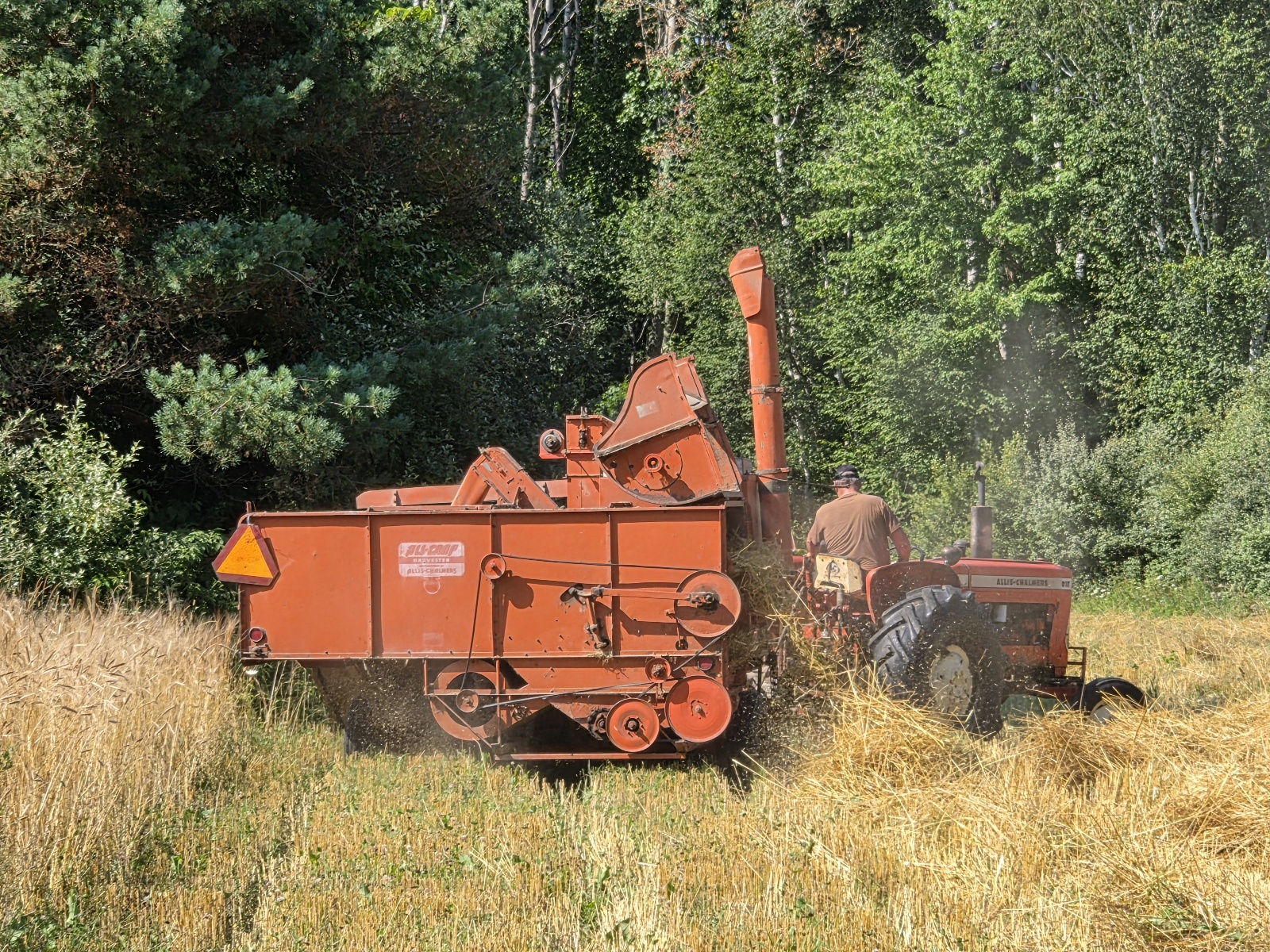

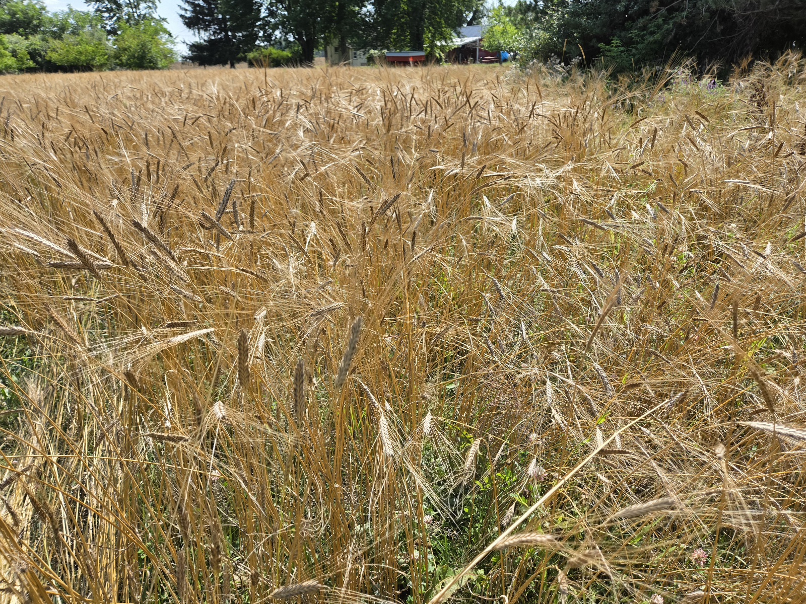

Its been a VERY BUSY year for me. I got Married to the love of my life on July 25th, and have spent many months planning the wedding with her. I haven't been able to post videos lately with this taking priority, but I'm excited to get settled into our new home together and start life with her. MANY new great videos to come, I have 4 or 5 in mind and footage recorded for some others already.
Einkorn! What's not to love?
This ancient grain is really cool to work with.
Whats even cooler? My Family all helped out with this Harvest project, from getting Grandpas 66 Big Bin out of the barn that hadn't ran in 8 years, to being there for harvest.
We all had a BLAST enjoying the afternoon, and even better yet, my mom with a last minute decision was able to get grandpa out for the afternoon to enjoy it.
He will be 92 years young on August 16th. He loved every minute and was "sure to tell us" all the tips on operating the all crop and the mechanics. We knew he would know!
One of the highlights of the summer for me.
Wanted to be sure to update you guys, I know some of you were interested in this project. Be looking for a video on this day hopefully by end of September!

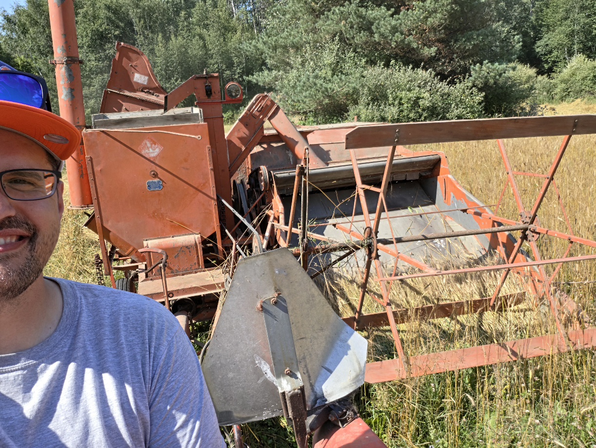

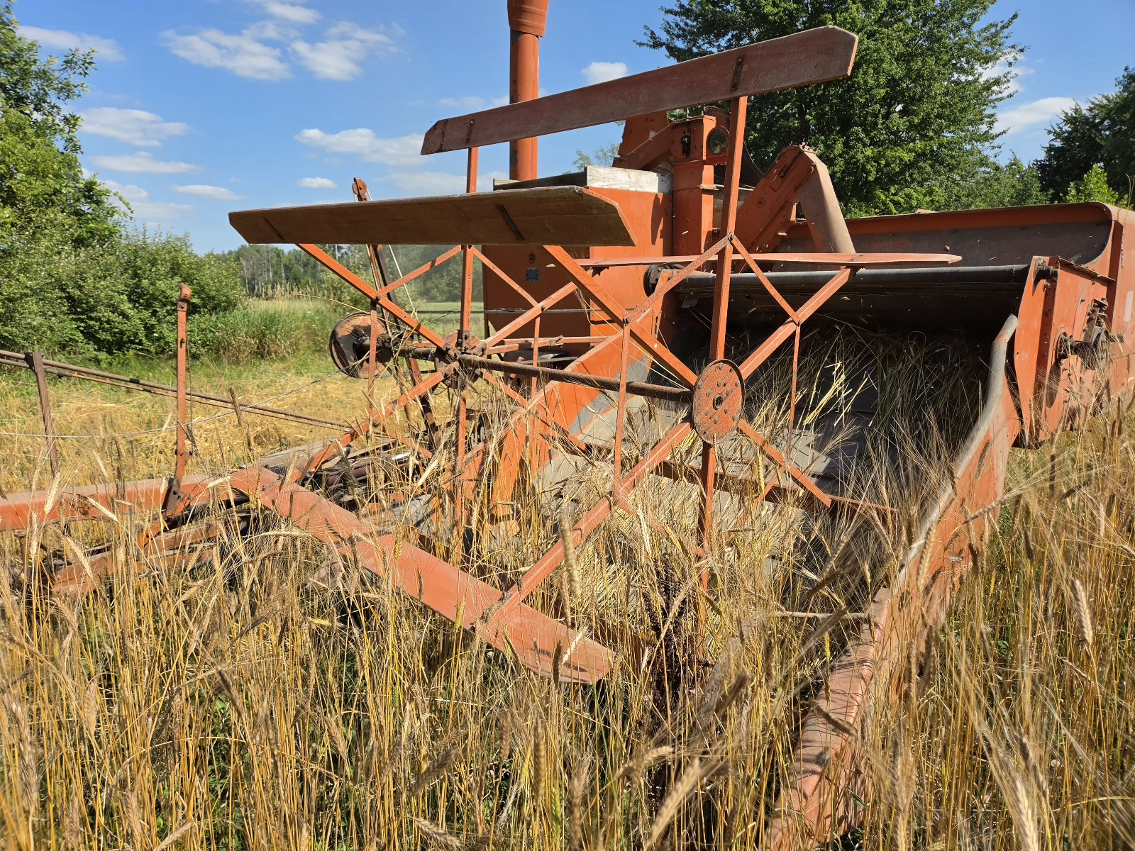

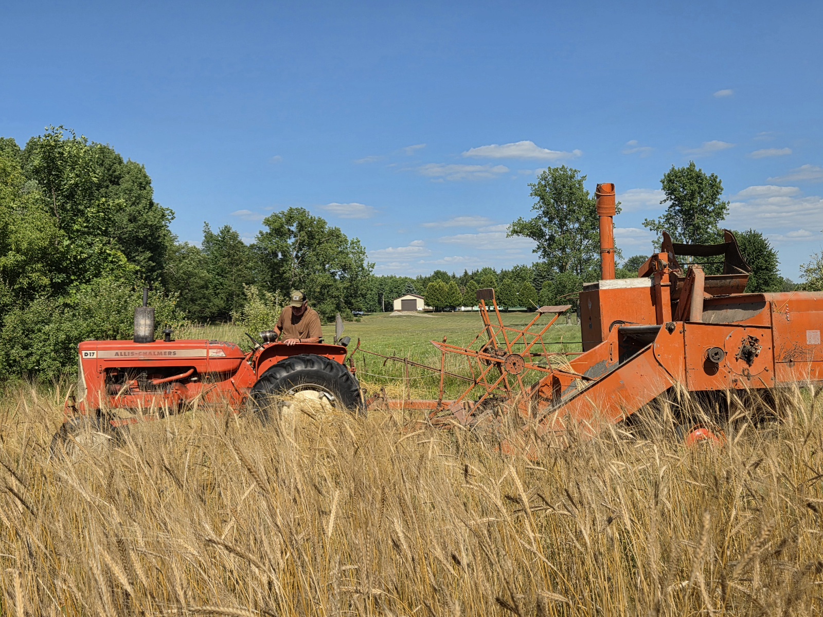

Your first post asked about swathing. It looks like the combine has a direct cut head.
Posted By: Don(MI)
Date Posted: 05 Aug 2026 at 12:18pm
Correct, at the time of original post, I didn't realize grandpa had removed the pick up attachment.

Sounds like a great day. I've enjoyed atching some of your video of your grandpa interviews. Was that his 66?
Posted By: jvin248
Date Posted: 06 Aug 2026 at 12:21pm
Looks good!
I grew a patch of eincorn last year. This year I grew Turkey red wheat.
There are a few eincorn dehulling videos on YouTube. They use a $20 "corona mill" off Amazon and a pair of rubber disks adhered to the Mill's grinding faces. The grain is rolled out of its hulls.
Then it's like wheat processing from there.
Posted By: Don(MI)
Date Posted: 06 Aug 2026 at 2:56pm
Yes, that is his 66 combine and also D17. Was great to see both out in the field working. Had alot of family fun that day.

Posted By: wjohn
Date Posted: 06 Aug 2026 at 6:17pm

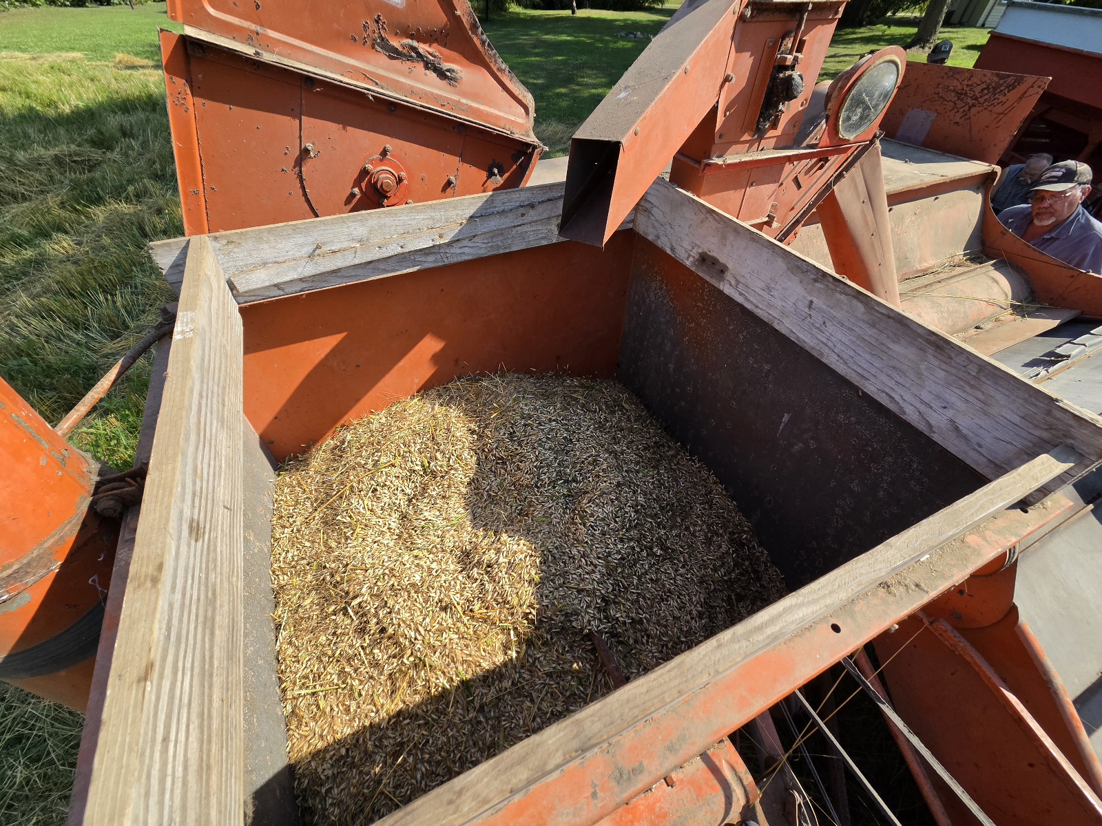

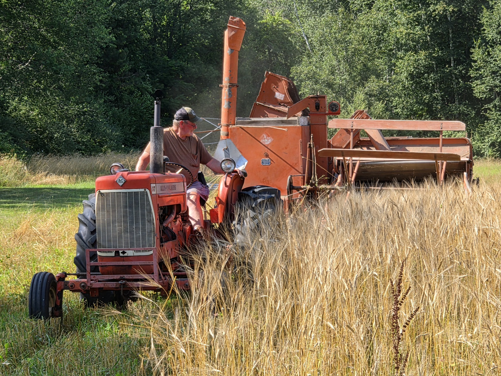

What screen (if any) did you end up using? I see some decent-sized stuff in the bin, so maybe had to run without one?
Thanks for posting all of the pictures!
Posted By: Don(MI)
Date Posted: 06 Aug 2026 at 9:31pm
thank you!
Galatians 5:22-24
Posted By: Don(MI)
You know John, we ended up just going with the last screen Grandpa had in it, when he took Oats off about 8 years ago. Lol At the time we got the combine out 3 days ago, we didn't see any other screens. But grandad says he has more somewhere, but I haven't seen them. I think it did a decent job on the Einkorn, I'm just guessing by what was left in the straw, that we got 90% or so thrashed. I'm sure someone with more experience could have done better though. I'm just a rookie- but having fun!

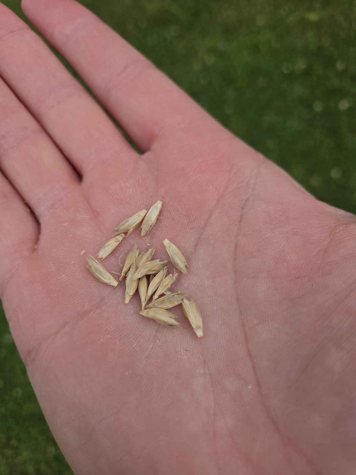

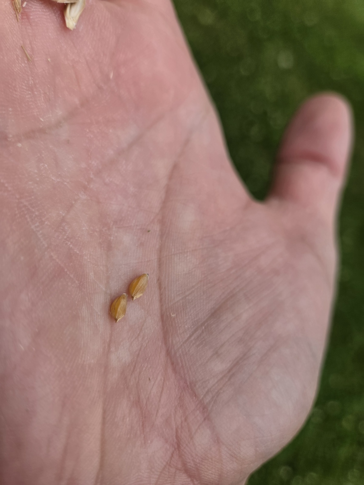

Eincorn has a hull that grips the grain like oats. So you need a second process to rub the hulls off. Then it's like wheat seed.
Middle ages they ground it with the hulls on and the bread was dense peasant food. The hull fiber tends to puncture the yeast bubbles. The fancy wheat was sent to their local Lord to snack on.
Posted By: Don(MI)
Date Posted: 07 Aug 2026 at 3:21pm
Yep- what he said...
Have a secondary process to "Dehull" before you get to the real grain
