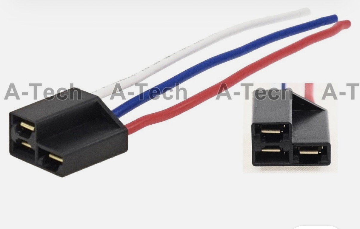

I need to replace the alternator 3-wire plug pig-tail on my 7010, but can’t seem to find anything with a google search. The alternator model number is: 1102922-72A
I thought that I got one from someone on here several years ago for the 6080, but can’t find any record of it…

     l    Is this how the plug looks.? That's the plug in for Delco SI. There's 2 versions; one has 3 wires and one has the 3 wires but 1 wire has a diode (little swelled spot in wire).
Try NAPA, O'Rielly, and Advance parts stores.  The computer user probably won't be able to find them.

I get mine from select parts, #762-1003.

It sounds like you're looking for the three-wire plug without the diode like the above pic. But a word of caution if you happen to be looking for the one with the diode: Half the ones I've bought of late have the diode installed backwards, and I have to cut it out and solder it around the right way. Reading on other forums, I know several other folks have had the same issue.
