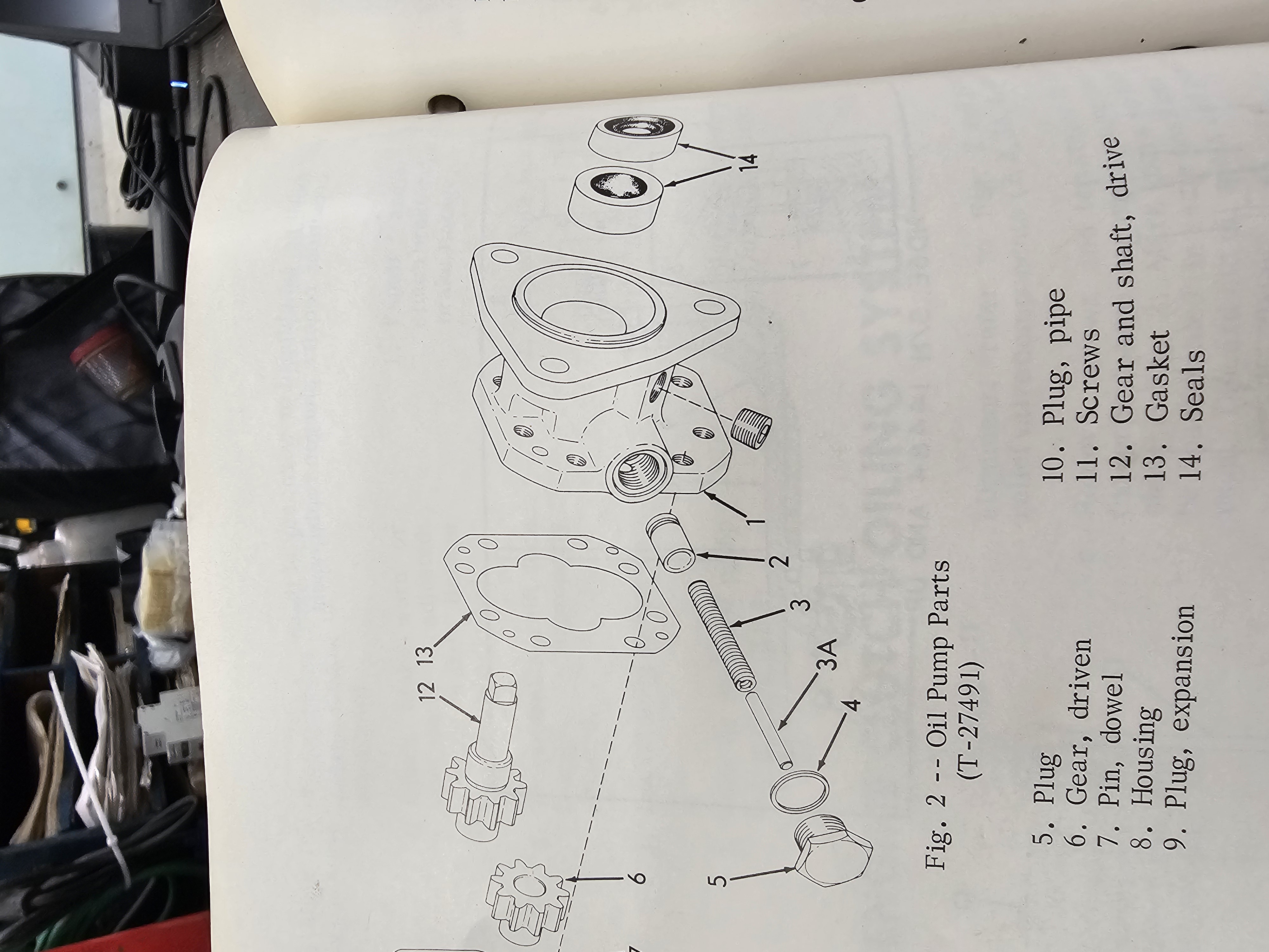

Is there more then one style of pump for a wet clutch?
Posted By: Primos75
Date Posted: 20 Apr 2026 at 3:47pm
Posted By: Primos75
Date Posted: 20 Apr 2026 at 3:48pm
Pics for reference

I have the small pump  t 27491 = 620201
Posted By: Primos75
Date Posted: 20 Apr 2026 at 10:56pm
I think that's the one. Does it have the fork or pump drive coupling on it still? That part number for the coupling is 630914. Thanks

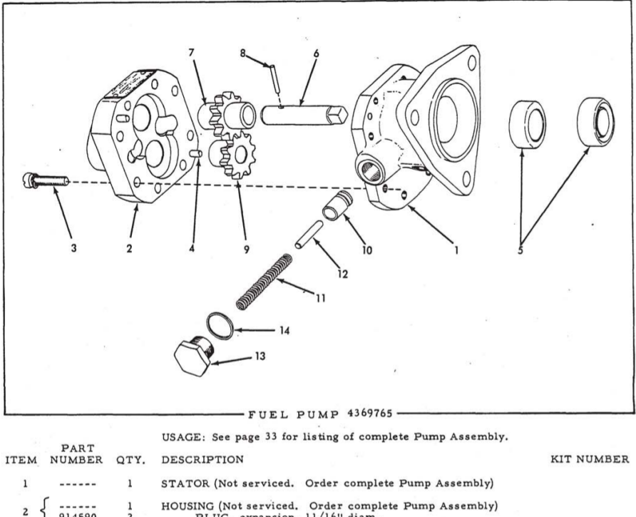

This is a screenshot of the Barnes fuel pump for the 2-71 Detroit Diesel from the HD5 parts manual:

Originally posted by Les Kerf Les Kerf wrote:
Originally posted by Primos75 Primos75 wrote:
I wonder if anyone's tried this or if it can be done. I've had no luck looking up the part number. Salvage yard near me would pull one of an old machine for $300 but I dont know about that. Seems a little high. My buddy has one on a non running 6g but it would be a bear to get to.
That is a left hand pump shown in the photo.

Very similar to the wet clutch pump i posted. Does anyone know what the psi and gph the pump should have for the clutch? The manual says the filter has a bypass at something like 18psi I think.

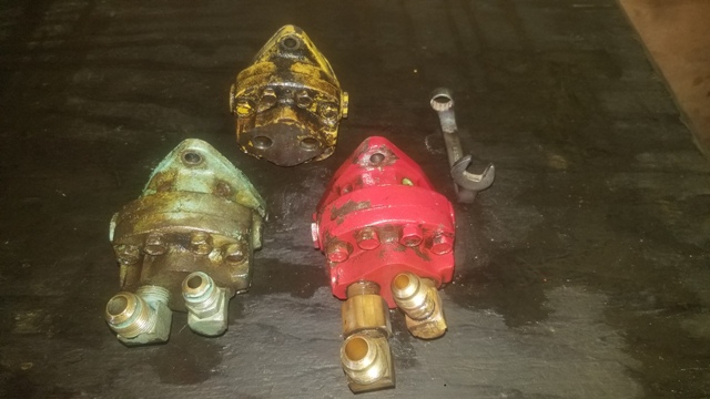

In your application of that pump I've not found any specifications; but they are simple to modify. That spring shown in Les's photo, (#11) is what actually sets the relief pressure, or opens the bypass as mentioned. I've seen those pumps relieve at 20psi, (shot) and I've seen them make in excess of 100psi using diesel fuel as the fluid medium. I've never seen them in a hydraulic fluid other than fueling application myself.
The red pump is from a 6V-92TA, the green pump from an 8V-71, and the yellow pump in back is from a 3-53. All are Detroit engines I currently own. The two front pumps are left hand, the yellow rear pump is right hand. You can ascertain this by looking at the venting ports facing up and are seen on the two front pumps. The relief valves are on the left with the front pumps, on the right with the yellow rear pump in the photo. The wrench on the right is one I bent up to access hidden fasteners and worked well.
I've seen you chasing the same thing over on FB and I've found technical questions are best handled over there unless gossiping about farm stuff which fits well on this site any longer. But that is just my opinion.
Both sites have their place however.

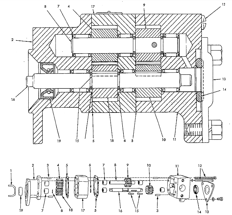

I did find some specs on the hydraulic pump for the HD6 steering clutches; it has two sections, one section for each side. It did not give a specification for the pressure but did state that "Hydraulicsystem pressure is non-adjustable; system is designed with proper "built-in" operating pressure to disengage steering clutches"."
The manual does state that each set of gears has 1.5 gallons per minute capacity @1200 rpm.
I would guess that if you found a pump capable of ~2+ GPM and started out at ~20 PSI you could turn up the pressure until it could cycle the clutch it should work.

Re that double section steering pump for later HD6E tractors.
The main clutch pump bolts onto the rear of that behind cover 13, so it is in fact a triple section pump.

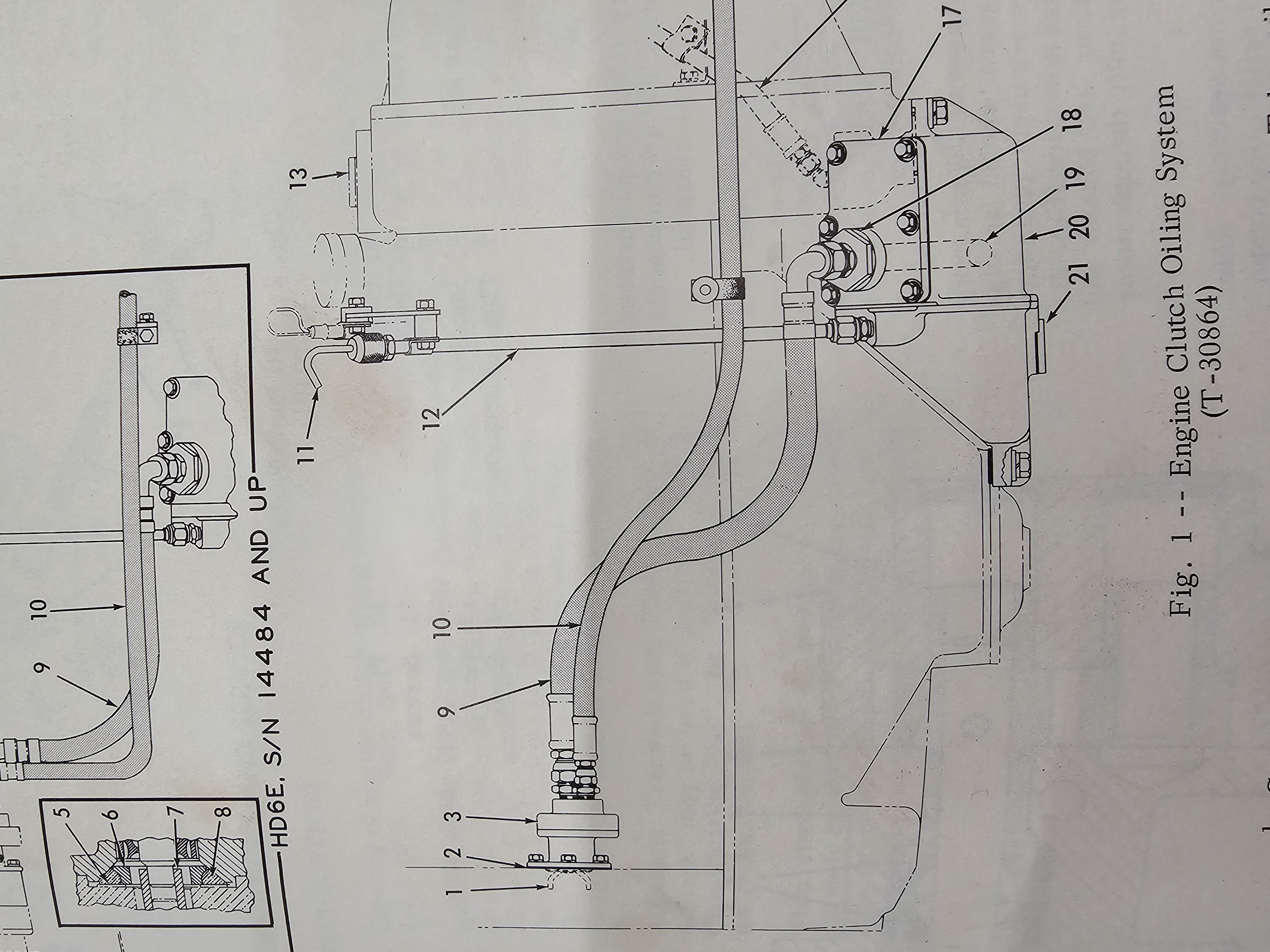

Master clutch oil pump is only a circulating lube pump. And oil pressure is only around 20 psi.  I know this because ive seen some late 40M series HD6 that had a clutch pressure gauge fitted in the dash.
Also the drive coupling used on all the pumps is the same 2 fingered 5/16 square coupling used on the GM, as that is what some of us have bought when the pump couplings wear out.   The triple section pumps can wear out the couplings if people run too heavier oil in the HD6E tractors

That sounds about right. Only 2 hoses, one going to filter for clutch and one from the clutch sump. I know i read in my manual that the filter or filter housing has a bypass at around 18 psi for cold or think oil. It takes a dextron 3 atf if I recall. Not just hydraulic oil. So in theory if a man could get a barnes style pump, if it would pump atf, to push about 20 psi then it should work...I think..lol..maybe

Apparently I misunderstood the function of the pump; it really doesn't assist in actuating the clutch, but rather is only to facilitate circulating the oil for the purpose of filtering and as an aid to cooling?
Posted By: Primos75
Date Posted: 24 Apr 2026 at 11:45am
That sounds about right from what I gather. Lubes the clutch plates and circulates through the filter.
