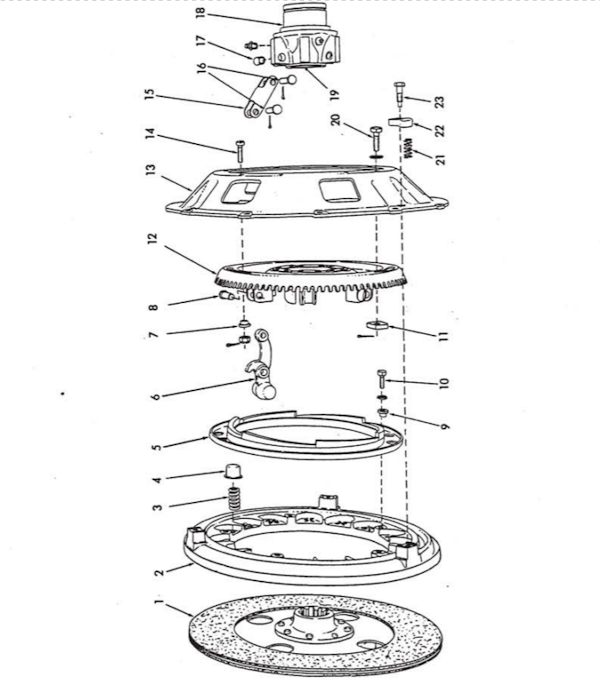

Posted By: Les Kerf
Date Posted: 19 Aug 2025 at 1:32pm
Originally posted by Jhilton69 Jhilton69 wrote:
I've been driving the inner ring clockwise for a while now its slow going for me since it's hard to get in there. That would make the outter notched ring go on the counterclockwise direction to loosen is this correct?
Sometimes I get easily confused Confused
Perhaps a picture may help?

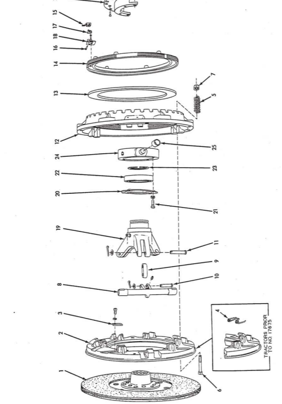

Posted By: Jhilton69
Date Posted: 19 Aug 2025 at 2:28pm
Thos isn't the clutch in my ol gal. Mine has a outter ring like a castle nut facing the rear. And a flat surface on the inside thay I've been turning
Posted By: gemdozer
Date Posted: 19 Aug 2025 at 6:09pm
This is a AUBURN  cluch on photo and you should have a ROCKFORD cluch and it could be the tread on adjusting ring or the backplate treade are bad or it could be the 3 cam bearing are bad worn
Posted By: Les Kerf
Date Posted: 19 Aug 2025 at 7:12pm
Ahhh... let's try this one
Date Posted: 26 Aug 2025 at 3:40pm
Ok looking closer at tje poc ya its what mine is. I've been beating on ot for a week now and it won't turn. Im at a lose any help would be appreciated
Posted By: Les Kerf
Date Posted: 26 Aug 2025 at 5:24pm
The only unit I have experience with is the Auburn clutch so I'm not much help. The Auburn clutch has ramps that make it easy to decipher, but the Rockford clutch isn't readily discernible from the drawing.
Posted By: gemdozer
Date Posted: 26 Aug 2025 at 5:50pm
If you can not adjusted your cluch it could be the cams bearings ,links and pines,traide on adjusting ring,brooking springs you better pull out the cluch assambly and you will see the probleme.
