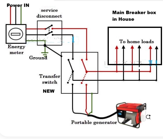

yes Don.... what you would need is a THROW OVER TRANSFER SWITCH on the power line coming into your Main breaker box..  The BREAKER BOX could be connect to the Power Companay, or it could be connected to a 50 amp RV plug..... You then use a heavy extension cord to connect your Portable Generator to the RV plug....  Generator can set outside the garage and you could have the RV plug in the house or basement, or where ever.. Then a 20 -30 ft cord to connect them... This is basically what i have..... and then your ENTIRE HOUSE is powered.. If you dont want the Air Conditioner, Electric Dryer, welder, etc to "kick on" then throw that breaker off.... You would not need the small extension cords to the frig and lights.. that would be powered from the Breaker box as normall..... but you COULD plug a cord into the 120v plug on the generator if you wanted to use an extra sump pump, skill saw, drill... etc..
Something like this... you may or may not have a Disconect switch out on the power pole that feeds into your house breaker boxx..( common in Rural areas, not city).

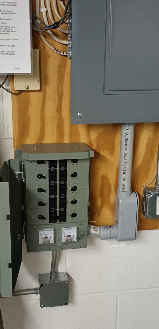

Posted By: Riprock
Date Posted: 17 Apr 2025 at 2:36pm
I did this and installed a 10 circuit transfer switch. All switching is done in the transfer switch. It lets you switch each circuit from line to generator power and back. you don't have to turn off your main breaker. You have to use 2 circuit spaces for any 240 volt loads. It also has meters so you can monitor the load on the generator.

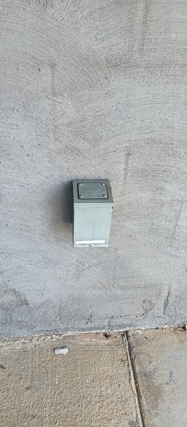

Posted By: Riprock
Date Posted: 17 Apr 2025 at 2:39pm
Outside you just have a Receptacle to plug in the generator cord.
The cover is screwed down in the picture.
Posted By: WF owner
Date Posted: 17 Apr 2025 at 3:07pm
Riprock,
Are there any 240 volt circuits or just 120 volt?
Posted By: Riprock
Date Posted: 17 Apr 2025 at 4:50pm
Both, you have to use 2 circuits for 240, 1 for 120. The bottom 2 circuit switches on mine are for an electric water heater so the handles are tied together. Similar to how a 2 pole breaker is.
 The transfer switch comes prewired with a length of flexible conduit, it just wouldn't work for my set-up so I used pvc instead.
 Since mine is 10 circuits it has 20 wires (10 pairs) coming out of the transfer switch, they're color coded and marked. For each circuit you want to power off the generator you remove the circuit wire from the breaker in your exsisting panel, wirenut that to 1 of the paired wires and place the other paired wire on the breaker.
 That way all switching is done at the transfer switch and since you don't turn the main off when your power comes back on you'll know it by leaving a light on not powered by the generator.

Posted By: Riprock
Date Posted: 18 Apr 2025 at 12:31pm
The Transfer switch I installed is all manual. A whole house transfer switch either manual or automatic would be great. Easier if planned when the house or service was built of course. To install later of is going to involve rewiring the meter base and main panel. It wouldn't be bad if you have an outside disconnect like the newer codes requires in many areas.
 There is a device that mounts behind the meter that allows a whole house hook-up. I've also heard many utility companies won't allow them.
 As far as where to purchase, it pays to shop. Most things anymore look like they roll out the same line with different brands stamped on.
