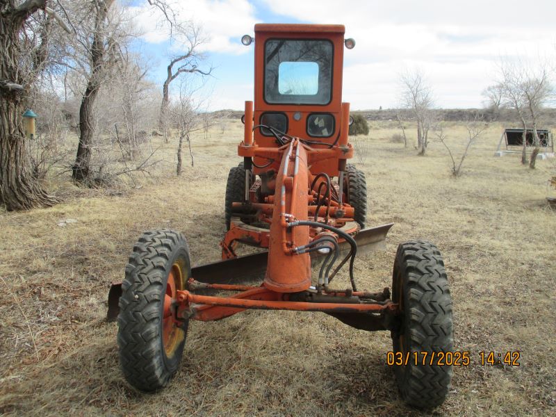

The grader was transported a couple of weeks ago so I am ready to start tweeking it and making it pretty! It is in pretty good shape as I believe it was used by a county in southeast Colorado and taken care of. There is no tag on the engine block, so it was probably replaced years ago.
It has Power steering, blade circle, and leaning front wheels, strong clutch and brakes, 12 volt system, 12 foot blade, heater in cab, rear hitch, and all the glass is good.
It will just get used to maintain the road to the property as the county says the road is not theirs.
I have some pics but will first have to get them below 2 MB to post them.

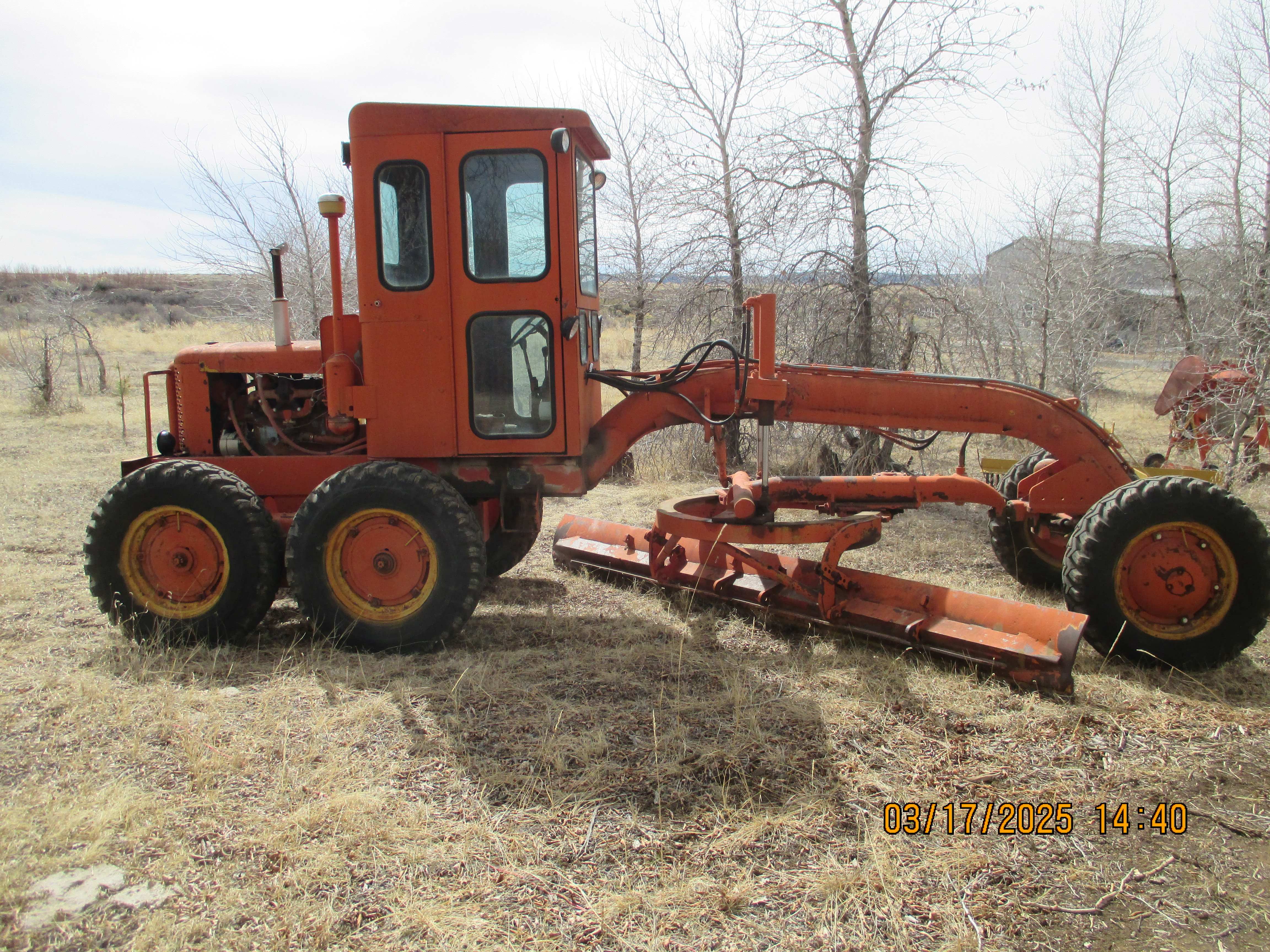

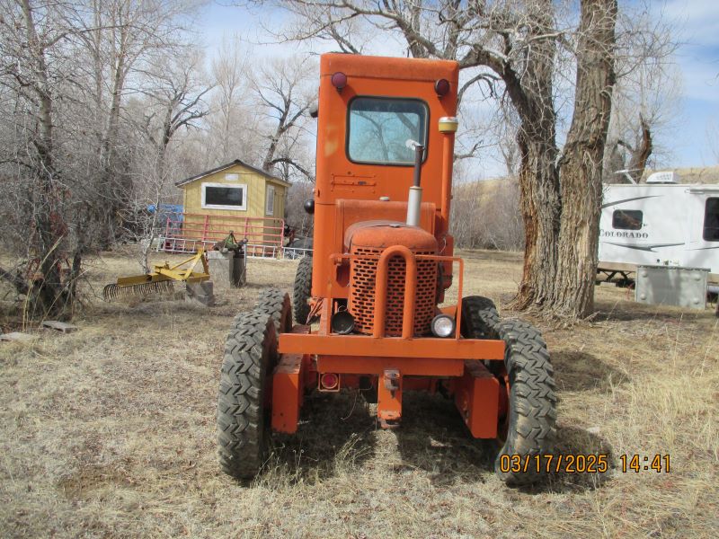

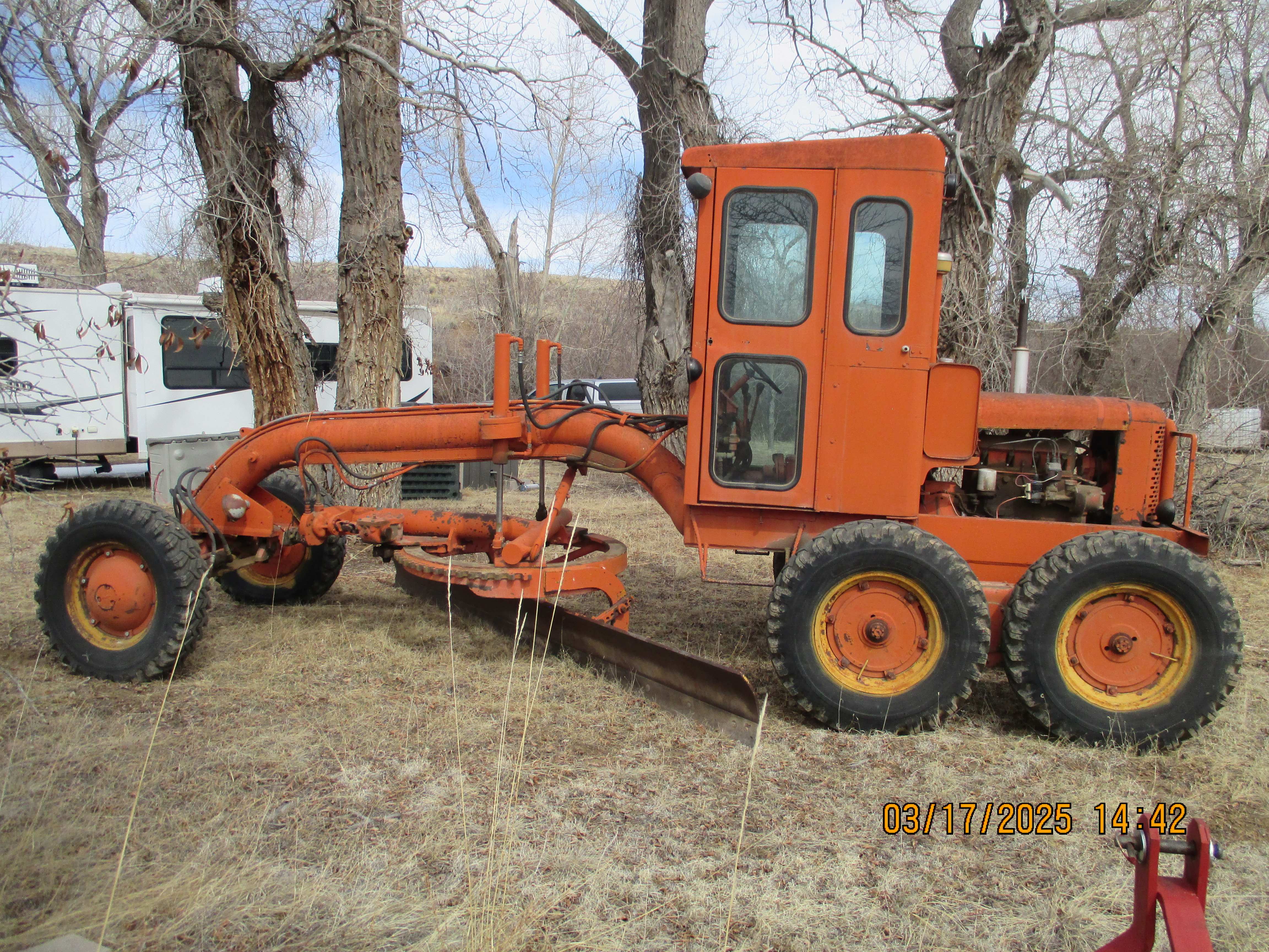

Posted By: Allis Grader Guy
Date Posted: 28 Mar 2025 at 8:12pm
Pic 2
Date Posted: 28 Mar 2025 at 8:13pm
Pic 3
Date Posted: 28 Mar 2025 at 8:15pm
Pic 4
