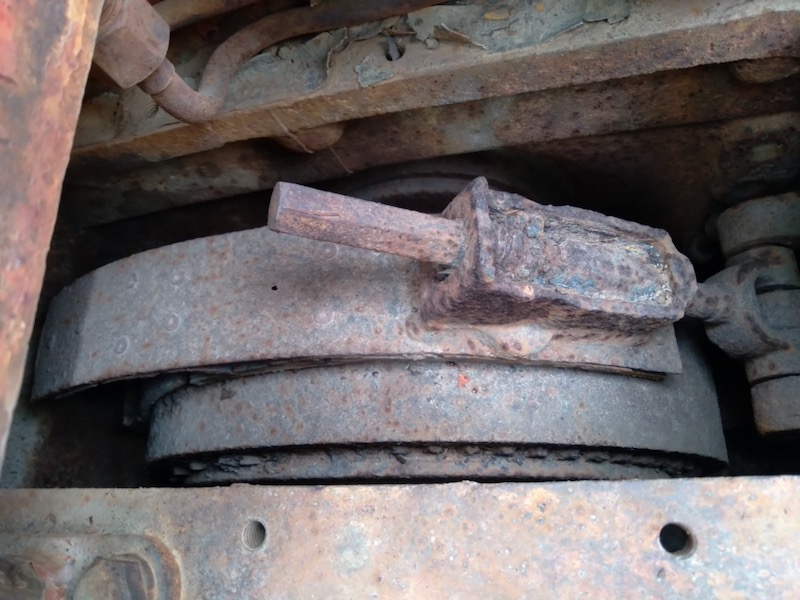

Sitting 10 years steering clutches very likely rust together and not steer. But with luck just time and no big money parts.

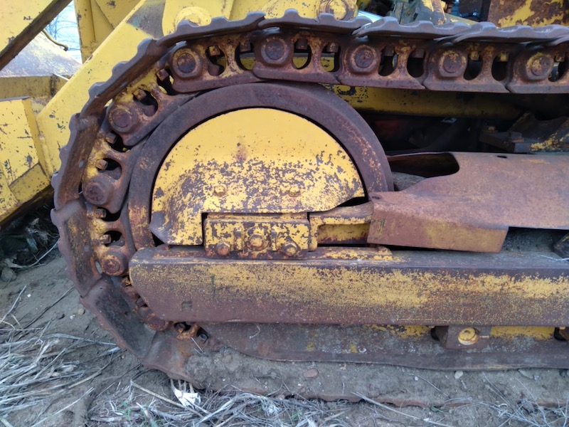

I checked this unit out. Engine is stuck, fuel tank is rusted out, and I'm guessing the steering clutches are trash judging by the missing teeth and teeth that rusted out and completely came loose when I grabbed them. The platform/seat are AWOL as are the steering clutch covers.
I haven't worked on steering clutches like these before so I don't really know what I'm talking about, but I suspect they were an issue to begin with (hence seat/platform and covers removed for access) and may be the reason the unit was parked?

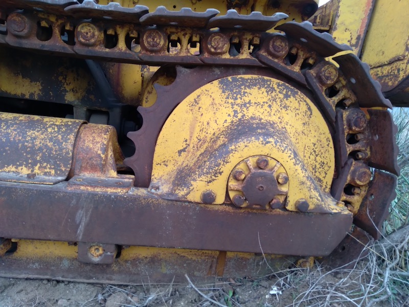

However the undercarriage is one of the better ones I've seen. Pads are worn, but the tensioners aren't to the end of the frames and the sprockets look decent.
I didn't find any cracks except for in the crossmember that goes underneath the shaft & u-joint from the engine clutch into the transmission. It looks like it kept cracking and they kept rewelding.
This would be a total project, or more likely a parts machine for when I find a running unit. Your thoughts - worth scrap price and the hassle of trying to load and haul it 150 miles?

The tracks look very good. The pins and bushings could still be bad, but lot more track than a lot have. The sprockets look almost new, which make me think the bushings are good too. Would be a crime not to save the tracks.
But how many projects can we take just for the love of old iron.
Posted By: Lee Bradley
Date Posted: 21 Mar 2025 at 4:09pm
I was thinking they had just put a new undercarriage on it and quit using it. I would pay a lot more than $500 for that machine just for the tracks and rollers.
