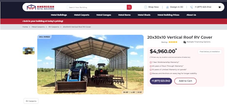

If your looking for COST $$... i would start with something like this.. You can alway add side walls or a lean too onto the sides at a later date... You just need a good ANCHOR to the ground.... rods or concrete weights..  Steel has to be better long term than the canvas tent type covers ?

Yep... I think I have it down to post frame or carport style, as far as cost goes. Looking at some of the carport style ones - they get pricey quickly when you only look at the ones with good wind ratings, especially as you go wider with them. They seem to be cheaper if they are narrow and long like for RVs, which makes sense since the structure can be pretty minimal across the top. Even at that, a lot of them require being set on concrete and anchored down to it to get that advertised wind resistance. Seems like I am looking at carports that wind up being about 2/3 the cost of a slant roof post frame building, so it's hard to not lean towards the post frame that should last the rest of my life.
We have had 30-40 MPH sustained winds all day and the highest recorded gust was 69 MPH. No storms. I don't want to go too cheap on a structure for sure - there are steel 55 gallon drums blowing/rolling around on my neighbor's property right now!
