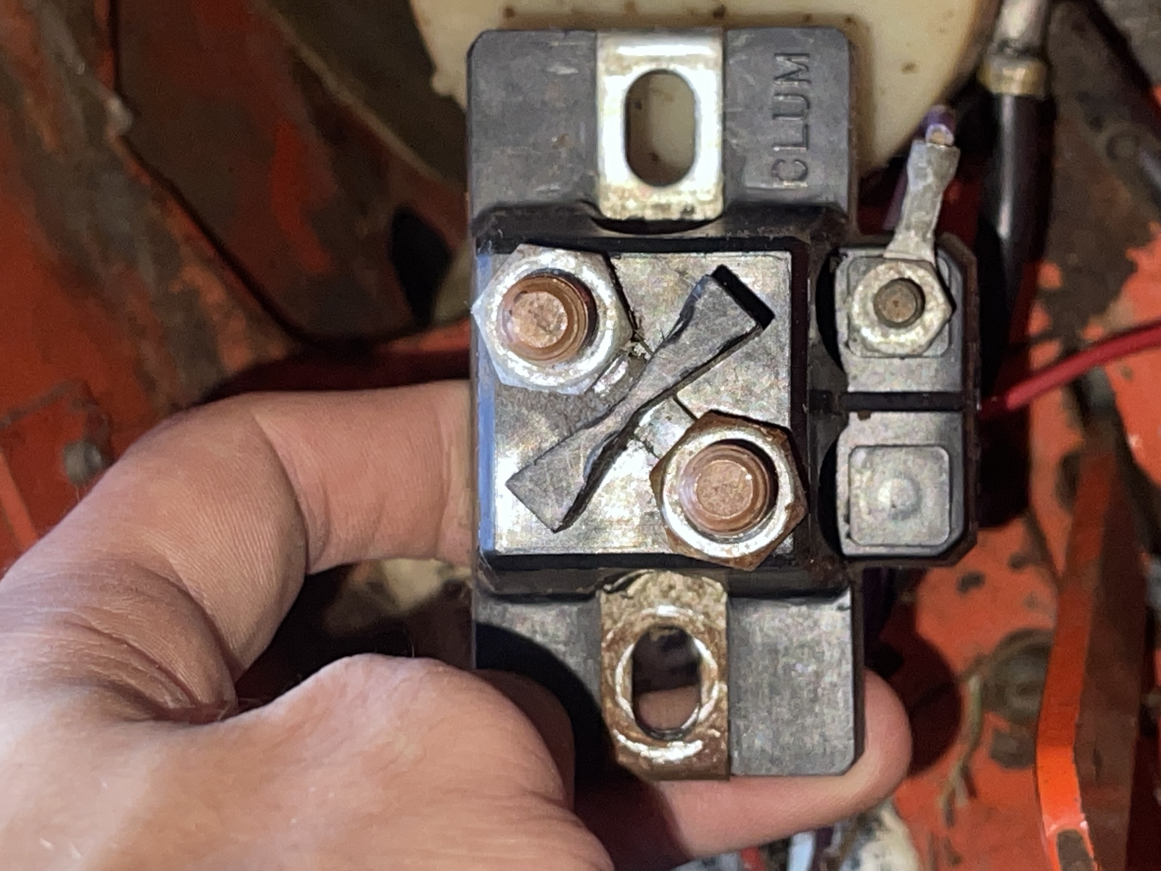

UPDATE: the man who sold me the mower a few months ago in working mint condition was so sad to hear it not working anymore he came out at 9pm last night to diagnose it.

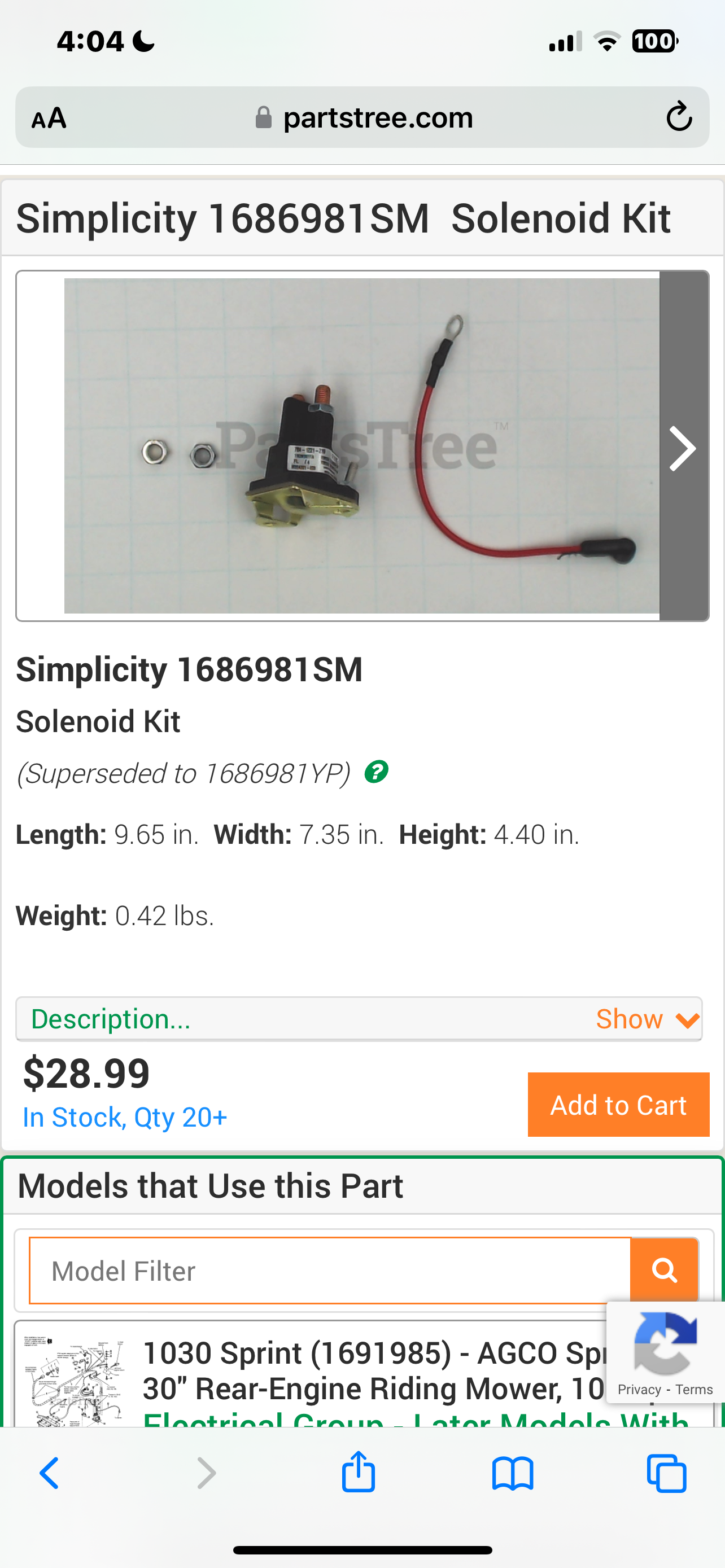

Sure as heck it Is the solenoid that has to be replaced because when I bypassed it with jumper cables hooked to the battery and crossed it with a flathead the mower cranked right up. Here’s another photo of the one that I bought for it that’s made by simplicity but doesn’t work at all
My 1984 hydro 616 mower stopped cranking the other day after working fine, after turning the key multiple times the starter solenoid kept clicking so I believe that has to be replaced. I have searched all over and can’t find anything to replace this part and the replay. Can someone PLEASE help me find this? I’ll Zelle you $5 if you can please just help me find a website that caters to the lawnmower 616 hydro mower parts so I can pick out what I need from that

For those curious yes I’ve used parts tree, sourced the exact pieces and that did nothing but prevent the clicking because all of the wires didn’t match what I received

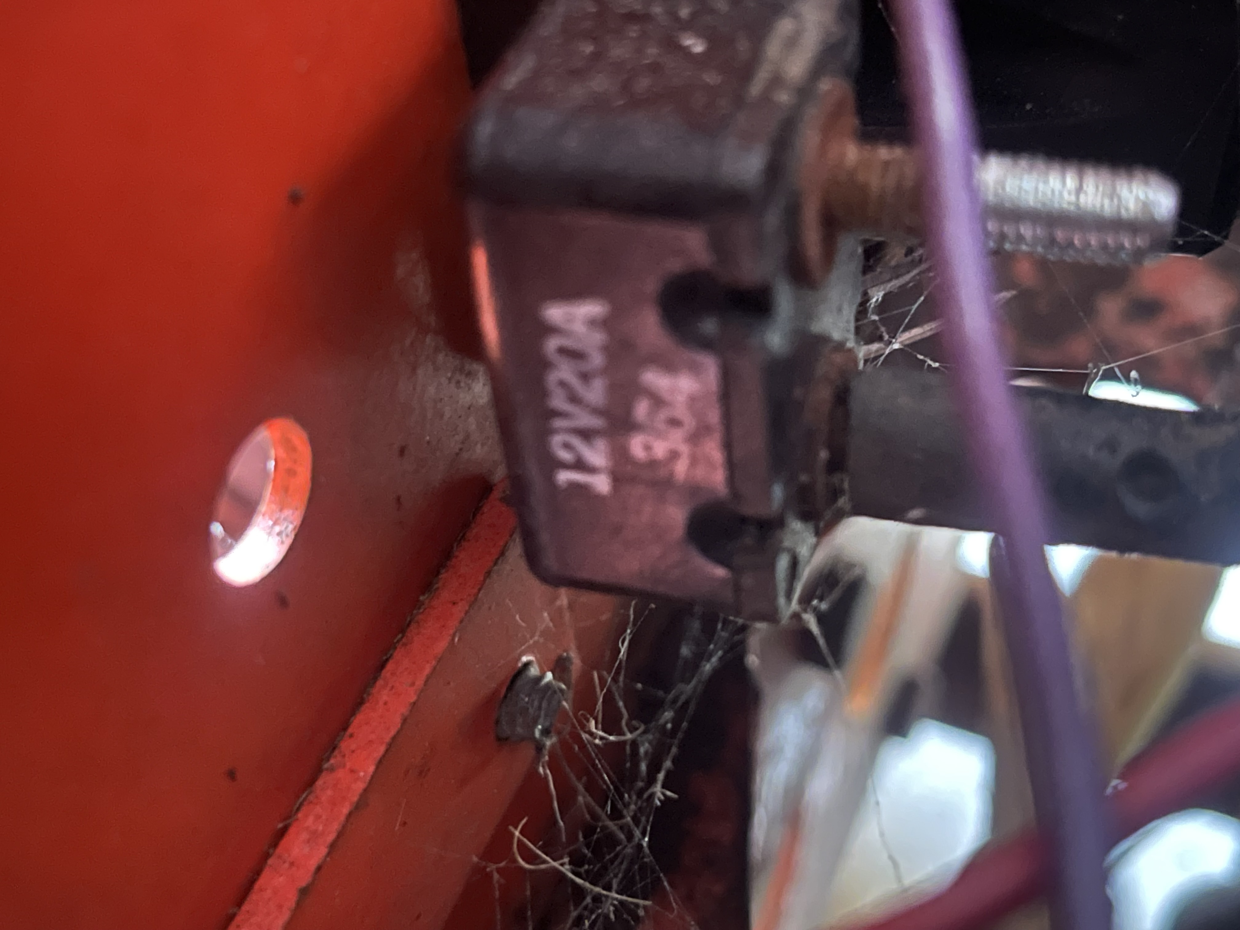

Welcome to forum. Sorry your picture is so big I can’t tell what it is.
My grandfather sold these lawnmowers new. Might have parts if you have part number

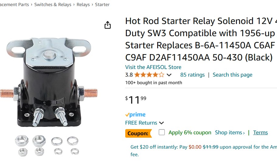

here is one from AMAZON... some have 1 small terminal, some have 2... dont matter.
Posted By: steve(ill)
Date Posted: 27 Oct 2024 at 8:14am
the one above is for a AUTO and is bigger, heavier, handles more power... you can also buy a GENERIC one for a lawn mower that will handle smaller batteries for 10- 20 HP motors..... Amazon, Farm Store , Tractor Supply... etc.

if you are not familiar with Starter Wire... The TWO BIG LUGS have large cables.. One from the BATTERY + terminal and the other BIG WIRE goes to the electric starter motor... When you turn the key to START, it puts 12 v thru the small wire to the small terminal on the solenoid... Some solenoids have a second small terminal which you do not need.. The solenoid should be GROUND thru its metal case to the tractor frame.
Posted By: Lost22
Date Posted: 28 Oct 2024 at 3:12am
Yes I’m aware of that, I wasn’t aware of it not needing to be wired to the 2nd smaller solenoid. Currently it’s mounted under the seat directly to the frame of the mower, it seemed to wanna work when I buy passed the relay with a screw driver so I just need to find the right part for it so it’ll crank and now possibly a battery
