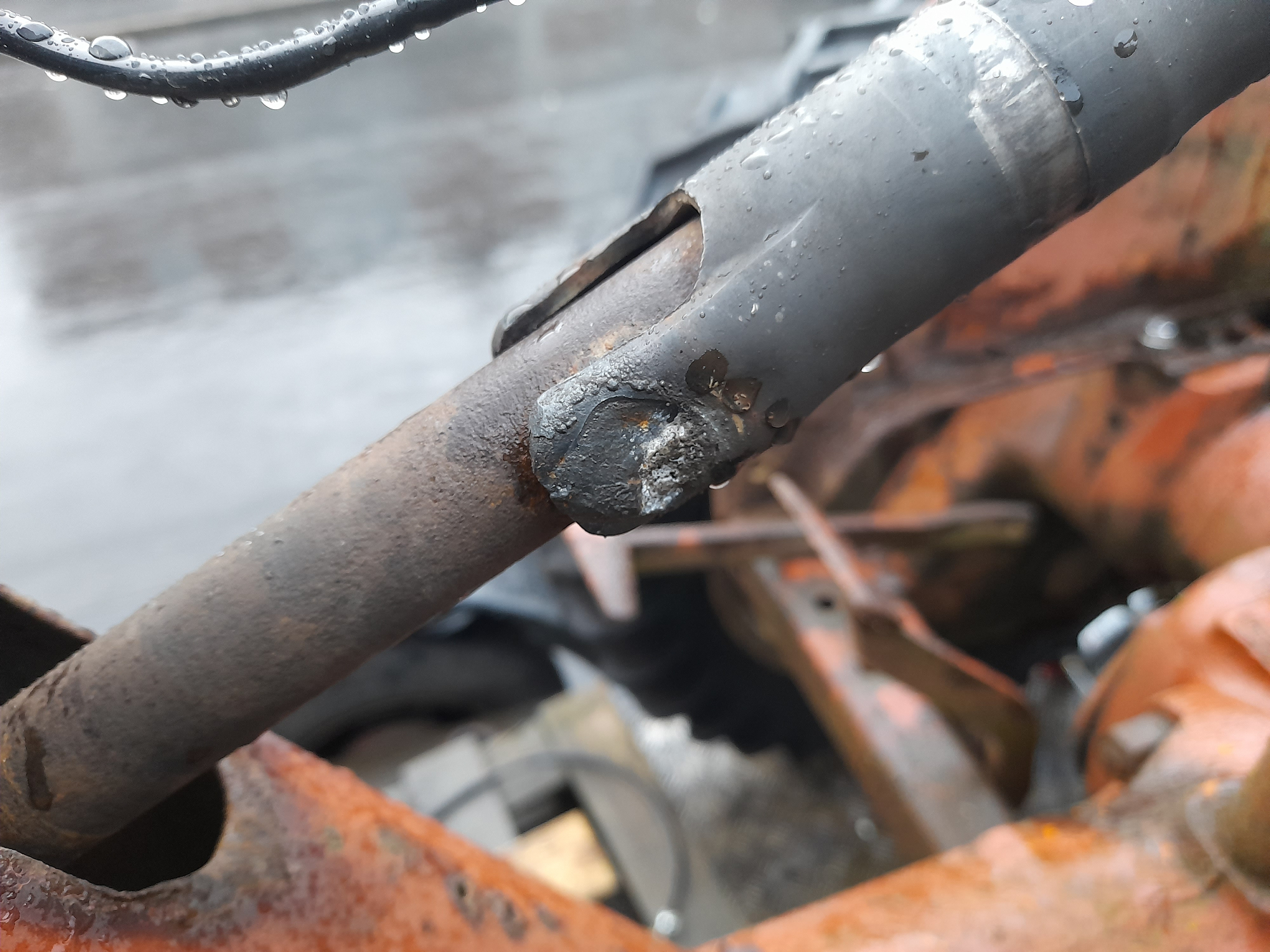

Newest problem (or not) is that on cleaning up the steering gearbox it was painted green, and on further inspection is actually a Fordson unit from a standard Major (especially weird, my first guess would've been JD or Oliver from the colour!)
Fortunately the seller is a good guy & along with locating the head bolts plus possibly the rocker assy. & may be able to find the steering gear with help of his father on whose behalf he sold the tractor.
For the moment I'll oil up the top end well, cover that & get to looking at the rest of the puzzle with the bracketry for the seat/tank,tins etc. and maybe look at the distributor.

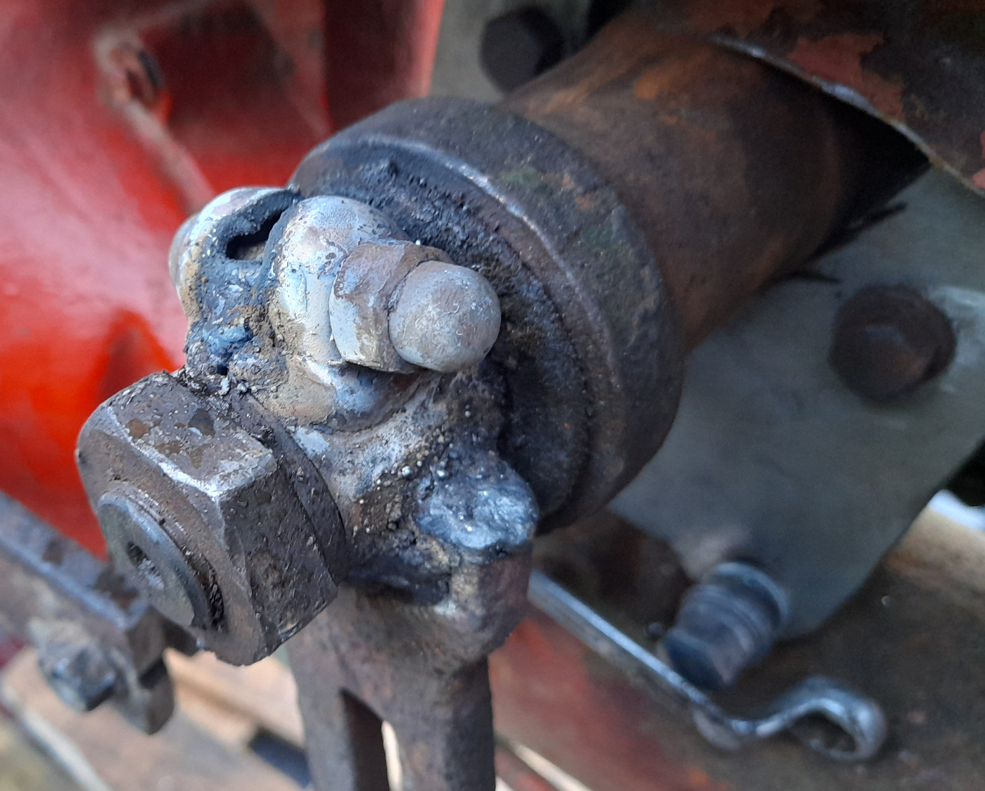

Need to weld a nut onto the oil drain plug that's rounder than the tyres & one of the final drive pans is rusted through, not to mention what little is left of the tinwork.

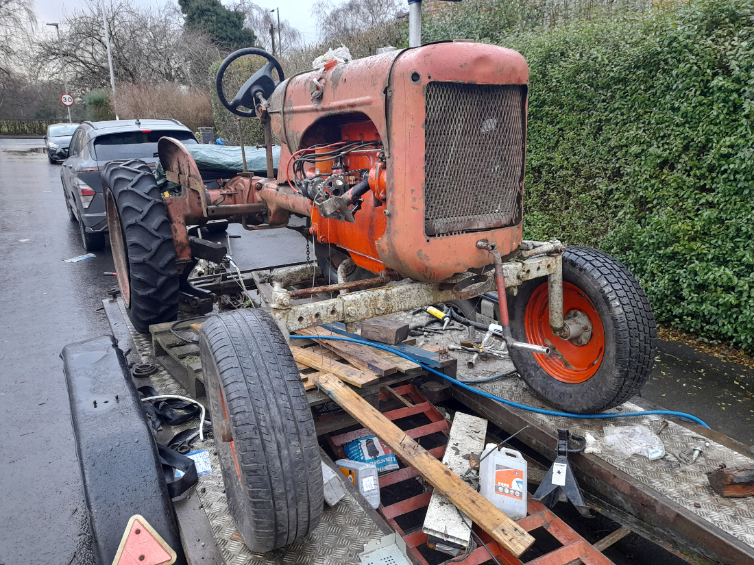

Hopefully some photos of the hackery & tractor as it now sits. Smile
DAMMIT site limit 2.0MB? I could'a sworn it was 3...
Just spent a while resizing stuff down to 3.0 but not sure if I can get them any smaller, more I shrink the image the size is going back up!

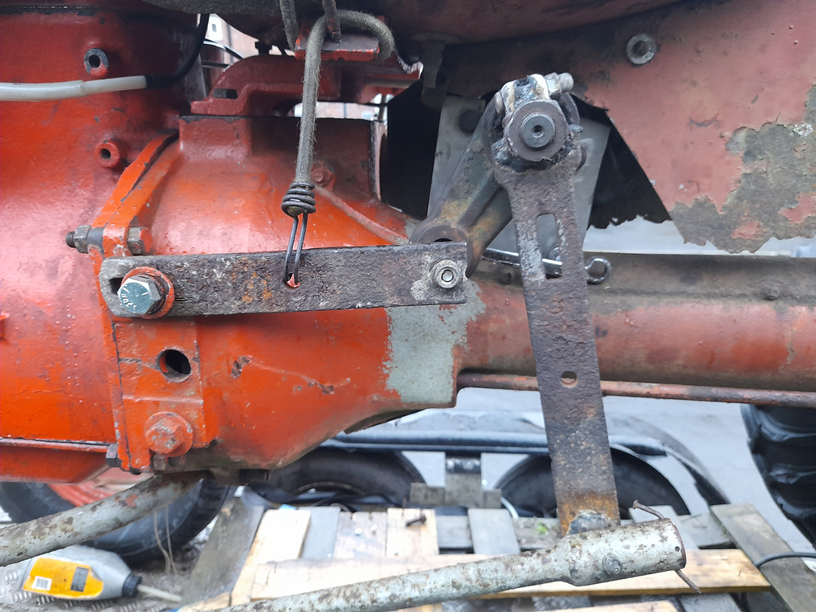

Posted By: ekjdm14
Date Posted: 23 Jan 2025 at 10:01am
Trying again lol I prefer welding and waylaying on stuff with hammers much more than computers! EDIT- Wahey we have pics at last! That was harder than it shoulda been!
First up is the abortion that is the "spline" end of the drop arm (well, the bicycle seat clamp & 3 point link that identify as the drop arm!)
Then the steering gear bracketry & drop arm rig up as a whole...
The rusty old girl as she sits, could drive off the trailer at this point but think I'll probably at least sort out an alternator and fan before that just so she doesn't heat up too much.

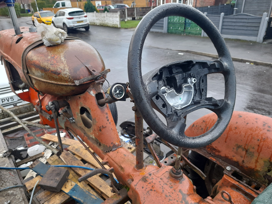

The marriage between 1940's Fordson & 1990's Citroen steering column...
Kinda the view from the driving seat, didn't fancy a wet azz so I'm off to the side a bit!
