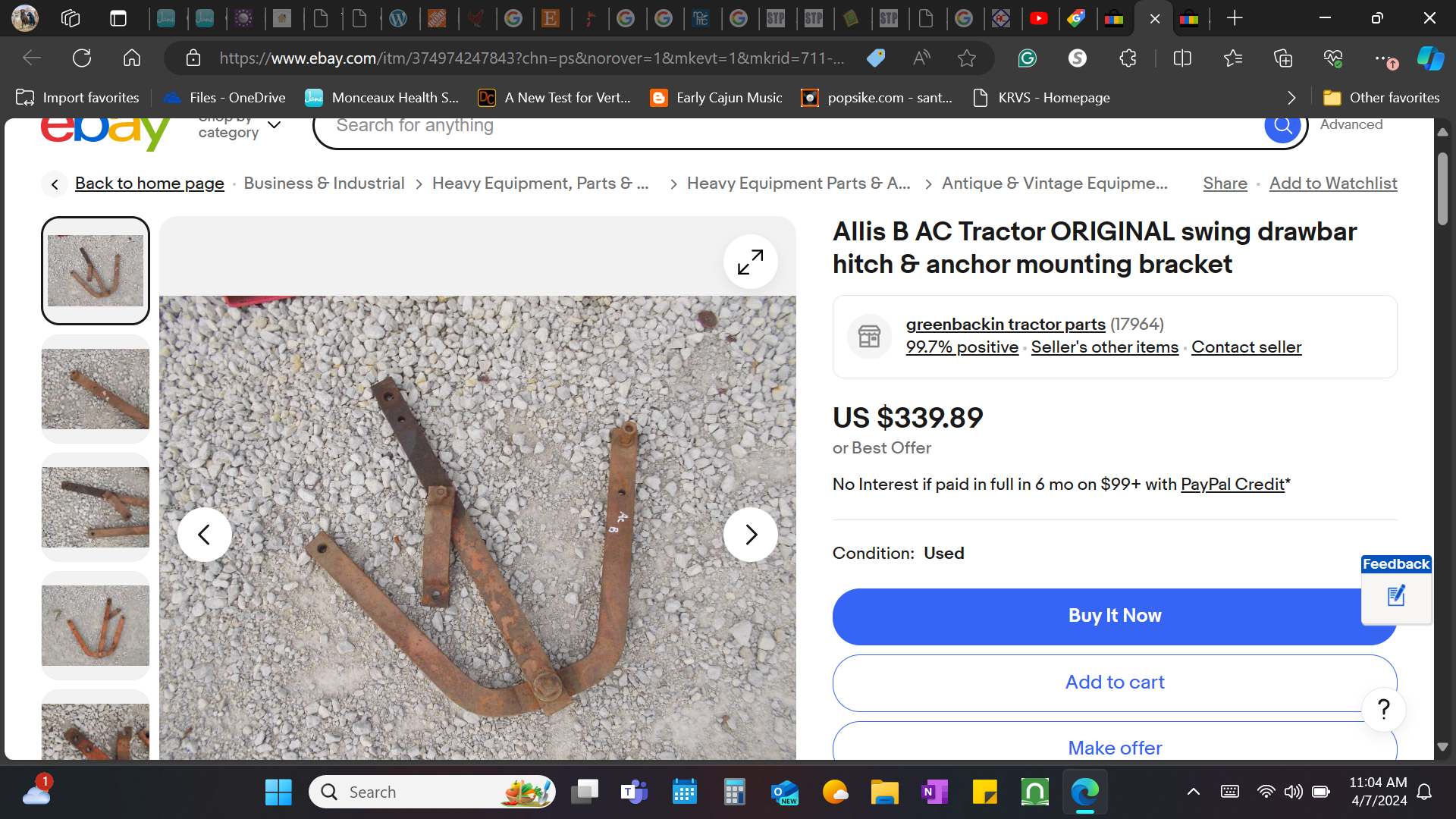

I have come across some original drawbars with mounts on eBay and am surprised how expensive they are. $350-500! These still need sanding and painting. So, I am wondering if there are any people out there who make and sell reproductions of these setup's...? I've checked Steiner and Tony's Tractors but all they have are the 3-point setups.

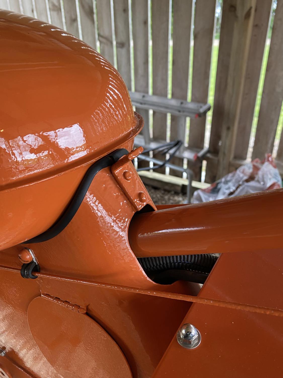

Secondly, I am wondering if any of you know what the purpose of the L-shaped bracket is that is mounted directly behind the fuel tank. I looked at pictures of restorations online and I see that some didn't have this piece, and some did have it, and some had some other variation of it, however, I never see anything mounted to it or it serving any purpose really.

there were a couple variations in the gas tank.. Originally it sat in the saddle and the  wide strap went across the front half and held it on.... later years also had a small strap in the back pointed at the seat, and one bolt that went thru it to that little bracket..
on the drawbar... you have the MAIN U shape unit on the tractor... The e-bay part you show is a swinging addition that you can add to  the MAIN U unit... You really dont need a SWINGING drawbar for pulling the plow for show.. you can sometimes attach the plow directly to the center hole of the MAIN U unit... or get a short extension plate and bolt that on if you need to get the hitch further back..

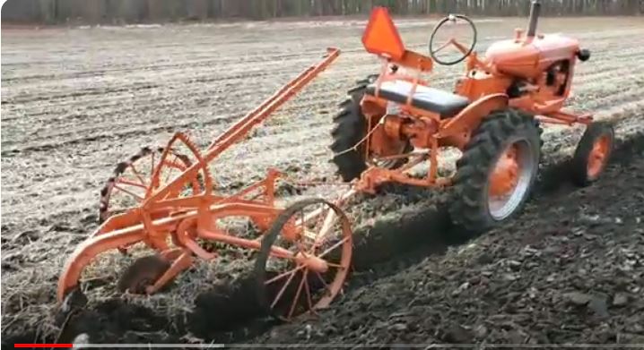

here is a photo of an old wheel plow with rope trip.. You can see it is attached to the swinging drawbar...
 Below that photo is an "adaptor plate" that you can buy or have local shop burn out of a 3/8 inch plate... The front 3 holes line up with your MAIN U drawbar... the 1 inch hole at the back is for the pin hitch to your plow.
