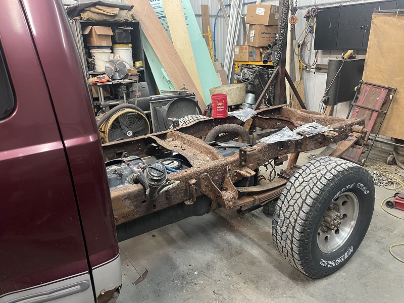

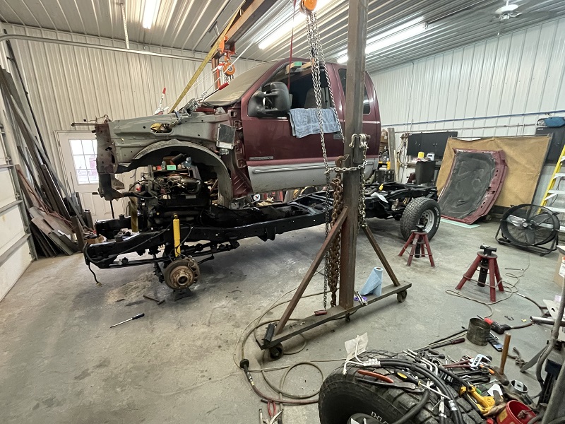

Have initiated the attack on the big iron pile.  Rusting away bed is ready to come off, fuel filler, tail lights and previously loosed floor bolts is all attaching today.
Made a list of Immediate to buy components, Engine, Drive Train, Braking and Body work will come to around $7,000, Paint will be FAR less than the Big Wagon where estimate is around $1000, will invest in a Fresh roll of MIG Wire for panels installs.
As get all this complete will be installing a SRW Flatbed, already started a Purple Wave bid process on a Local City take off, will also need considerable reman so bid LOW.  Can buy a New one, are under $3500 at another local shop at Swiss MO if previous fails, just have to add what I see as necessities on that as can.
Short list is Bed disposal, cab removal, clean and repaint frame.  Next up with cab off, Turbocharger replacement kit and Valve cover harness with Glow plugs change, final brake tube behind fuel tank replace, all P/S hoses swap, AC hoses, condenser, compressor and clutch replace, P/S Pump and Fluid change.  Air Intake boots replace, with as can inspect found as failed repairs.  New Shocks, replace ALL Wheels as are corrupted and seeping thru aluminum, spare rotted under truck and still has OEM 1999 Firestone on it.  E Brake cables and any other repairs there.  New body cushions, a replacement St Column Rag Joint. Full inner rocker panels with outers, cab rear corners, all Four Doors and both front fenders, rear door latch mechanisms, headlamp housings, rear third brake lamp replace, rear glass replace slider with solid.  Some Body Work beyond above, replace floor carpet with rubber, DEEP Clean Interior, headliner reline and console recover(Local does this), repaint cab and all hardware all one color.
Have to laugh, Nephew that was just a BOY when bought this wants it as I get done in use of it after the reman.  Was first truck he was allowed to drive on his Dad's place we initially bought my 180 for.  He is 38 this year.
Have to add, resealed front axle this last year, one has returned to leaking so back into that.  Has New ball joints, 90% all disc brakes, all remaining brake tubes are changed and new flex hoses frame to axles two years ago.  New tires two years ago.  Really wanted a NEWER truck, but for $10gr can I really afford to go buy a different project at $35-40gr?

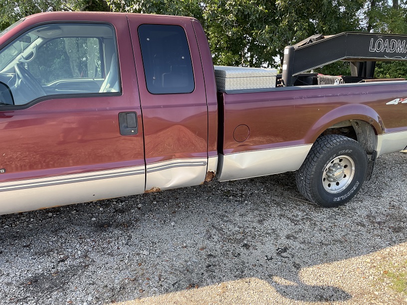

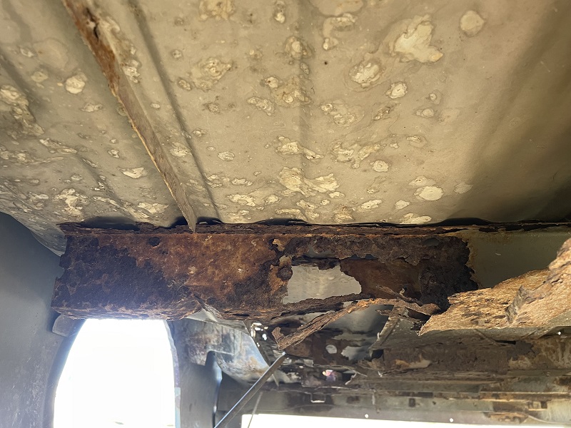

My ol Beater
ALL four doors are rotted from Inside, Bed to Frame supports are nearly completely rusted away, frame so far is showing solid.  R F Fender has a Tree Gnarl at front and both rusted at cab lower corner, rockers are SAD.  Upper Rear Door latches gave up last year., tail gate fell away from rust last year, was hanging on cables when caught it.
Been as good a machine as could have asked for.  7.3 is a boat anchor, is a hog in soft ground as front buries rapidly, but is worth the trouble.

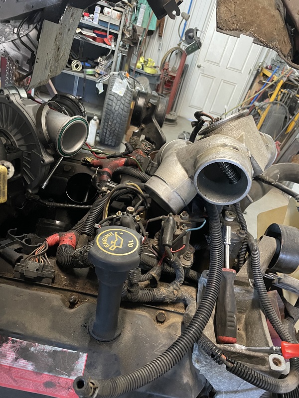

Posted By: AC WD45
Date Posted: 02 Jan 2024 at 7:01am

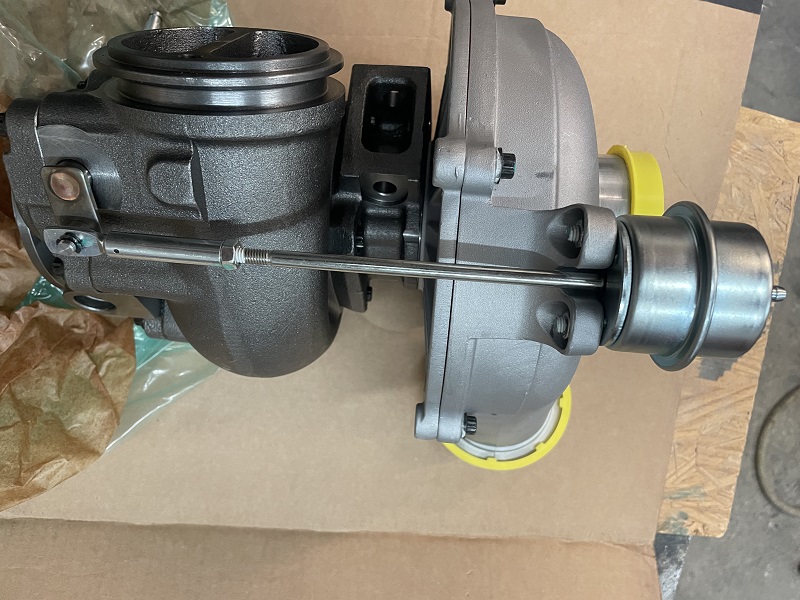

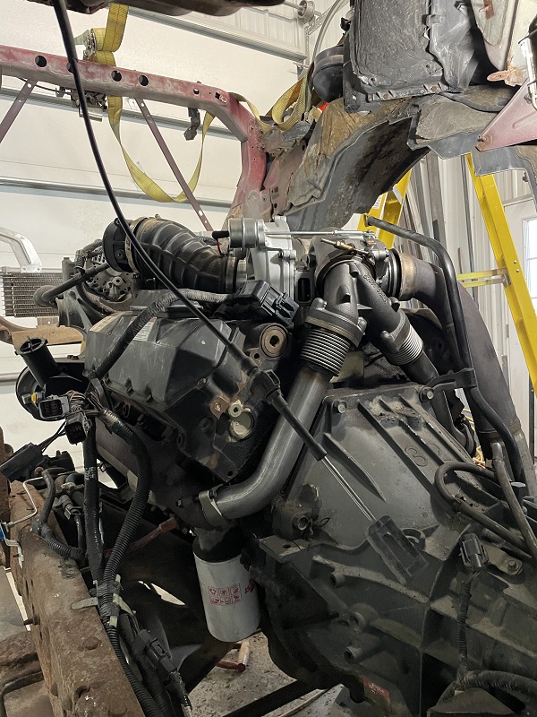

While you have the cab off, save your self trouble and replace the factory up pipes (manifold to turbo) with a bellowed set. The originals are solid and do not expand and contract properly causing leaks. They are a BEAR to change with the cab on. So it makes sense to do them with it off. Another thing to do at this point is HPOP lines and o rings.

Posted By: sho-man1
Date Posted: 02 Jan 2024 at 7:37am
Second that mention of replacing the up pipes with bellowed ones while the cab is off.
Posted By: Codger
Date Posted: 02 Jan 2024 at 7:43am
You are money ahead to change those pipes with the cab removed if planning to keep the truck. HiPop definitely service while the cab is off will save you grief.

Turbocharger replacement 'Kit' is priced with all that Included.  Up Pipes(Also Up Sized), air discharge boots for Air Charge Cooler piping etc.  Will also receive Valve Cover gasket/harness assemblies with replacement Glow Plugs.
Currents:
Spare was SO degraded was making hands Black as touched it, is Dismounted where wheel is also scrap, sidewalls were splitting as dismounted!  Was from first set of Replacement Tires I put on the truck, as came with Street Treads on it new.  Date Code from 2000 as installed 2001.

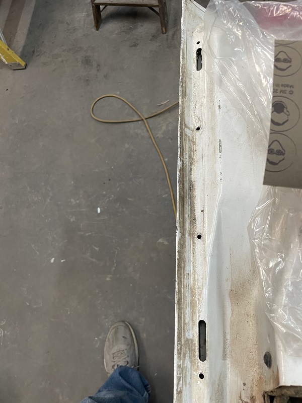

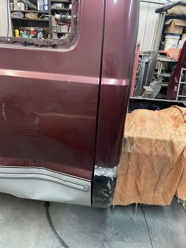

What aggravated me most as got this far was seeing back of cab and front of bed little to no paint,  Were painted together as well the underside of Hood was Painted just base Red not the metallic as was bought.  Had always wondered why so, just lack of concern by Ford as No Care on Quality is Job One no longer exists.
Posted By: steve(ill)
Date Posted: 02 Jan 2024 at 8:38am
Dave... the COULD have done a better job... But you got to remember that its 25 years old !!  Has served you well for that time..

That was a very common practice. Less color and I've seen a tinted undercoat to lessen the needs of a thicker topcoat many times. Red tint under burgundy is very common. Underside of the bed is not painted for the same reason. Underside of the hood panel and radiator support etc. are a dull red color; not topcoat color. All to save money on the production line.

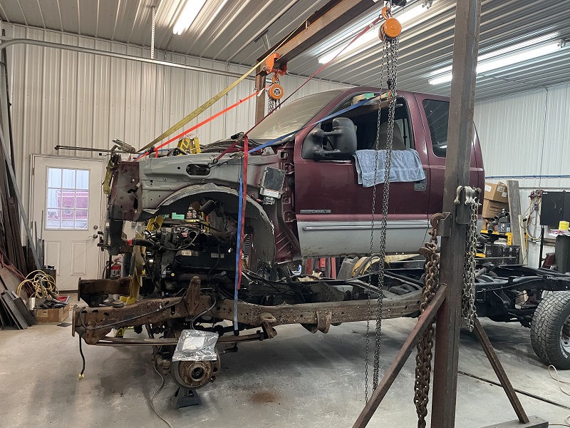

Posted By: DMiller

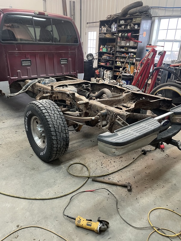

Date Posted: 08 Jan 2024 at 10:11am

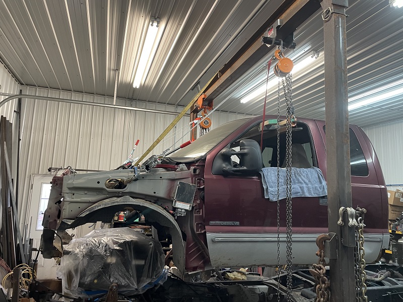

Current state, down to a few items to disconnect then go to cab mount bolts.

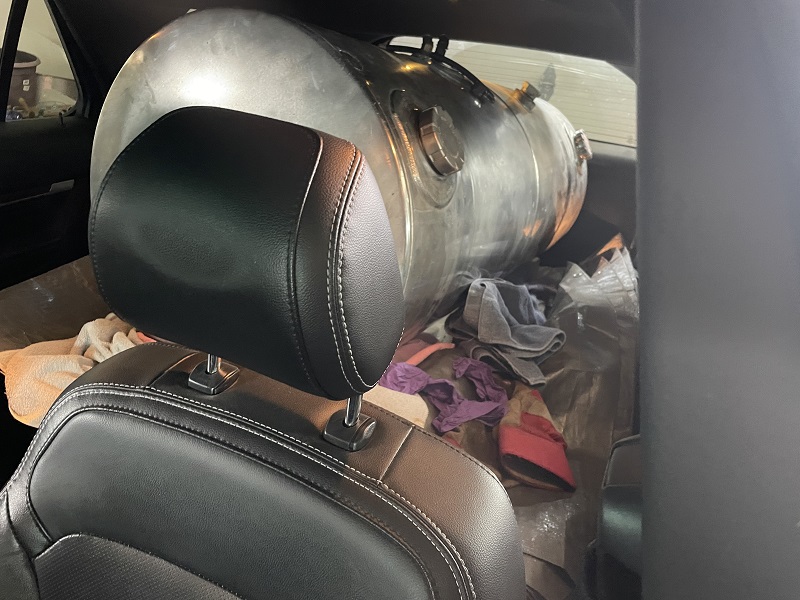

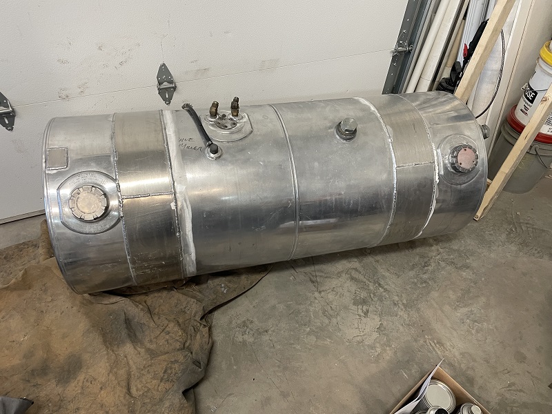

Will be dropping tank today or tomorrow to replace brake tubing behind it and to ready that section of frame for rust encapsulation paint.

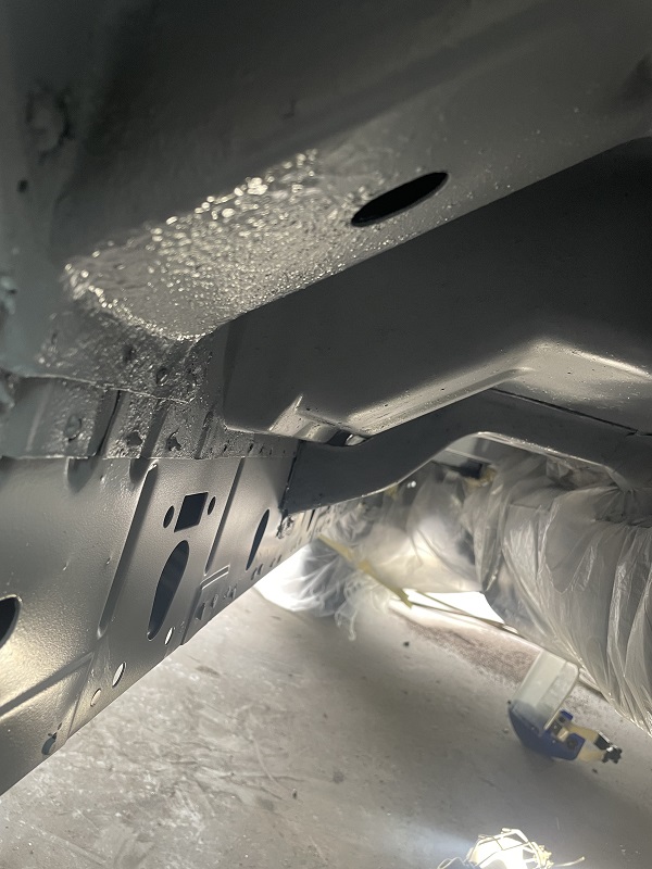

I have tried to wire brush / clean and repaint the frame of a truck a few times.. Paint always started to rust thru in a couple years ... Several years ago i read an article about a DESALT process... They said it dont matter how many times you WASH the bottom of your truck with pressure washer and soap, there is ALWAYS a salt film left over imbedded into the steel frame. That starts the process of rusting again...... DOT in Wisc ( i think) was experimenting with a process to NEUTRALIZE the salt, after washing the frame with pressure washer... Conclusion was that if you do this, the PAINT will stick much better and LONG TERM the frame will hold up better... I have been using this for about 10 years when i do  touchup / paint repairs on the frames... ANYTHING that travels on the highway, has salt IMBEDDED into the steel  that needs cleaned prior to paint............. just a suggestion..

The product I have received is a Encapsulator body men use. Has a rust converter in the base that shuts down the process. Has to be oversprayed with a paint product but is noted to neutralize the process of corrosion. Just have to have the large chunky stuff off the surface.
Posted By: WF owner
Date Posted: 09 Jan 2024 at 6:58am
I have used both Eastwood and POR-15 Rust Encapsulator with good results. I also like Rustoleum's Rust Converter in aerosol cans.
Posted By: Codger
Date Posted: 09 Jan 2024 at 8:21am
I used "Chassis Saver" products a lot of years in the shops and it works well but has a very limited shelf life once opened, and must be painted over. Phosphoric acid based product yielding good coverage per gallon sprayed easily with conventional hand spray guns.
Abrasive media blasting is always best as a clean substrate is beneficial to start with and will reveal weak spots commonly overlooked.

Posted By: DMiller
Date Posted: 09 Jan 2024 at 1:07pm
Thanks all, sticking to scrape, brush and blow away then to paint once eastwood material gets here. Truck is soon to be 25, know is on borrowed days where only needs to get another three to five and I will start backing down on activities.

A needle scaler does a good prep job.
Date Posted: 09 Jan 2024 at 7:00pm
Dave... i use the RUST CONVERTER also.... AFTER i needle gun the frame, then pressure wash, then DESALT wash, then rinse.... then CONVERTER.... Let dry and then paint.. I normally just  use a Brush Rustoleum and i am doing touchup, no bed/ tank / power train removal.
Posted By: DMiller
Date Posted: 11 Jan 2024 at 3:53pm
Spoke to a Eastwood rep this afternoon.  He noted I picked the better choice for where I am going.  Remove any and all loose scale, wash down with a oil/grease remover then paint as can.  Base Product, not the Plus or Platinum is the best choice here for working a Moving Target.  Has a Neutralizer in the Base, for Salts or Chemical agent corrosive, is also UV Resistant the other two do not even as a bigger premium price.  Does NOT require a Top Coat of anything else and should last the remaining life of the machine.  Can be used as a Prep Primer or a Final Cover so works well for me.  Loose scale is already gone at rear, any residual brake fluid or diff oil has been removed.  Will go back over the entire chassis once cab goes up and finish out on forward rails.  Product can be Brush, Roller or Spray applied, got a full gallon.

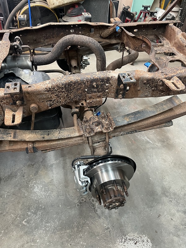

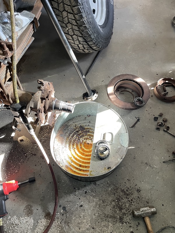

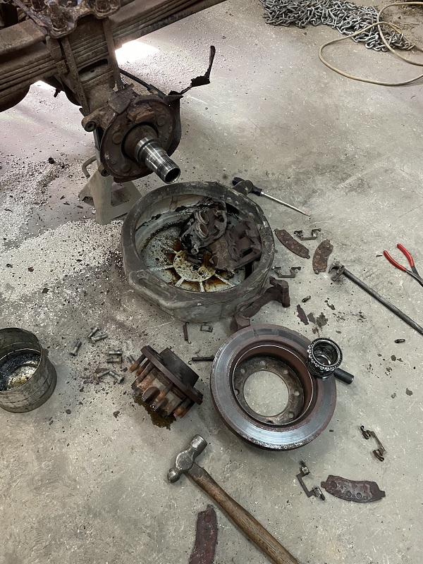

Started removing rear brakes and hubs for P-Brake repairs, pads went to self destruct mode, rotors appear shot, pistons froze SOLID in calipers and as expected Hub Seals leaking.  TOUCHED Dust Shield, collapsed into piles of rust dust.  OH ME OH MY!!  $$$$ Keep Flashing!!

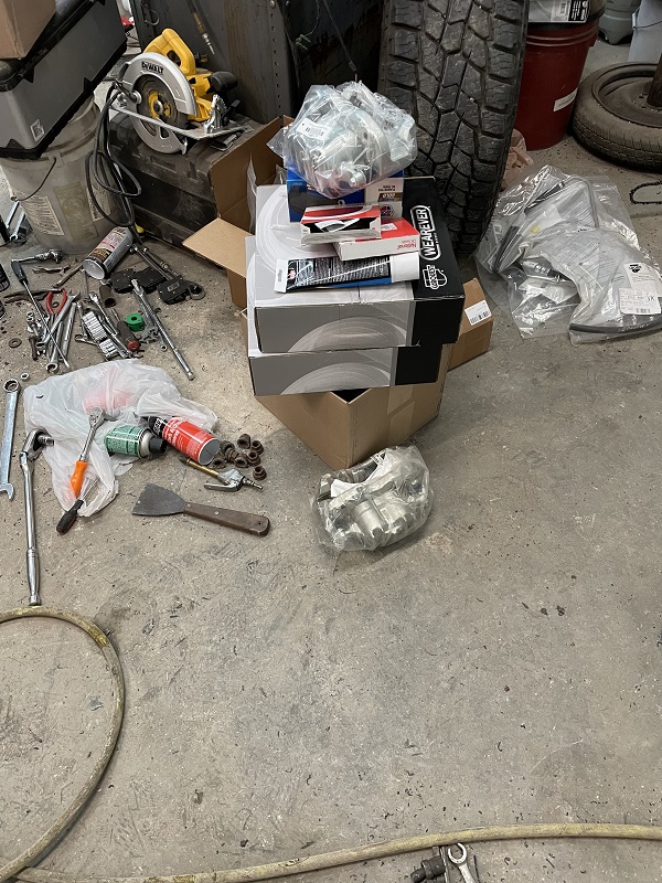

Posted By: DMiller
Date Posted: 19 Jan 2024 at 9:12am
So MORE Bushel Baskets of parts!!  and have loaded backing plates coming.

Rear brake assemblies and hubs back together, Brakes still dry and will be that way until cab is set back down.  Turbo is here but remaining pieces for that may be into Monday next week to arrive.
Will bag the two rear brake/hub assemblies, then ready to paint rear frame section tomorrow. After paint dries, will set next body mounting brackets and reset fuel tank, possibly install rear shocks and rear wheel park brake cables.
Posted By: fjdrill
Date Posted: 25 Jan 2024 at 3:19pm
Are you Shure Brake calipers go on front of axle driver side? All 4 SDs of mine are on the back.
Posted By: DMiller
Date Posted: 25 Jan 2024 at 5:03pm
99 and 2000 SD Fords only ones to do this. Same calper both sides, brake lines significant difference on both, is a heavy shield goes around the Left one. A True oddity to this model and year.

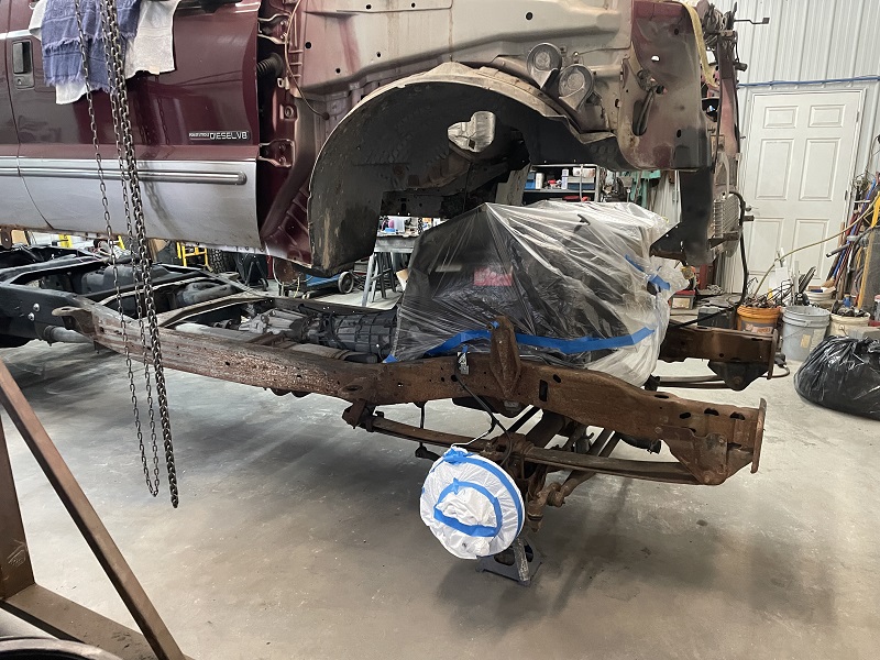

Posted By: DMiller
Date Posted: 28 Jan 2024 at 7:22am
So Far So Good.

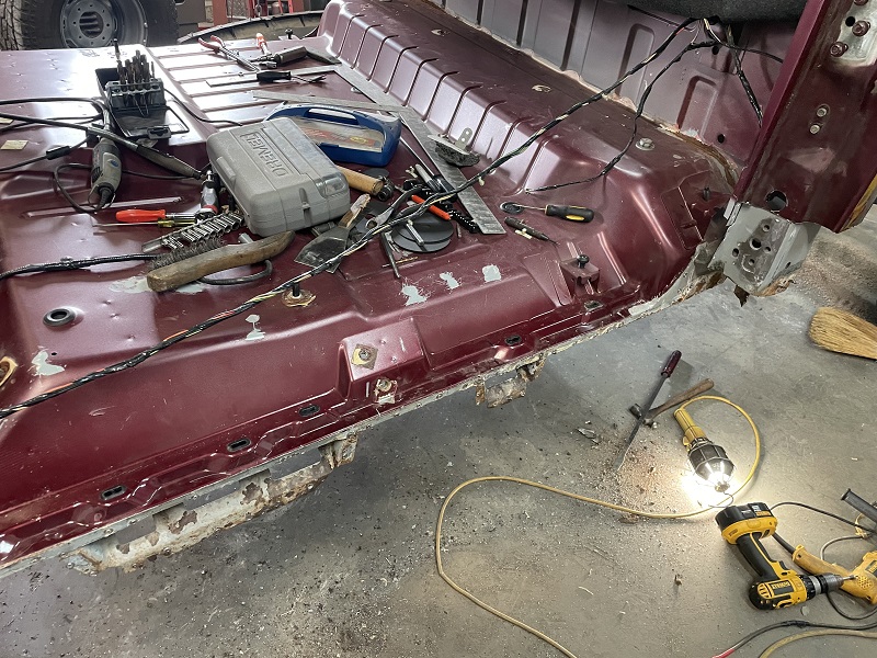

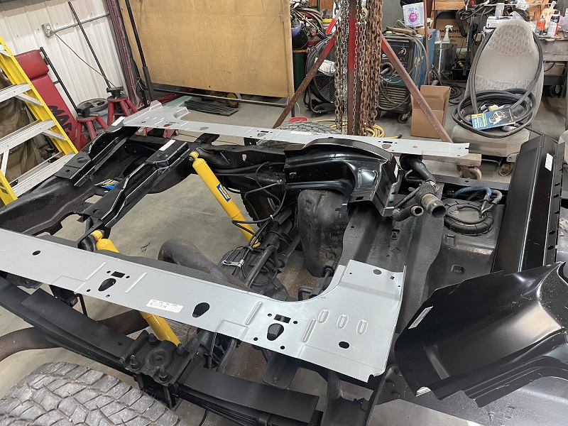

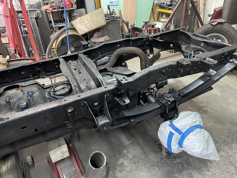

Front Brake hoses on, tubing Connected, old Core Support Mounts cut away removed and frame cleared of loose rust.  Rear Frame was painted with tank rehung, PBrake parts installed and rear axle/brake repairs done down to bleeding, Cab is Up, turbo swapped and awaiting other engine parts to ready to reset the cab.  Have the new mounts ready for that point.   Likely to paint front frame Today.
Posted By: DMiller
Date Posted: 28 Jan 2024 at 7:26am

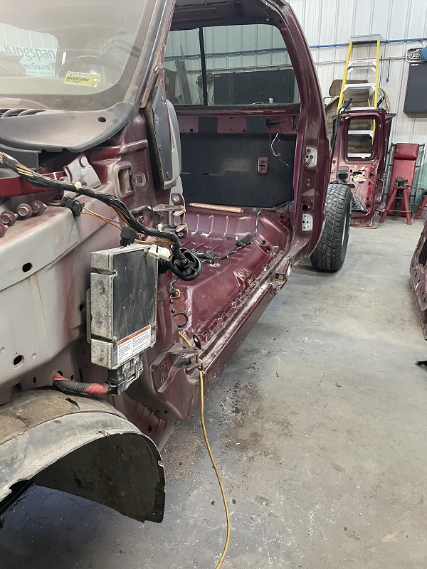

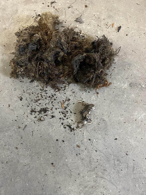

Nastiness ALSO contended with.  Found the source of harness chew ons, cleaned next out of engine valley, where around same amount was sucked up with a Shop Vac.  The Dead Varmint was darn near to mummified as been dead so long.  Materials were chewed away engine compartment insulation.

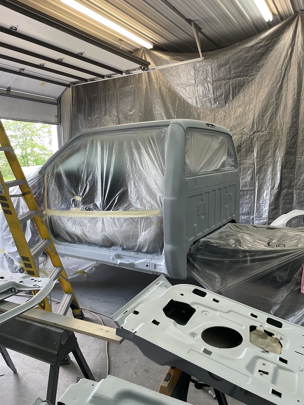

Date Posted: 28 Jan 2024 at 4:46pm

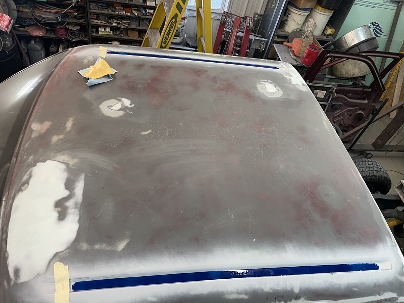

The truck as currently sits, too cold to spray so masked up what want paint off of and cleaned up around it.  Did Change out the ratchet straps to light Comalong winches.

340k on the truck, not going that deep for a now 5000mile a year truck.  Turbo was leaking, brakes needed work, rust needed updating where the old machine is going to be relegated to Farm Chores here out.

So today I lowered the cab back to the frame where it can sit unattended for next two weeks.

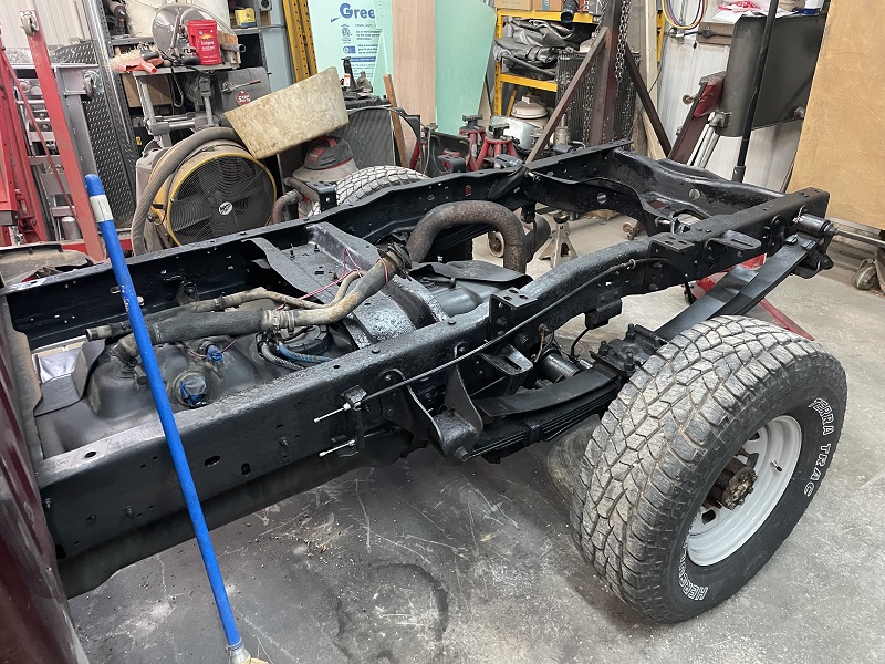

Posted By: DMiller
Date Posted: 08 Feb 2024 at 12:21pm
Received my USPS notice Package is SUPPOSED to arrive Tomorrow.  Will see, likely Saturday.  Has been Floating in USPS Black Hole since 01/24/24.  Wondering if ANY of the order will have survived.

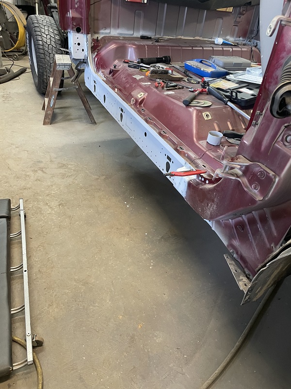

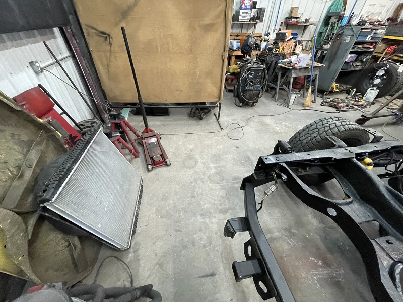

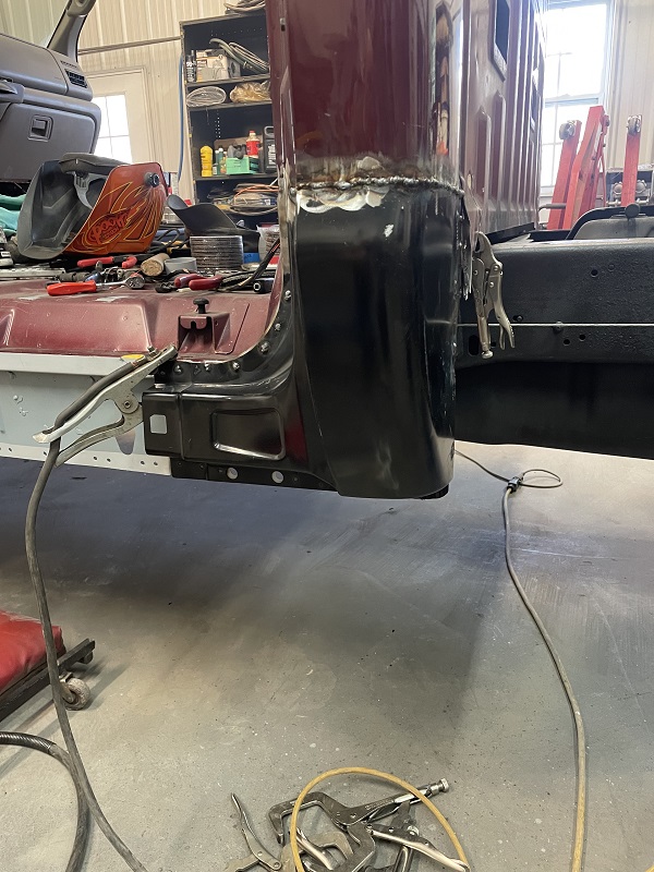

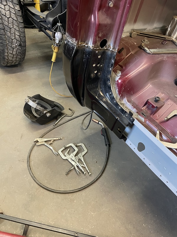

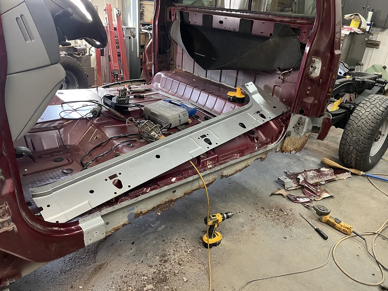

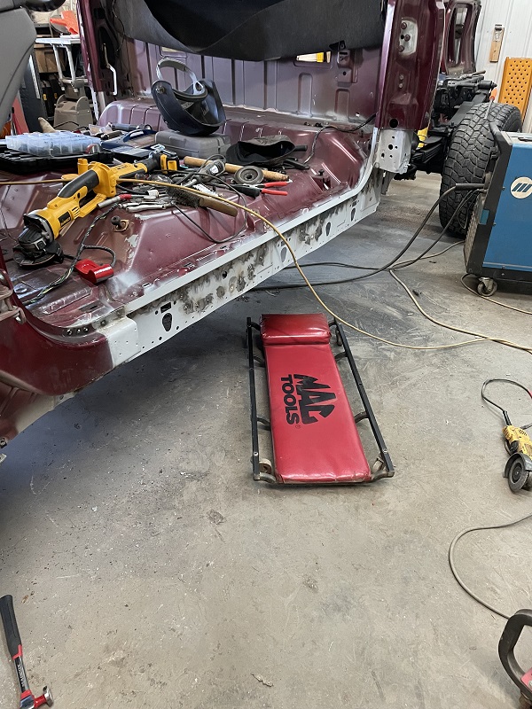

So Completed the Frame Paint, even sprayed rear hitch and reinstalled.    Had sat cab back down but raised back up today.  Had PLENTY of time so cleaned up floor around truck.

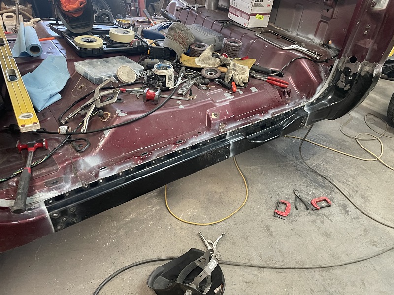

Ordered .023 wire for the Millermatic 210, already have wire rolls and tips, bought a Liner for the lighter wire but been told can get away with heavier liner if not using full time.

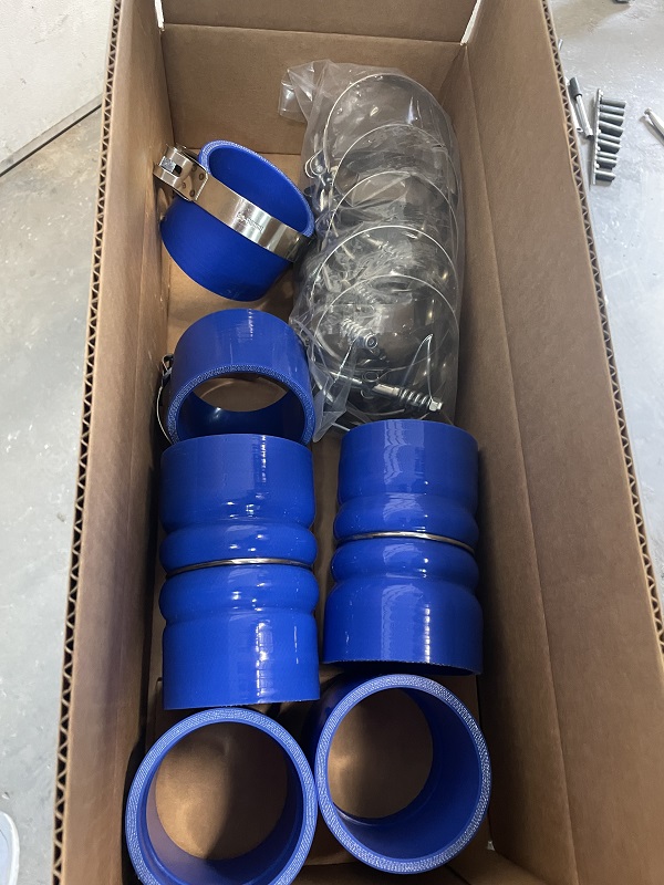

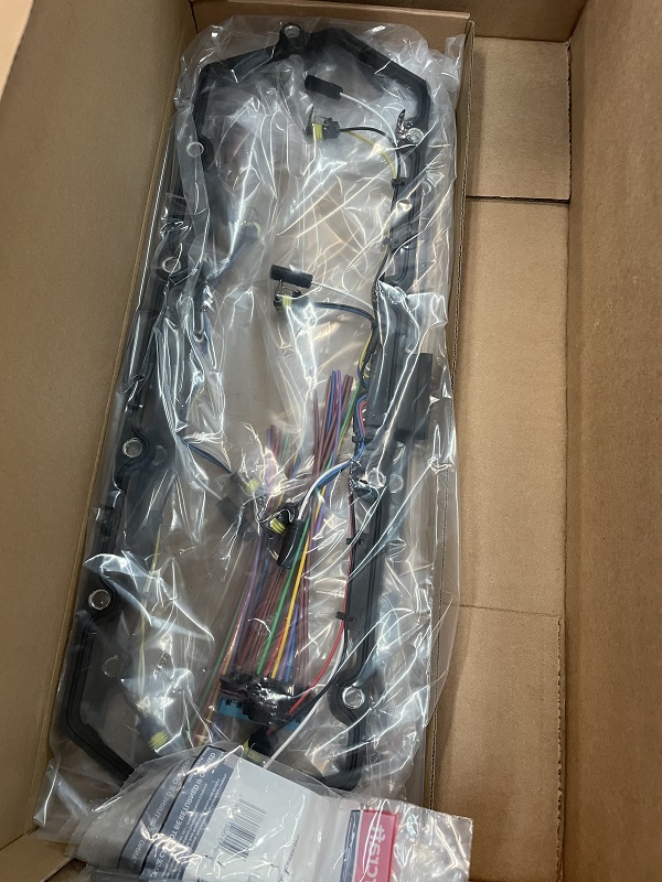

Date Posted: 08 Feb 2024 at 12:30pm

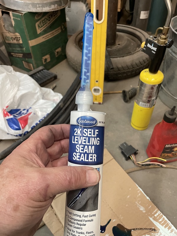

Under VC parts and Intake Boots is what is supposed to arrive.  Covers are still on but bolts already loose, Silicone Boots were leaking on X Piping.  That is Clean and ready to reinstall.
Posted By: DMiller
Date Posted: 09 Feb 2024 at 2:31pm
Almost TOO amazed.  Mail cam parts order in it.  Not ONE Scratch, Dent, or piece of damaged sealing tape, Label as crisp and clear as day was sent.  NO REASON was Not shipped.

Above under covers parts fully installed, Cab is sitting on new mounts but had to stop and take care of Sick Wife.
Seems she had a BAD Week of Training, went to a Local Liquor Slushie Shop, got a tad inebriated and had me come get her.  Three puke stops five miles, had to carwash car today and lysol wipe the inside of passenger door, ICKY.  She is suffering, quietly on the couch currently.Ouch

Boots were a No Go item, too stiff, too thick and too sticky to slip onto the hard housing connections.  Reinstalled OEM for now until figure those out.
That said got brake leaks where were occurring sealed up(MANY), managed to get all the base engine compartment materials set and had engine running today, no leaks to note and turbo spooled into service just fine.  As to the Brake leaks, the New SS Tubing requires a LOT of Brute Crush to get the Double Flares to seat out, got that from my brothers who have also used them.

Into Body stuff now.  Tins arrived

Posted By: DMiller
Date Posted: 21 Feb 2024 at 6:24pm
Have gotten all the rusty panels off the Left side now. Photos I have on the phone just not downloaded yet.
Some dressing work on previous spot welds, and must have been 200 of them on Left side, then predrill new Inner Rocker for MIG welding in place, Weld Thru Primer on as much as can cover then weld it up.  First back on will be fit up and install Corner, then Rear Door threshold, then the Forward Door threshold.  Then move to Right Side repeat.
Guy from Minneapolis deals with Roll Offs and End Dumps called on the KW, gonna come look Monday or Tuesday with his Wife, SHE saw it on Truck Paper. I have No real hopes of a sale, but he is driving 8 hours to come see.

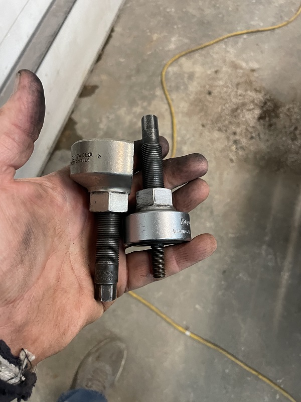

Photos
Having to allow the Slicin and Dicin to heal awhile before slip the arms back in the razor blade barrel.
BOTH arms look as that, snag heaven anywhere near edges.

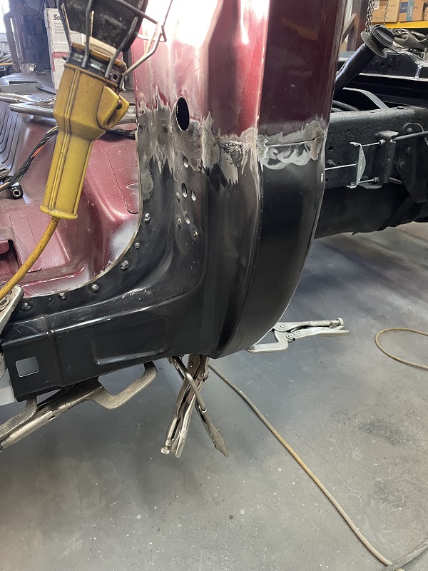

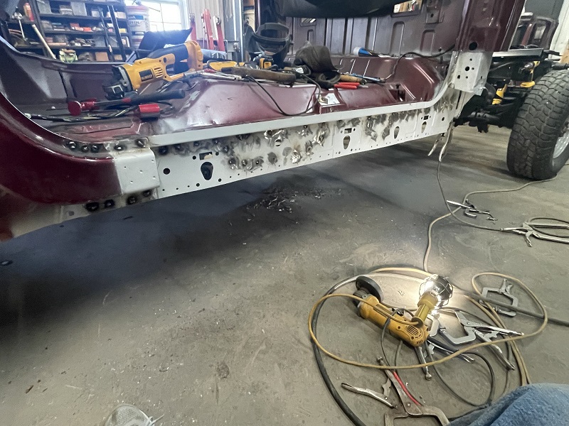

Latest and greatest news is the inner rockers are clamped in place, weld thru primer on them. Getting used to the fast melt of .023 wire is tough but should be welding some time tomorrow

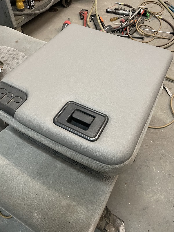

Both New panels fitted up, and did some experimenting with the .023 wire.  My Miller 210 does NOT like it but is welding, have the Left panel sewn in, just have to do some dress down and reprime.  Get the Right one attached and will start hacking up New Corners to fit up.  Still going to fight with the .023 for now, be the LAST time I use in this welding machine.

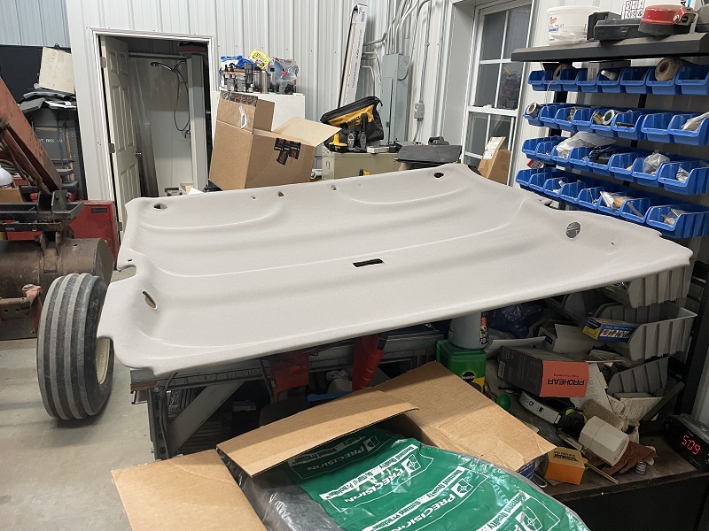

Yesterday the local shop does Upholstery work got my Headliner and Console compartment cover done, they are back home for $360.

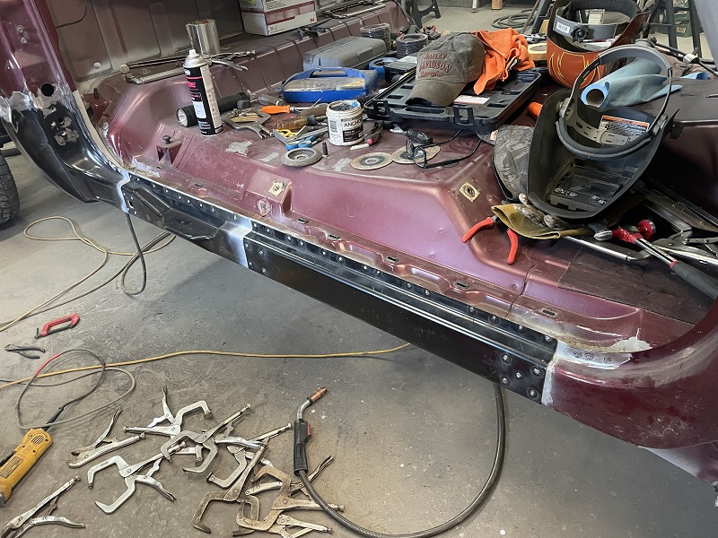

Got after the Inner Rockers, getting better on the ,023 wire in my machine, is a adjustment to use.
Inners are Both sewn on, will need to dress out some then prime over before move to cab corner caps then the outer rockers.
Welds looked FAR better when moved to wearing Cheaters under Hood.

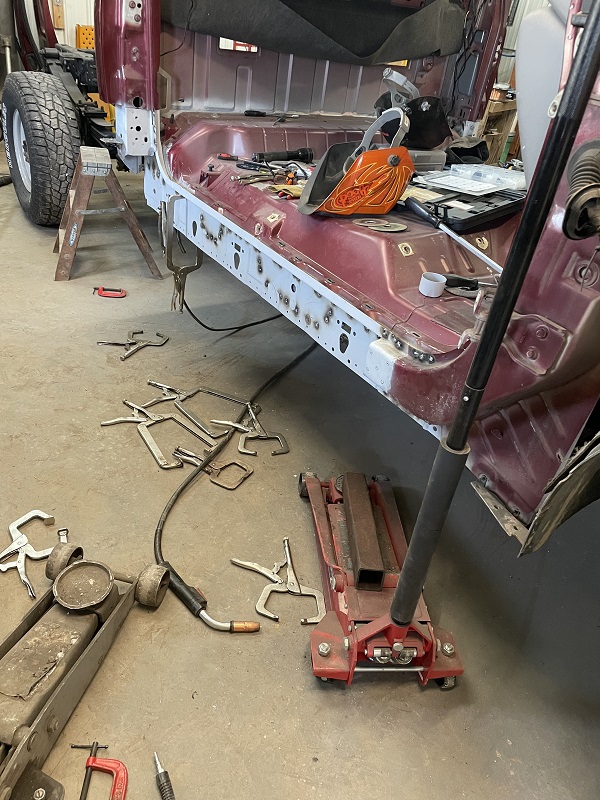

Made a Solid covering of the to be Covered face on the Inner Rockers, left the Weld thru Primer exposed and had masked that off prior to paint.  Have fitted the Left Corner well enough to initiate Weld, so went to the right side, still stretching out the outside rear corner some so do not have to fight in to align.  Once Both are fit up as best I can tolerate will set the first arc, is that no going back moment I dread Most.

BIG Day today. worked up the courage to set the corners, been fussin and floggin on them for three days getting them to fit the way I see needs to.  So today anchored by All manner Clamping Grips, set the two.
Need to dress down welds, have to finish rear of Right Cap but had to attain a replacement Argon/CO2 bottle to continue welding.  Then can add in the Outer Rocker Panels and get to prepping, with plastic cover work of body work and priming.
Posted By: DMiller
Date Posted: 02 Apr 2024 at 6:38pm
Welding is Complete, since photos taken, ground off high spots of pocket welds and started sanding off the peeling material on the roof, working down the cab to self etch filler prime once get all the spot filling done.  Even trial fitted old door to check body lines.
Posted By: DMiller
Date Posted: 02 Apr 2024 at 6:46pm
Can really see the Dent been removed Lower Right Corner, similar done at L Upper.  Have Woven Cookie grinder wheel will be removing the Seam Cover in the two cab channels and replacing with a Two Part hardening flowable self leveling filler as it has pulled away from the cab skin.
Wife none to amused with me as removed that seeping KW fuel tank, took to Car Wash and flushed as much as could remove internally, hauled it to Haslag Welding Krakow MO, 3-5 weeks will be Strapped and bad spots repairs.  Hauled in Her Explorer as the Above truck is a bit out of service!!!
Posted By: DMiller

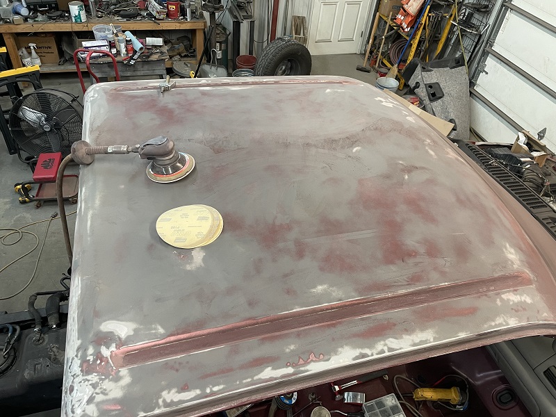

Date Posted: 14 Apr 2024 at 6:26am
Haslag called Friday, tank is completed.  They were quite surprised as I, NOT ONE TIME called to ask of progress and it worked in without concerns.  Is costly yet cheaper than the $1300 replacement fuel tank. $628, will be picking it up if happen to a Rainy day off this week.

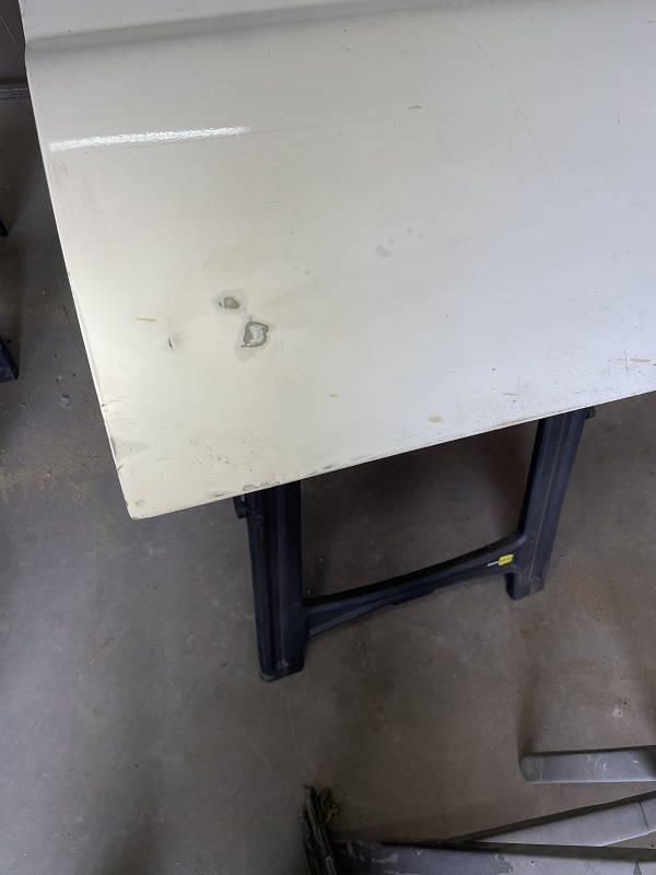

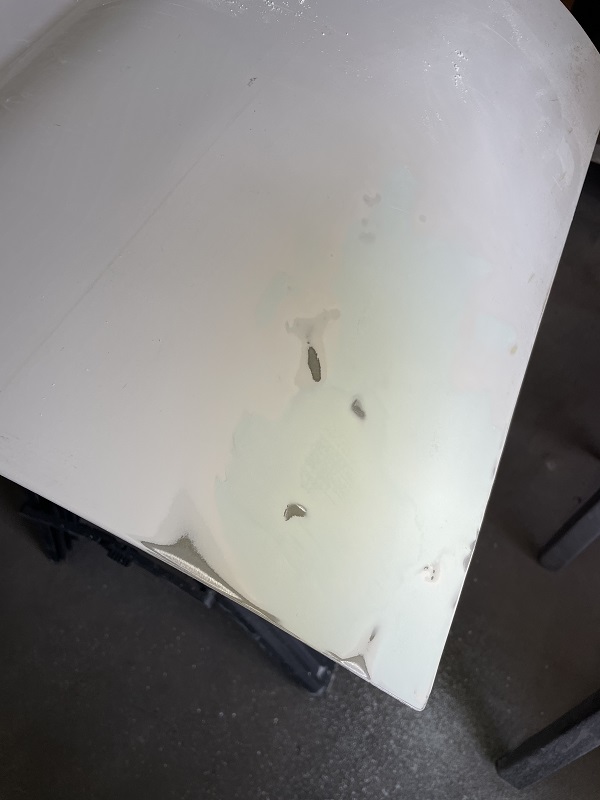

Getting there on Ford Roof, will post a later photo as the Channels have had the Seam Sealant removed and primed for today's activity of replacing that as was pulling away from the roof sheet allowing moisture to corrode the skin.  Body filler work is 99% completed on Cab and R Rr replacement Door.

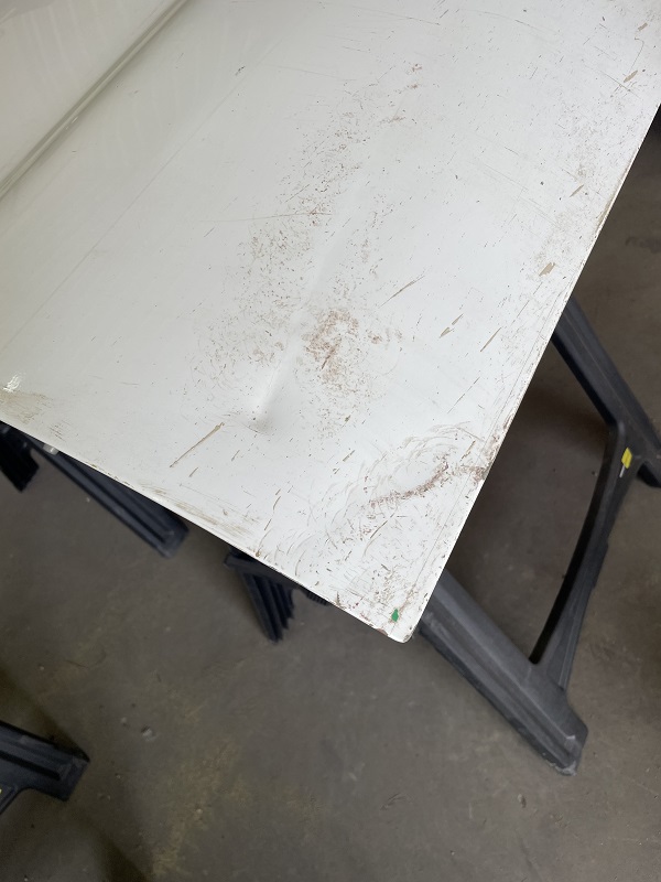

Posted By: DMiller
Date Posted: 14 Apr 2024 at 10:37am
This is Today, Seam Seal on roof, door repair much better, and a photo of the bottom on rear doors.

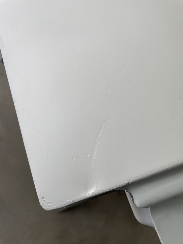

Posted By: DMiller
Date Posted: 14 Apr 2024 at 10:42am
This was the door skin as Lifted the wrinkle and straightened that rolled corner.

Day off Today, back to work tomorrow.  Did get the seeping fuel tank off and to a weld/Fab shop for Strapping and small patches to repair it.  $650 to fix, or $1200 to replace the tank with Like Kind or $900+ to install just a Fuel Tank, this one is split 50/50 Fuel/Hydraulic.  Still have a PTO on the truck, just lacks a Pump and piping.
Sanded the Grinding work and dings Grits: 180, 320, 600, 1000 then ran over the entire tank with a Buffer.  All back Installed.
Posted By: DMiller
Date Posted: 04 May 2024 at 4:27am
Getting down to masking sanding and priming stage. Get a day off as to rains or associated issues unable to work at yard and is a considered Part Time gig so catch up days show up as did yesterday.
Hope to be ready to prime it out tomorrow.

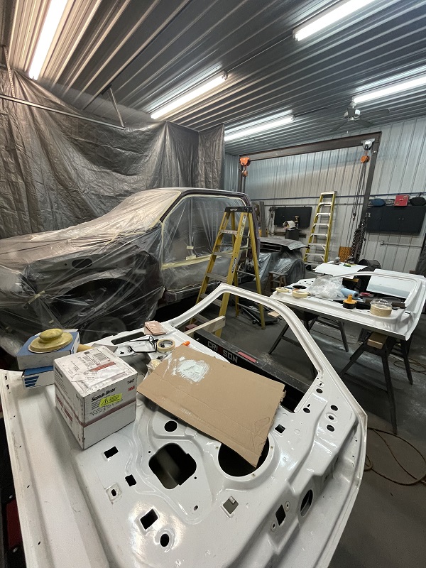

Posted By: DMiller
Date Posted: 04 May 2024 at 6:06pm
Today's results, cab is Masked, the inner rocker attachment welds have been ground down, bottom of cab floor scraped off where will be applying Epoxy Primer tomorrow.  Have my over spray curtains back up, have some sanding on doors, the fenders and 'Shiny' spots on cab to where can apply self etch primer on those.
Providing all looks good after priming, will be ordering paint, returning to the original JM Code Toreador Red Metallic, no gray under panel this time.

Posted By: DMiller
Date Posted: 10 May 2024 at 6:28am
Alright then, You ALL asked for it!!

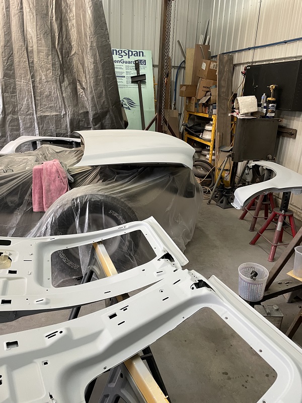

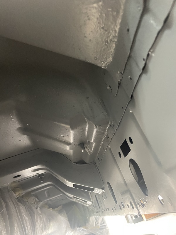

Underside and lower region of cab were sprayed with Epoxy Primer to seal the weld areas and to protect the already surface corroding floor pan.  On the roof, all four doors the hood and fenders was recommended I use a Self Etching primer undercoat as the original finish had corrupted so deep and so badly had to nearly strip to bare metal, especially the hood.  Once that had contact dried(about 20 minutes) sprayed a second primer coat of what Shop Line (PPG) calls 2K Heavy Build as it presents a Heavier applied finish for a final sand.  Requires a Sanding prior to paint overlay.    So next step is W/D 500 gr on general areas, a quick dry sand on those areas as Hood and Roof where the material spattered on spray then back to 500 W/D.  ALL these primers are urethane Epoxy two part and a Bear to get applied before starts setting up.  I was only mixing 18-20oz and shooting from a 24oz DeKups system on my HVLP gun.
In places on the Floor pan to Cab Pillar rocker and outer rocker with cross members are four panels welded into the assembly.
Fenders are like handling tinfoil, the doors are clumsy and tough to deal with on horses but was only choice for me.  One damn rear door slipped on the horses and hit the floor with a corner where had to stop, straighten that corner up and yesterday sanded then filled that spot, made me so very unhappy!!!  When ordered paint also ordered additional 2K primer so can touch up that and a few other 'Spots'.  ALL the panels on the truck seem 'Soft' and 'tender' as to slight impact dent-able.
