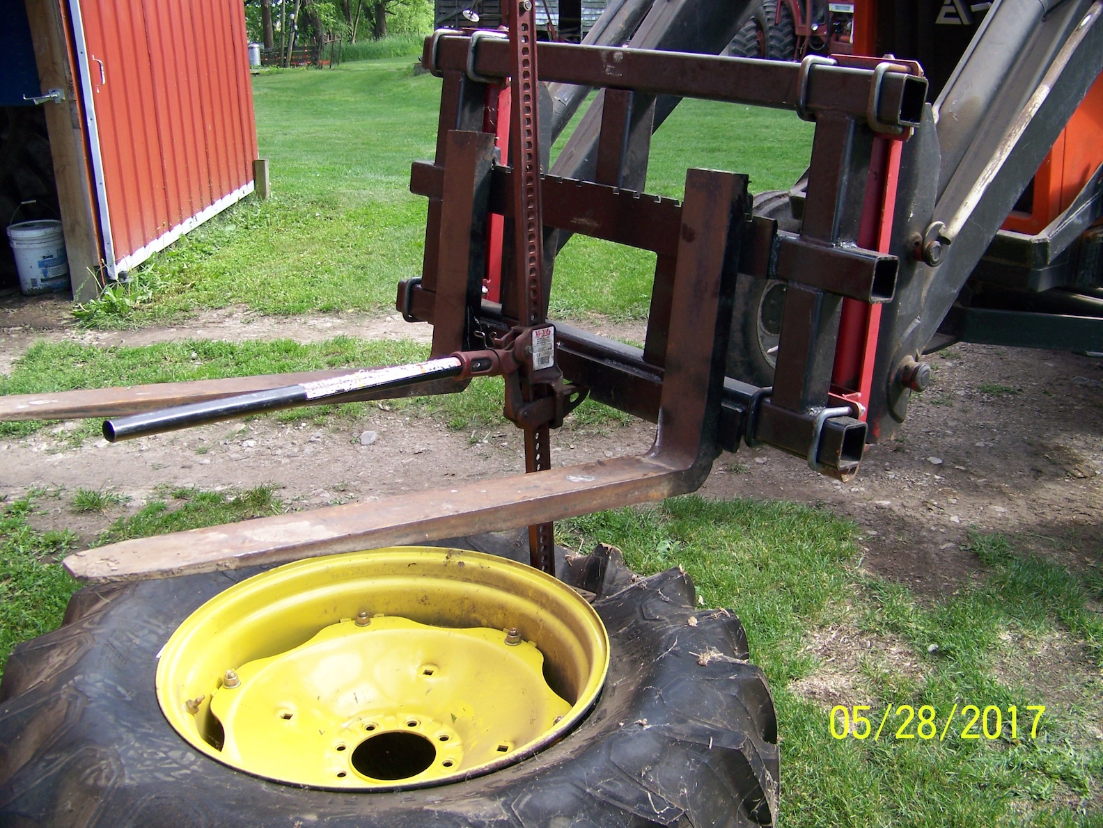

Over the many years of antique tractor fixin, I've saved many a pretty rough inside of a rear rim with 2 or three layers of duct tape wrapped around the wheel to protect the tube from rubbing damage (after a heavy electric wire brushing off the scale/rust). Now, none of mine were ever a "working" tractor and no fluid, but if the rim looked pretty good on the outside, I seldom threw it away from inside pittting. Duct tape to the rescue !!!
dr allis has been watching too much Red Green
Posted By: jaybmiller
Date Posted: 22 Dec 2023 at 1:46pm
neat way to break the bead...
course if I try it, I'll left the dang tractor off the ground.....
then it'll roll back, jack comes off, flies at just under Mach3.4 and I'll be the 'headless wonder'.......
and tire will STILL be on the rim

I borrowed a bead breaker from a friend and it works well. Clamps onto the rim and you tighten both the clamping arm, and foot nut forcing a shoe down onto the tire bead. This one is Harbor Freight but works surprisingly well:
https://www.harborfreight.com/manual-bead-breaker-58918.html" rel="nofollow - https://www.harborfreight.com/manual-bead-breaker-58918.html
You may think an impact would be faster and it may well be but not needed or you'll lose the control this offers as the pressure is applied.
That's All Folks!

What I’ll do is use the loader bucket to break beads…
Works with most all tractors tires…

I broke a lot of beads with the 6080 and handyman jack! Works pretty good really. Last summer I bought one of the screw type breakers because it was the only way I could get the tires off my 'H'. Long story. They do recommend you don't use an impact on them because it will shear the roll pin that holds the nut to the screw. I use a DeWalt ratchet. Kind of wish I'd have bought it years ago, really handy!

Got a new pair of rims ordered in several years ago but never picked up. Makes for a nice Christmas gift from the implement dealer I help out so this chapter is closed.
Thanks to the parties responding to help me out with used rims. I really like this tractor and plan to keep it the rest of my days passing it to family when I'm done. It does what I need, when I need, so nothing fancier is required.
