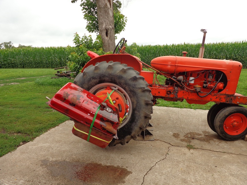

I would echo the thoughts on cleaning the tank. I would add that in MY case it wasn't always enough. When I did the tank on WD 'Grandpa', I employed electrolysis to get the rust off. It did this well. However, after power washing and re-installation, the rust just kept on coming. Short story, I installed an inline filter. Made the impression on me to the point every one that came home got an inline for several tractors before I gave that up.
Enter the 756, this thing sat for who knows how long. I got it with a stuck engine. Knew the tank was going to need some attention before I had a usable tractor. Strapped it to the wheel on the NF 45 for a good tumble. Well, must not have tumbled it long enough. Probably did except there is a partition in this tank. The 'media' didn't get on the one side to scrub it that well. End result, I'm fighting rust getting in the carb again! Really didn't want to cut the fuel line for a filter but eventually did.
