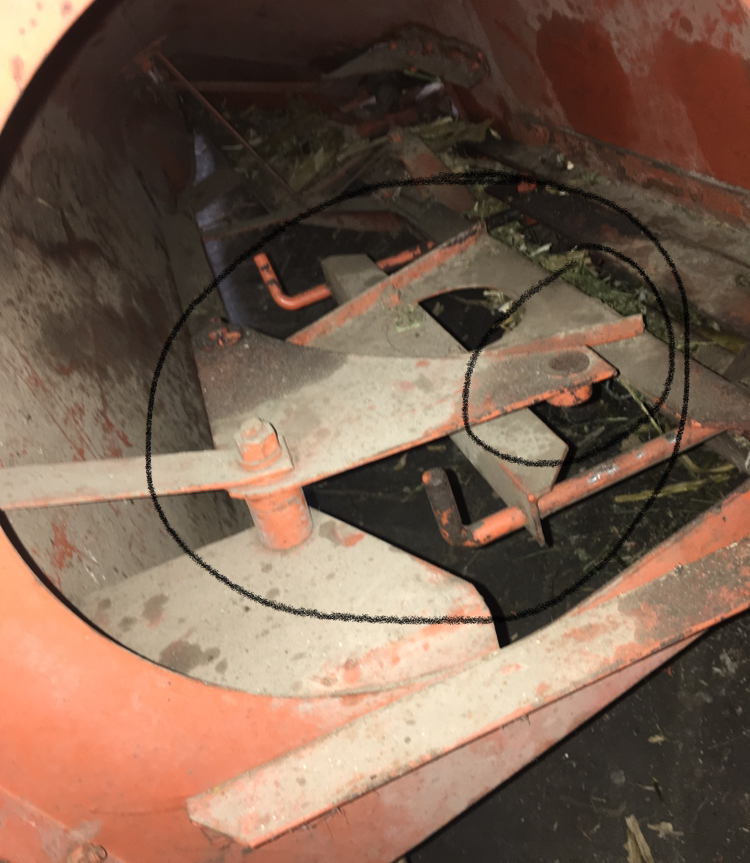

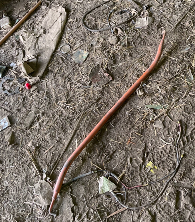

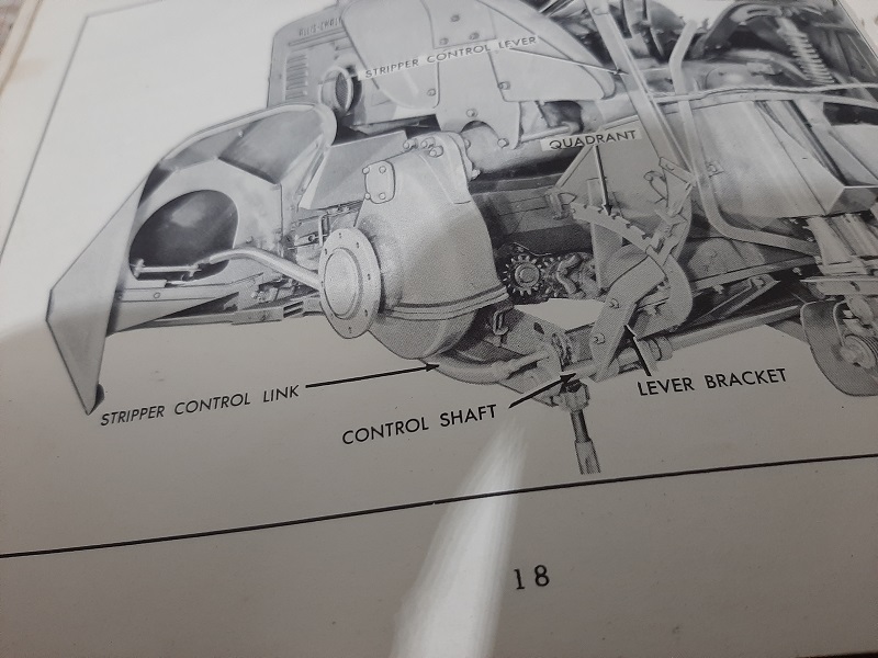

Well I found out that the stripper plates are adjustable from the seat, the lever on the left side I think is the one.
The rods that go to them are gone so I was wondering if anyone would have a picture of them?
Posted By: Kenny L.
Date Posted: 13 Oct 2021 at 11:21pm
55allis I'll try to remember to take same pictures of my tomorrow when I'm out in the shed
Posted By: Kenny L.
Date Posted: 13 Oct 2021 at 11:38pm
Posted By: 55allis
Date Posted: 14 Oct 2021 at 6:54pm
Thanks Kenny!!!
Well my brother was at the place where it sat and he found one of the rods, I’m sure the second one is somewhere around there
