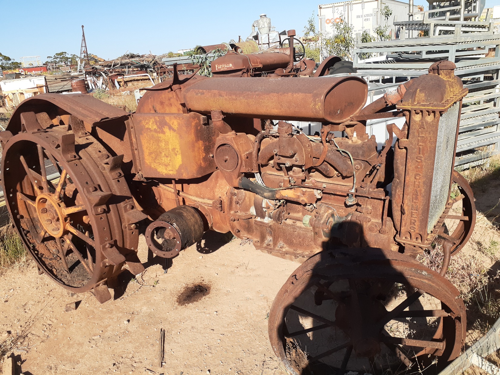

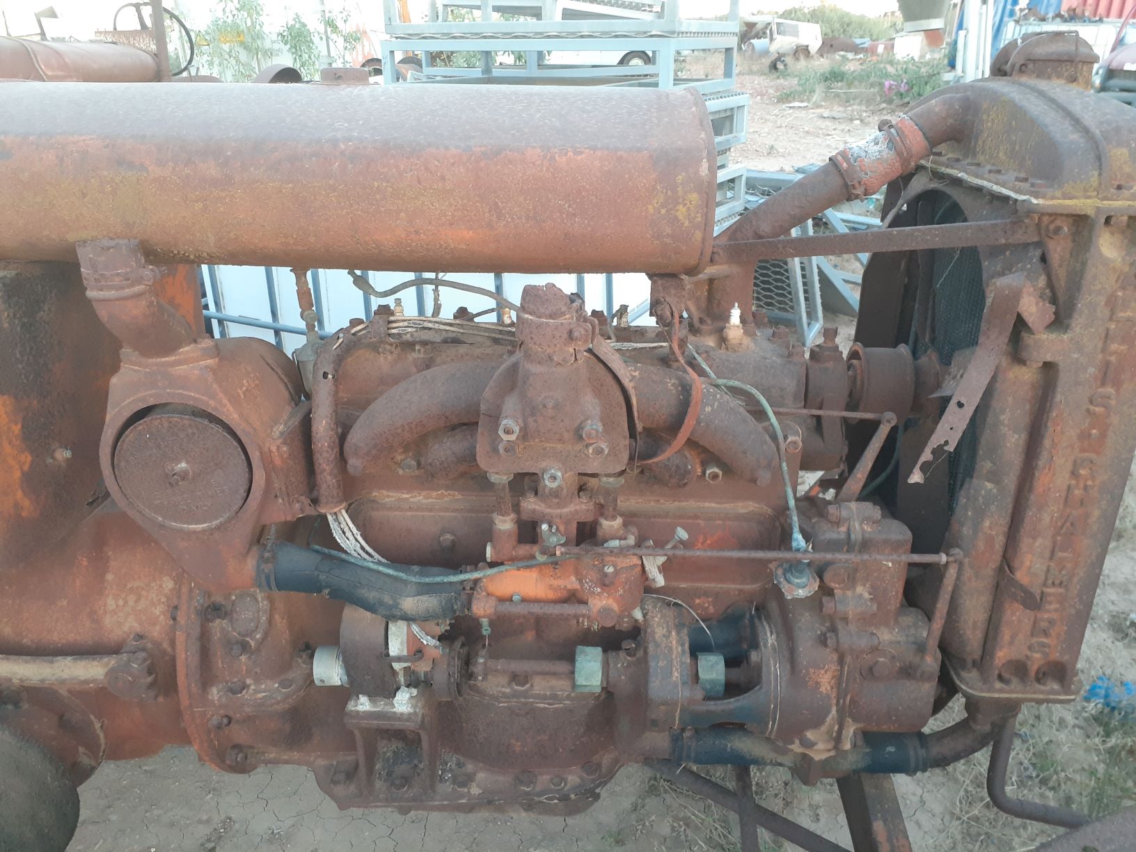

I’ve been offered up a United in real rough condition here in Australia. Were all pre 1932 U’s built with United radiator top tanks?
The machine I am looking at was a running tractor offered to a museum many years ago and has since been left outside for years. The current owner obtained it from the museum as he was sick of seeing it rotting away. No real progress has been made so this is where I am looking at stepping in.

Not all of the Continental Us had United on the tank - it seems to depend what dealer network they were sold through. United seems to have dissolved sometime in 1930, so the later ones were all A-C. Naturally, over the last 90 years or so, the radiator tanks have been swapped both directions as needed.

Posted By: JPG AUSTRALIA
Date Posted: 27 Apr 2021 at 5:16pm
Core looks good

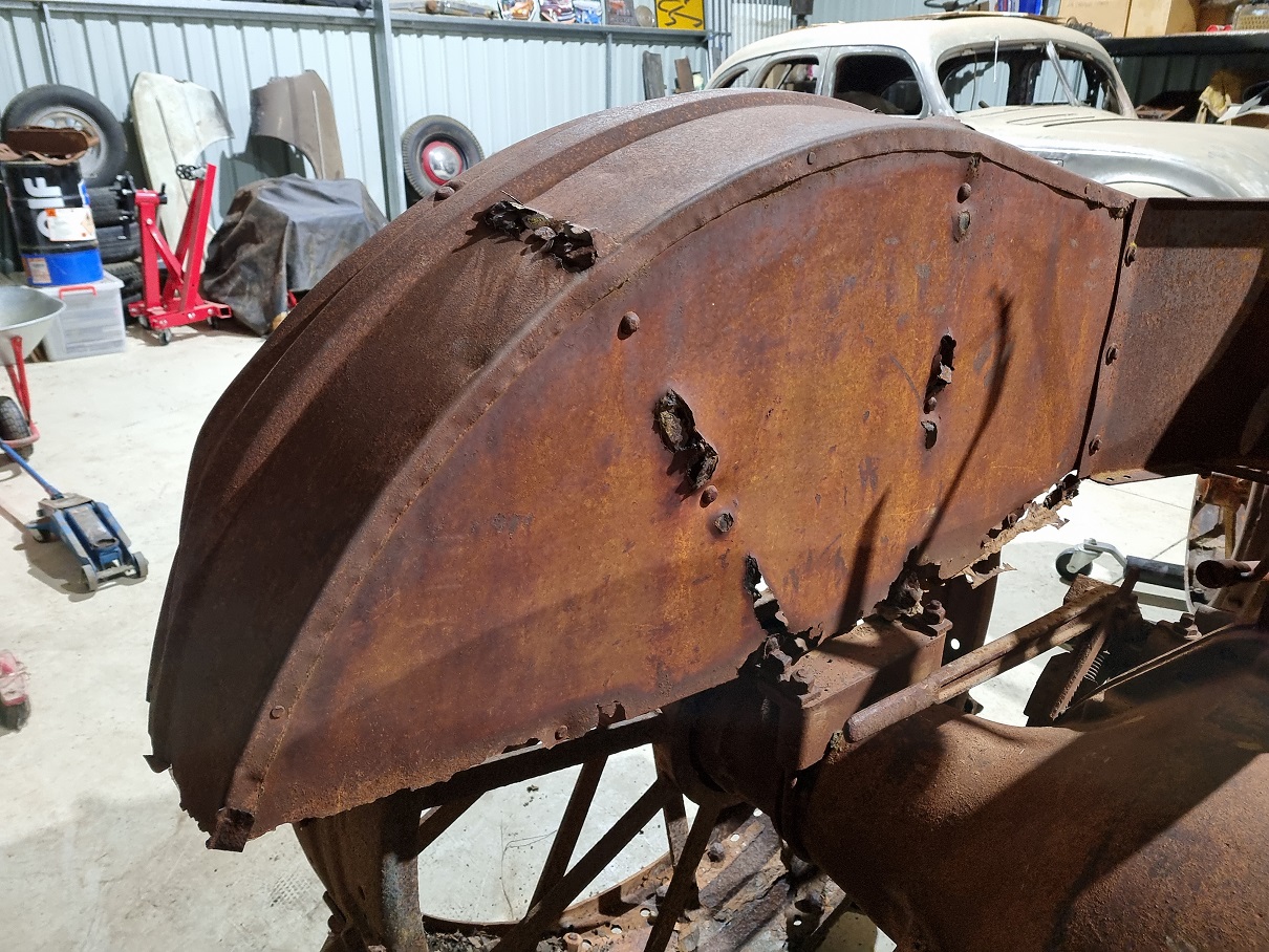

Looking at the sheetmetal, that Tractor for its age and being outside is pretty darn straight! The gas tank doesn't look to have a dent or gouge in it!  Looks like just a lot of surface rust that would either sand off or glassbead off okay.  Radiator looks pretty sweet to. No damage. Amazing for how old it is, and being in what looks like a scrap yard! Good luck with it. Looks like a great project Tractor with a lot going for it.

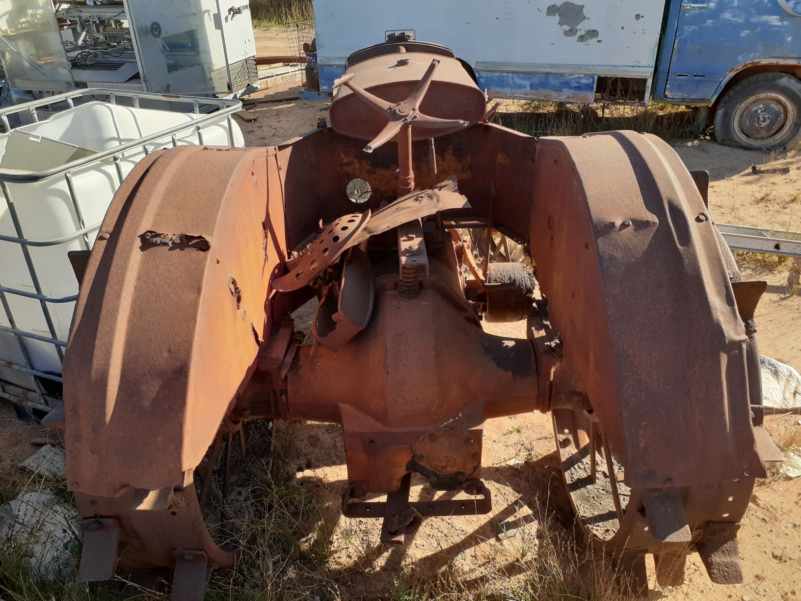

Posted By: 34 Airflow
Date Posted: 28 Apr 2021 at 10:13pm
Yeah hoping this isn't going to be too bad, the Magneto looks toast and a few other bolt on items look sad but the bulk of it looks good.

Posted By: JC-WI
Date Posted: 29 Apr 2021 at 9:45pm
I imagine that there were nothing covering the intake and exhaust somewhere during it's life.Hope there were a drain hole so water would run out before running into the main manifold. Good Luck.  It will look sweet along side your A.

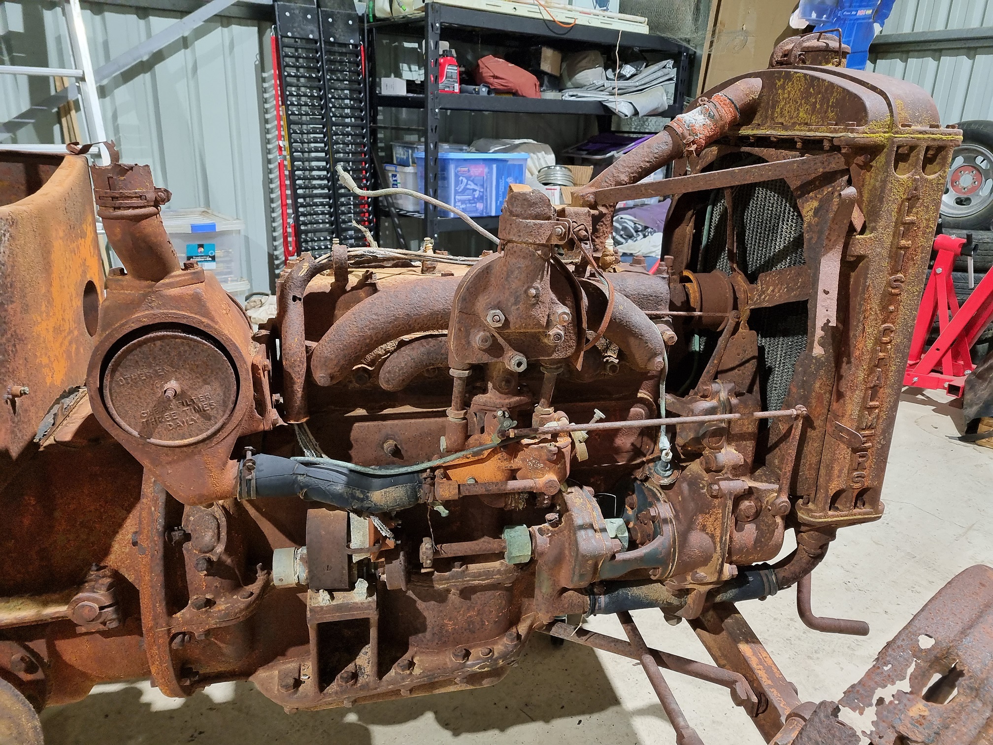

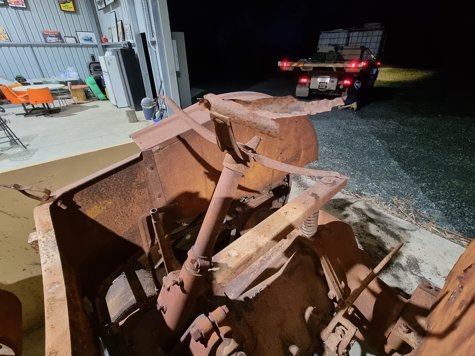

I am baffled at the carburetor and manifold. Kerosene? Regular Petrol? Or LPG (Liquid Petroleum Gas).
Looks different than the Kingston on mine.

I am assuming Kerosene as most tractors sold here in the era were to suit kerosene.

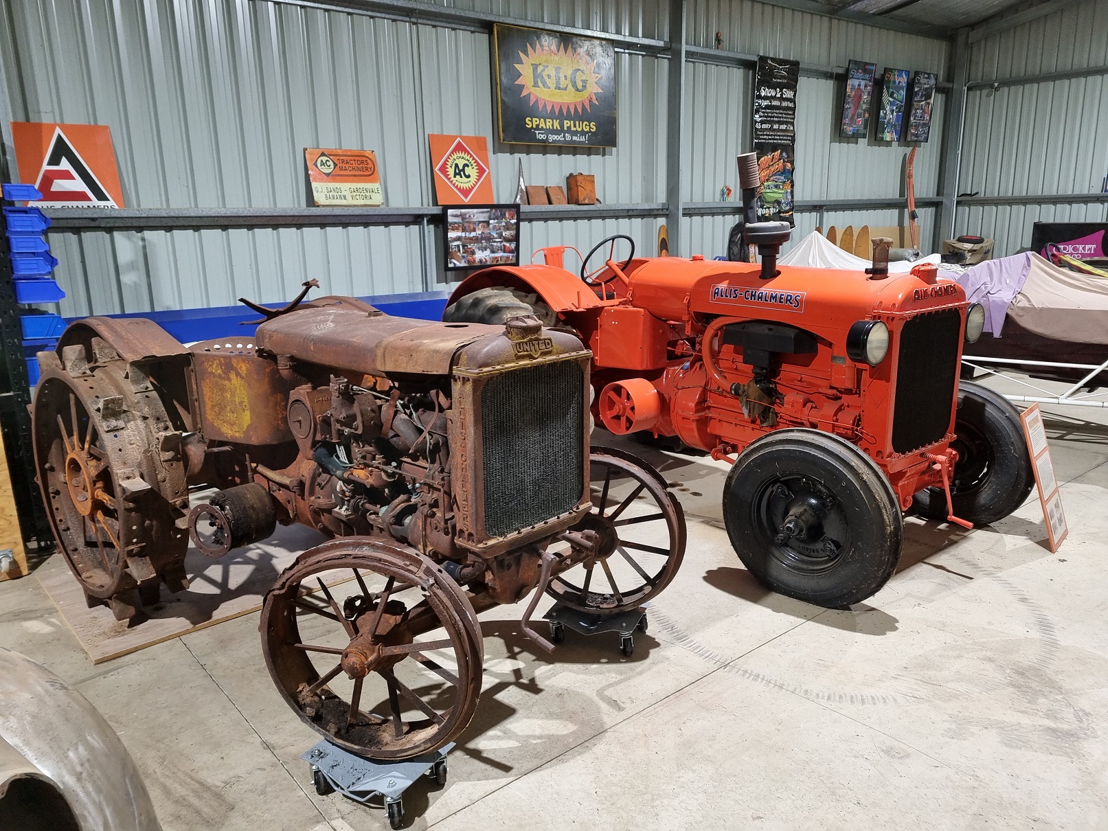

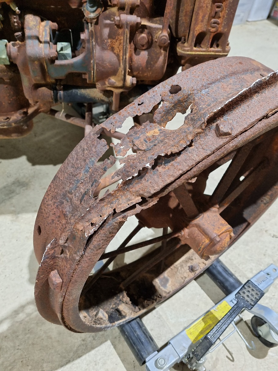

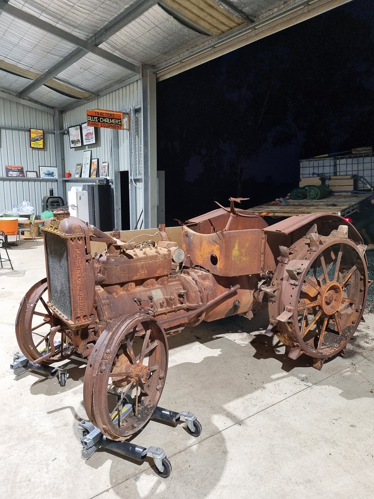

Date Posted: 11 Jul 2021 at 8:25pm

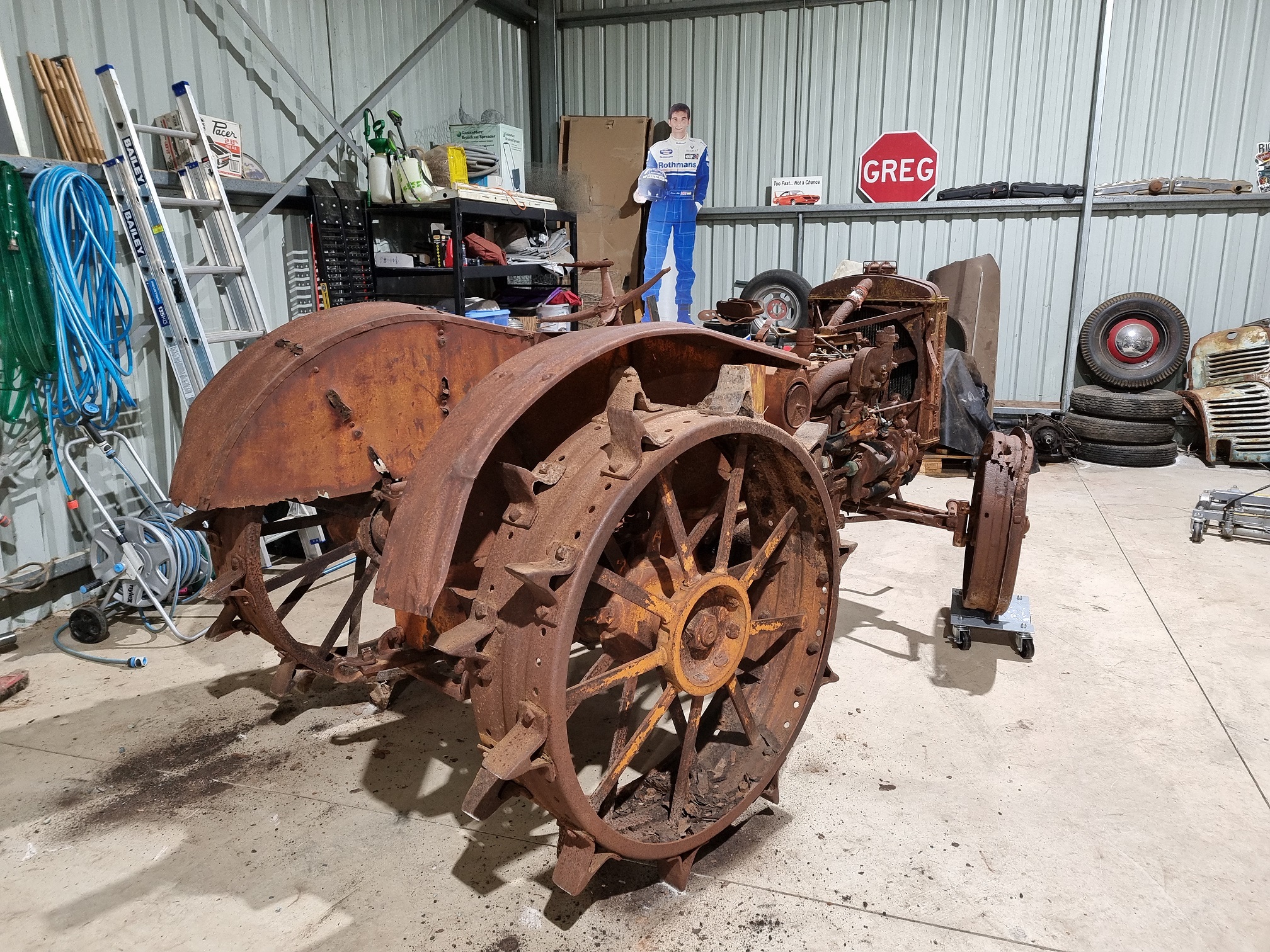

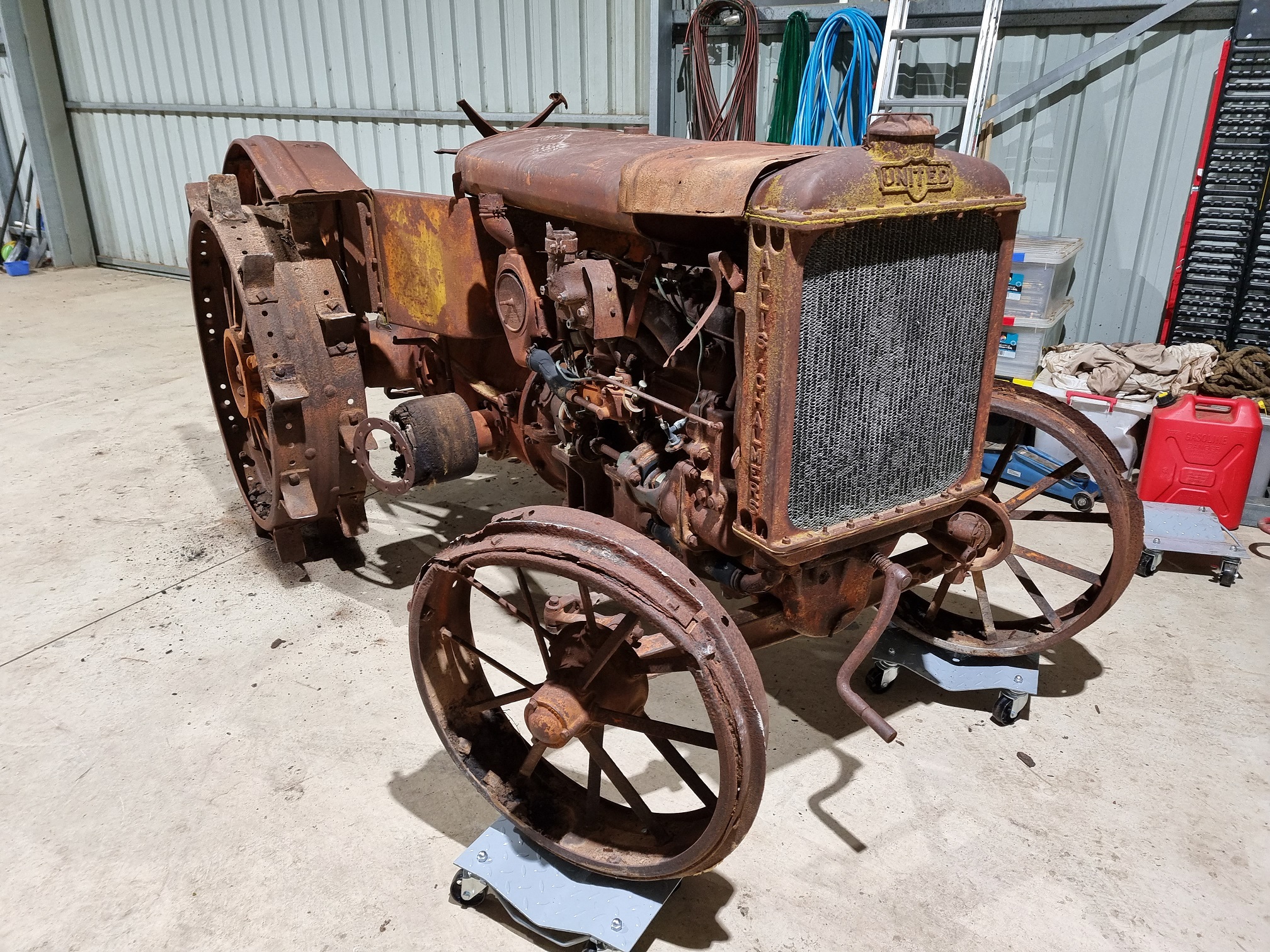

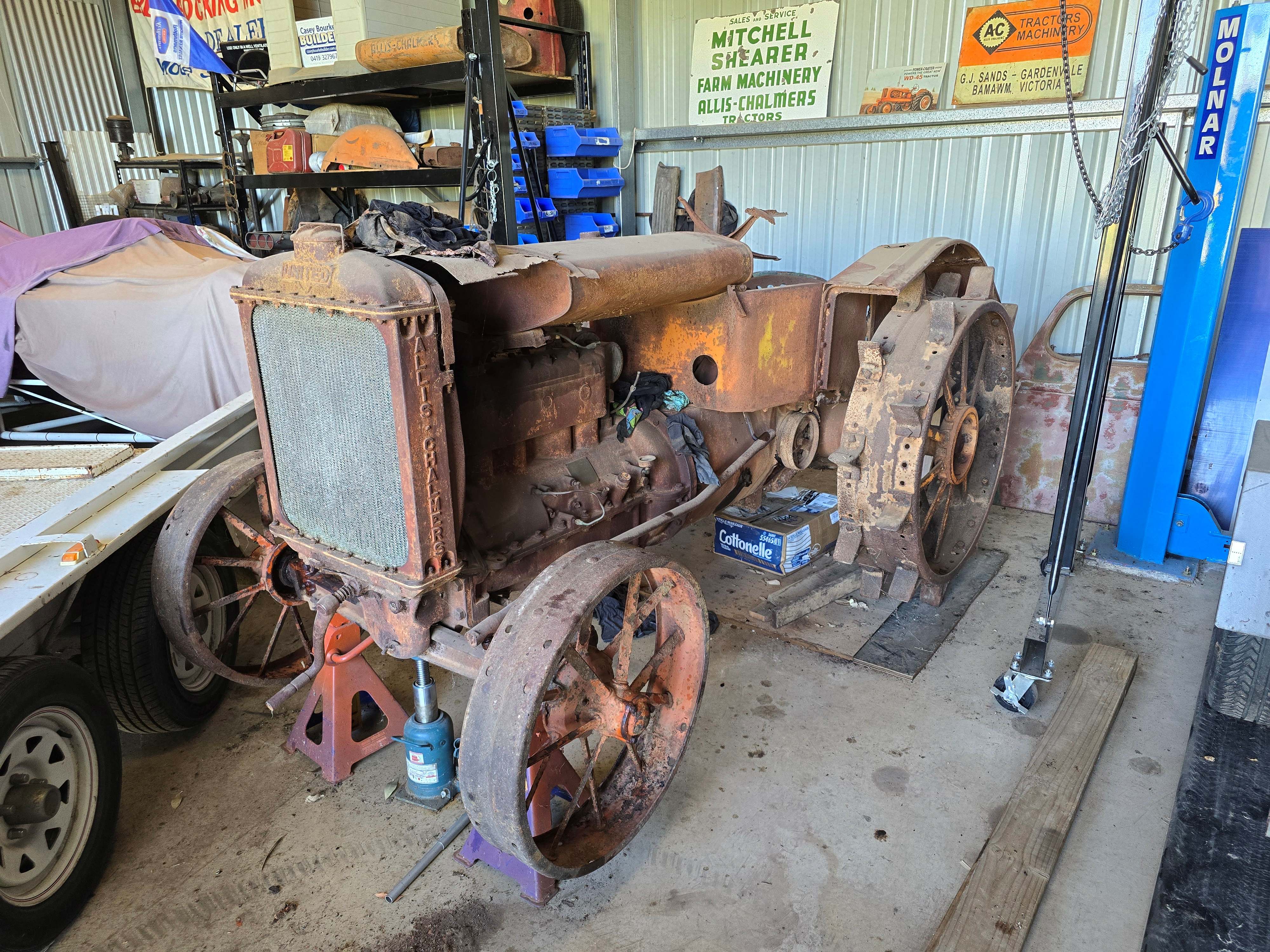

Well the United arrived home last night and it is a BIG project, lots of rust and some items I thought Ok were not. I still feel it is better than becoming someone's garden ornament. The fuel tank is full of straw so I assume some rodents living inside which has also caused plenty of rust. The front wheels are worse than first thought with the right hand front rusted right through even claiming a spoke and the left hand one being quite thin. The steering wheel outer rim is gone, bonnet is paper thin and the starter tank is a template only.  I will get some more photos over the coming days but I am already making as list of items needed. This is all before we look inside the mechanicals!
1937 Model A, 1937 Model U, 1929 United, 1945 Model C, 1949 WF, 1948 WC, 1956 D272 and a Roto Baler

Posted By: HD6GTOM
Date Posted: 11 Jul 2021 at 8:45pm
Love your pictures. I have seen 1 far worse than that restored. Yes it took cash and a good machinist back in the early 1990's. Go for it. Your probably not going to get a chance to restore another in your lifetime.
Posted By: Wispitfiremike
Date Posted: 11 Jul 2021 at 9:46pm
Please keep us posted on your progress, so cool to see someone with the same bug we seem to have jump in the deep end with a project like that and so far from as much support as well.
Posted By: Unit3
Date Posted: 11 Jul 2021 at 10:00pm
What a rare bird this is! You do not see radiators with castings like that.

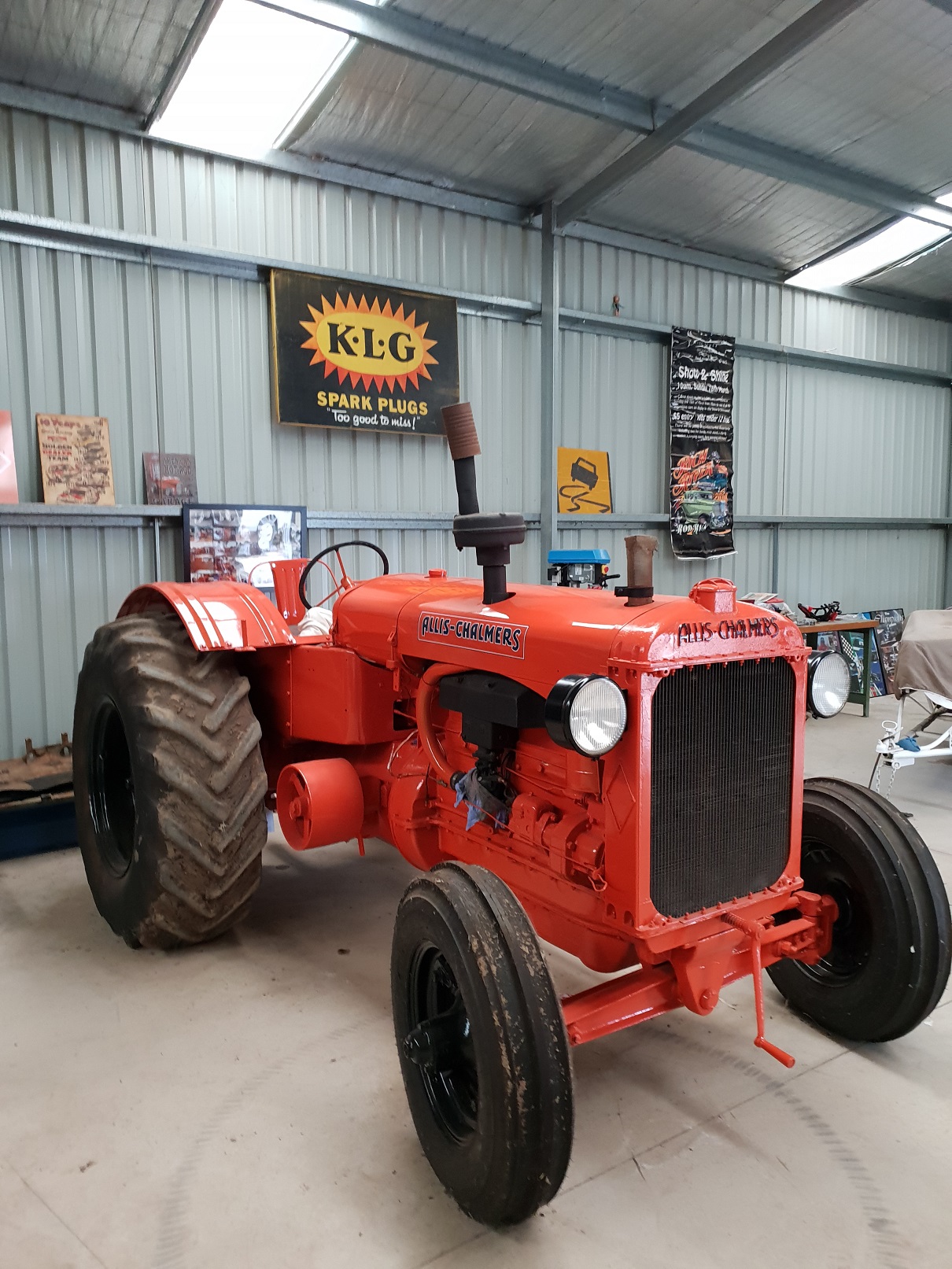

  Just have to ask, is there a chance you might post a pic of Grandma's "A"?
Date Posted: 11 Jul 2021 at 10:05pm
I will dig one out from a few weeks ago. This weekend I will get the United turned around and get a good shot of the two extremes of my collectionWink

That manifold is very rare, have only seen one other like it on a U, and it is in Nebraska.

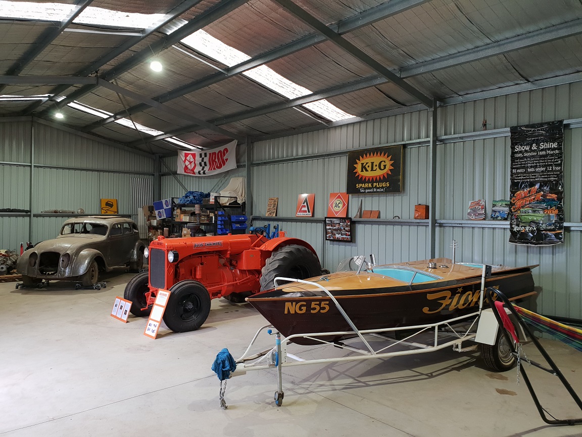

Posted By: ac hunter
Date Posted: 14 Jul 2021 at 8:09am
     Very nice looking A, bet you enjoy it a lot.  Hope you keep us up to date on the United restoration now that you have our attention. Seems you have at least a couple of rare items on that tractor.
     I see in the background of a couple of  your pictures some AC orange chairs and an unusual, at least to us here in the US, looking automobile. Looks like you may be working on that too. Can you tell us what it is?  It's more efficient to have more than one project at a time you know.
     Thanks for the pictures, Russell.
Posted By: john(MI)
Date Posted: 14 Jul 2021 at 10:01am
I'm guessing that the car is a Jaguar.  I notice your boat has the steering wheel on the wrong side.LOL  Is that an import?

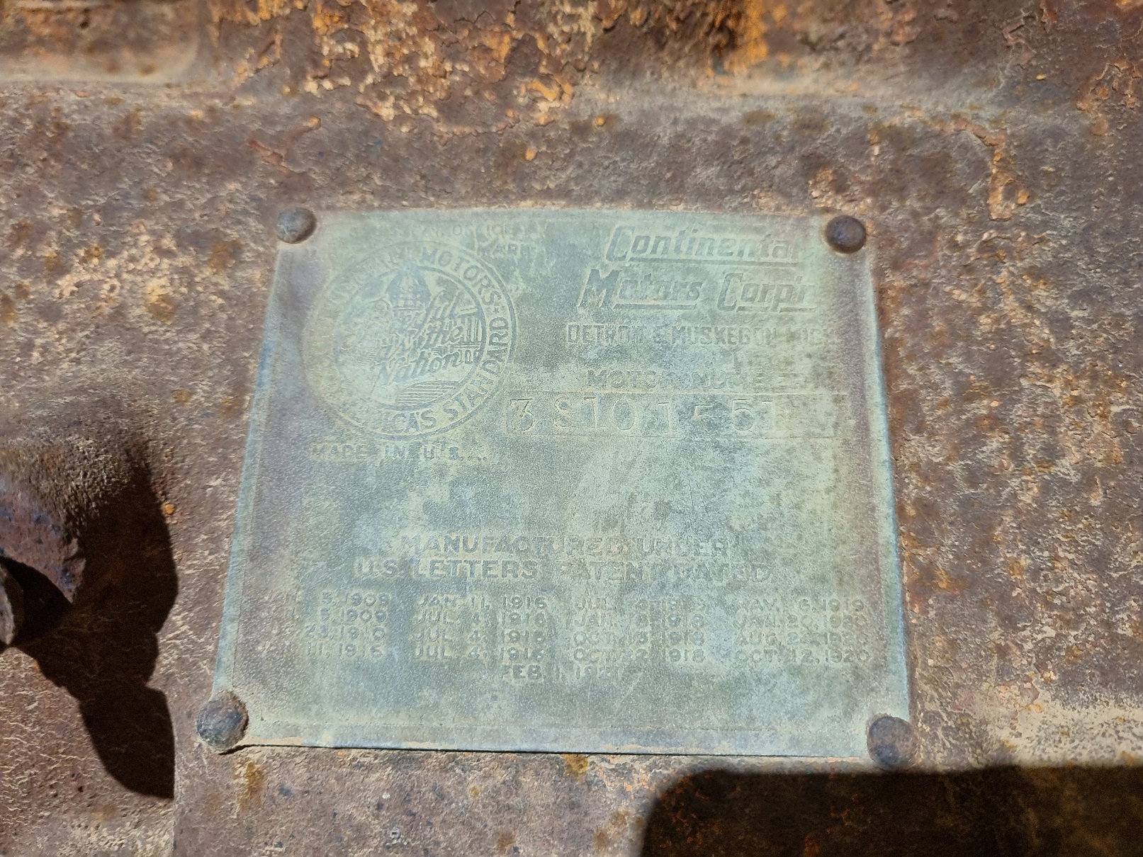

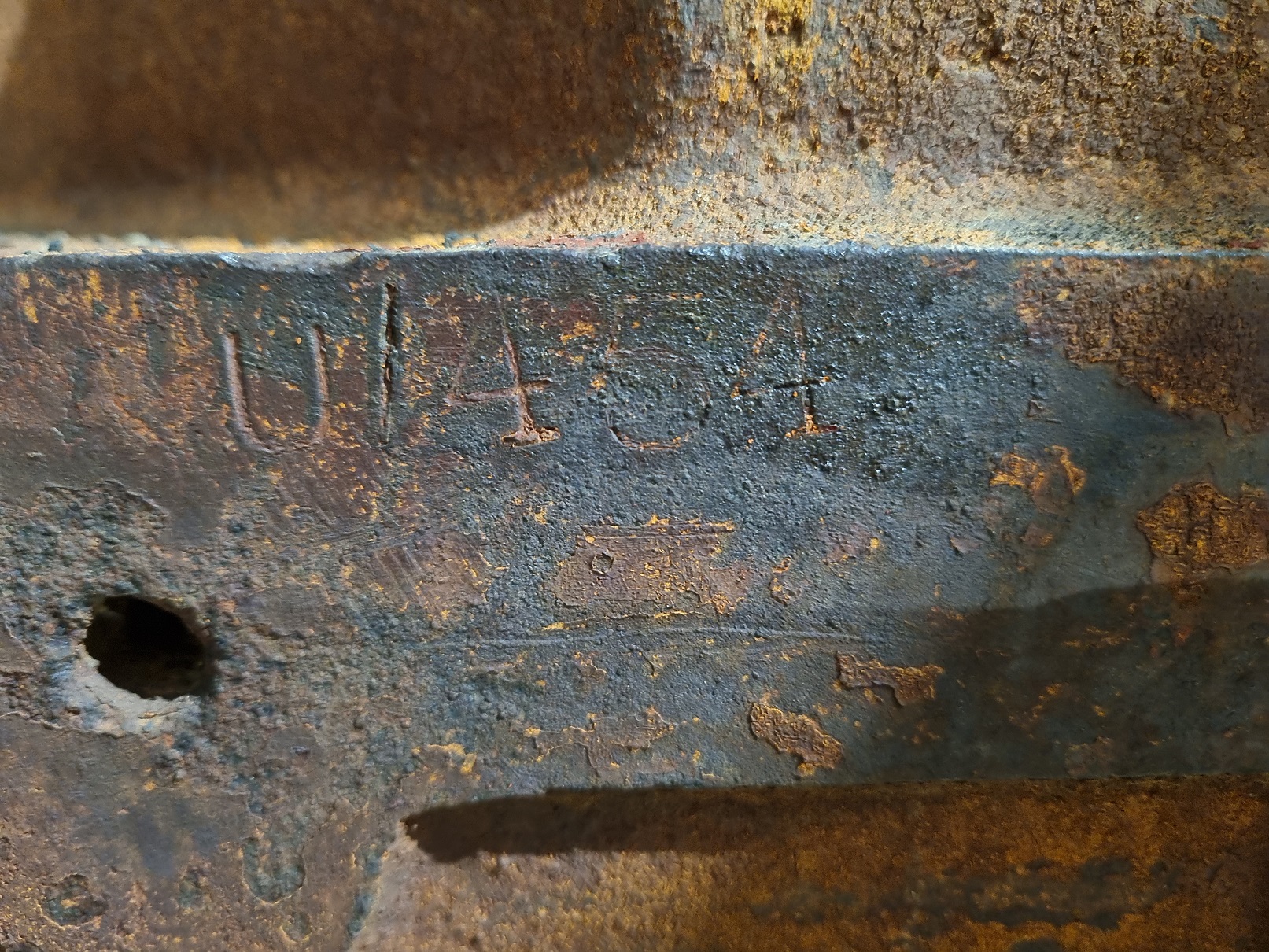

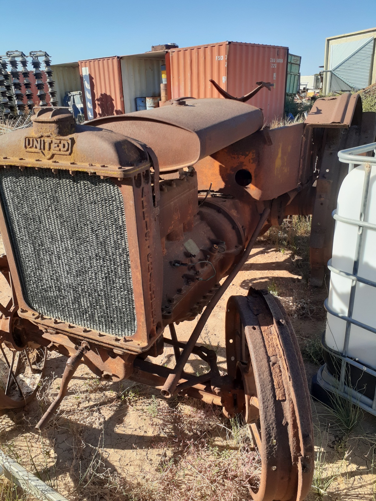

How is the Continental engine tag stamped? Any different than a gas model?
Date Posted: 14 Jul 2021 at 5:26pm
Hi Russell,
The car is actually a 1934 Chrysler Airflow sedan, factory RHD. So far I have completed some bodywork on it but most of my time since finishing the model A has been located missing parts for it. The Airflow is a long term project. The United has just jumped the queue!
http://www.australianallischalmersregistry.com/
Date Posted: 14 Jul 2021 at 5:28pm
Oddly here in Australia boats were built with the steering wheel on the wrong side. I restored this one around 12 years ago it was built only a couple of hours from my place in the mid 1960's and is powered by a Dodge Sidevalve 6. I purchased the boat from the original owner and returned it to completely original condition.

Here is the tag;

Posted By: plummerscarin
Date Posted: 14 Jul 2021 at 6:03pm
I'm of the belief that all boats are right hand drive as the weight of the driver offsets the torque from the propellerlifting the starboard side.
Posted By: GreenOrange
Date Posted: 14 Jul 2021 at 9:06pm
Thanks for the picture of the tag. Appears to be standard earlier S10 markings.

     The center of the engine tag is interesting too. "Powerful as the nation".

The serial number below appears to be U454?
Posted By: Jacob (WI,ND)
Date Posted: 01 Aug 2021 at 10:47am
Travis, I'm humbled at the fact that you are inspired by my crazy projects.  But I guess that is what it is all about, trying to encourage others to tackle a project a little bigger than you are comfortable with.  That is how you learn and increase your skills.  I know I have the last couple of years.  It's funny how you mention me, because as I look at your pics, I am drooling, this is exactly the kind of piece I am drawn too.  A project!  You have absolutely nothing to loose by taking it apart and fixing it, because it is no good the way it is (besides yard art, and it's too nice for that).  Keep us posted, I'll be following this with much interest!
To me the serial number looks like U1454 ?
I'll be the first to admit that I don't know much about the U world though, I have yet to dive down that rabbit hole.  I guess I better be careful, you may make me want to get a U after watching your restoration....
Jacob Swanson
Date Posted: 01 Aug 2021 at 5:19pm
Thanks Jacob, although I don't think it will be as fast as your 6-12 restoration!
With the serial number I posted it as I am unsure, the 1 seems to be punched at a different angle and could be a / ? I have a UM powered U and the number on it is very clear and no / . Hoping someone may know for sure.
Apart from the rear wheels being free, nothing else is so far. I will start a rough plan of attack and hunting a few basic odds and ends soon.

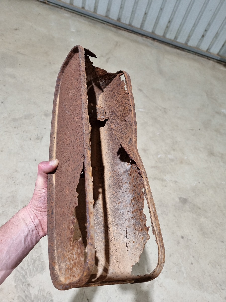

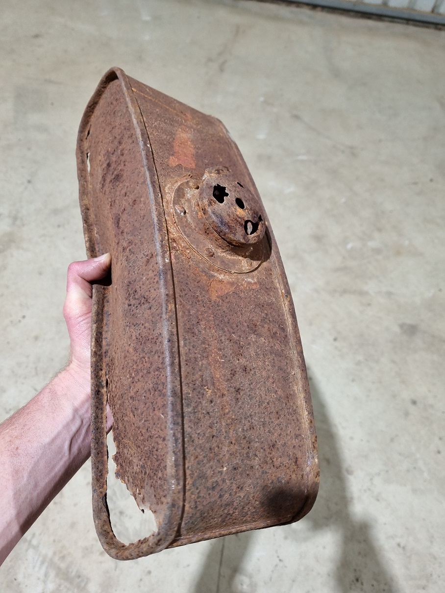

The starting tank has seen better days, but on the plus side I have a template!
Posted By: PaulRoidt(WI)
Date Posted: 01 Aug 2021 at 5:45pm
Very interesting low grade fuel manifold and carburetor.  Similar design to a distillate manifold used on 20-35's that seems to more common outside the US, but still very rare.  Will be interesting to see it disassembled.
Posted By: Layne
Date Posted: 07 Dec 2021 at 7:32pm
Nice tractor! Your serial number is 1454. The brake should prove that, as they switched from a brake pedal to a hand lever at #1008. Mine is #1005 and has the pedal. Mine also has the 1 made with a chisel instead of a proper number stamp, just like yours. Later ones I've seen had a proper number 1.
Date Posted: 10 Dec 2021 at 2:24pm
Thanks for that, I suspected it was a rough 1 given how untouched the tractor is but given how crude it was I couldn't be certain.
Thanks Layne!

Date Posted: 21 Jun 2026 at 8:09pm
It has been a while since I have looked at the United with a car project getting in the way. The past few years I have been looking for a few parts here and there and now finally I have started some minor work.
I managed to find three front wheels at a Clearing Sale a few years ago and this past week I removed the old wheels and bearings and fitted up the best wheels with fresh bearings and races.
The next job has been to get the steering free'd up. The King Pins all have a lot of wear but seemed to be free. I removed the arm off the steering box and confirmed everything was sloppy but moving well. I reconnected the steering back onto the box and gave the remnants of the steering a bit more of a wrestle and managed to get the wheels pointing straight. From here I will remove the steering box and investigate how bad it is inside.
As you can see this is a very rough machine but rare here in Australia, with my first goal to make it movable before getting into pulling down the engine to see how significant the damage is.
