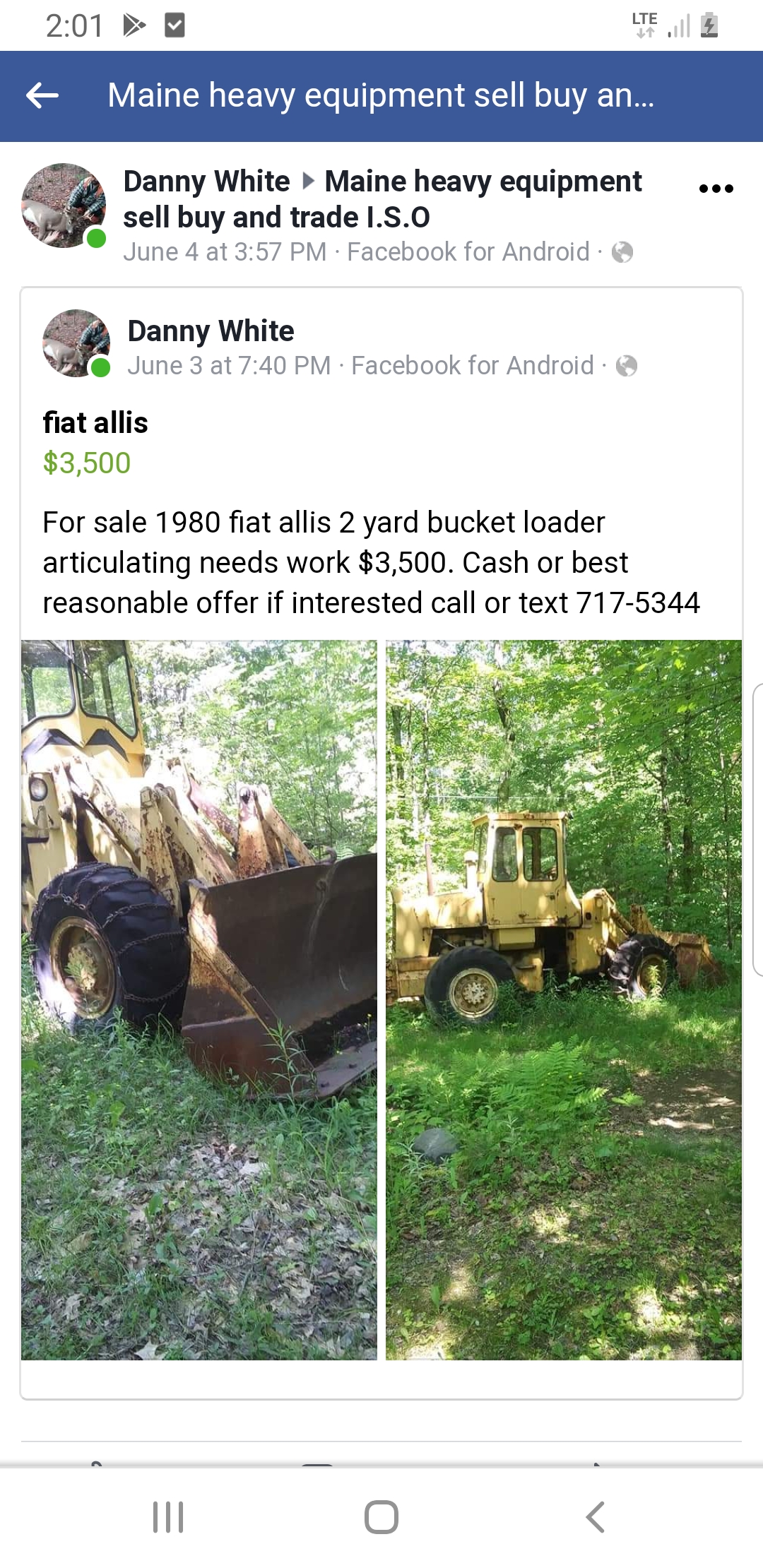

[IMG
Posted By: ac89
Date Posted: 29 Aug 2020 at 9:43pm
Here she is. Guy wants 3500 for it. Thoughts? Pictures aren't great but it looks like it's in decent shape.
Posted By: Rusty Allis
Date Posted: 29 Aug 2020 at 11:41pm
I never believe "ran when parked" stories. i'd hit him low if you can't hear it run.
also i'd be weary of going to get it running...price goes up then...unless you make an explicit deal with him...like if you get it running, it's still xxxx dollars, and you're still willing to buy it no matter what.
you may luck out, or you may have a boat anchor
Posted By: DMiller
Date Posted: 30 Aug 2020 at 6:40am
As a Salvage or scrapper that is worth MAYBE a Grand, would offer no more as so many things can be wrong from sitting.  Brakes, Clutch, or power sift, hydraulics.  Bucket looks worse for wear, the owner added chains for slick tires(NOT Cheap if can find replacements) and as noted fuel system is down.

Date Posted: 30 Aug 2020 at 6:43am
Just guessing but appears a Early 545 series Allis not FA.  Roosa Master/Stanadyne pump on a Farm Tractor base series engine in it.

That would be cool if it was a true allis chalmers. Thanks everyone for the advice I am going to go look at it and throw a battery in it and see if it turns over ok. Also going to check all fluids. I may offer him 1500 if it looks like it isn't a complete junk pile. Plus I have to figure trucking it's 45 minutes from me. I don't think it is going anywhere with the price he wants so I may make a fair offer if I like it.
Posted By: ac89
Date Posted: 30 Aug 2020 at 9:36am
And yes I noticed that it has tire chains I know from experience loader tires aren't cheap so I will figure that into my offer

Date Posted: 30 Aug 2020 at 11:27pm
There are lots of 301 engines around, which might be a cheaper way to go then rebuilding it.  It looks just like mine, as far as the cab goes.  The problem mine has is the intake tube on the transmission is cracked and to replace or repair it entails pretty much dismantling the entire machine.  I can run it if I overfill the trans but then it gets hot and doesn't like to move very well.  Another one of those winter projects I may never get to.
