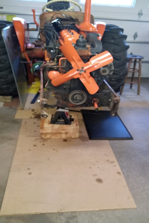

Posted By: jaybmiller
Date Posted: 24 Jul 2020 at 4:38pm
I wedged 4by4 blocks at the tierod ends to keep the front wheels from going cockeyed twisty and causing a potential nightmare.....
the big trick is to use solid wooden blocking for supports and to be very careful.
sure helps to have an extra pair of hands and eyeballs on the job too !

Fav son posted a pic for me . Dunno why it's kinda fuzzy . Got the front end rolled out of the way fairly easy . Thanks to Dr Allis . Also wedged a couple short 2 by 4's on top of the axle under the nose/chin center piece . Thanks Jay .

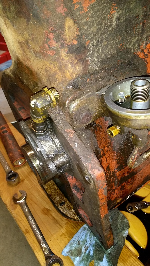

Another question . Anyone familiar with the tube that runs from the base of the oil filter to the oil pump cover on the back of the engine ? Mine's leaking . Has what's left of rubber packing grommets in the connection . Guy at NAPA had never seen one . Hoping Sandy Lake has some . Thanks !! Now that I've cleaned them some I see Imperial Flex on the cap .

Posted By: ACinSC
Date Posted: 11 Aug 2020 at 10:59am
My fav son has posted a pic .
Posted By: SteveM C/IL
Date Posted: 11 Aug 2020 at 1:21pm
Those grommets come in various sizes. My 8070 has them on various lines. Should be available from AGCO.
Posted By: ACinSC
Date Posted: 11 Aug 2020 at 1:38pm
Thanks Steve . Sandy lake has them .
