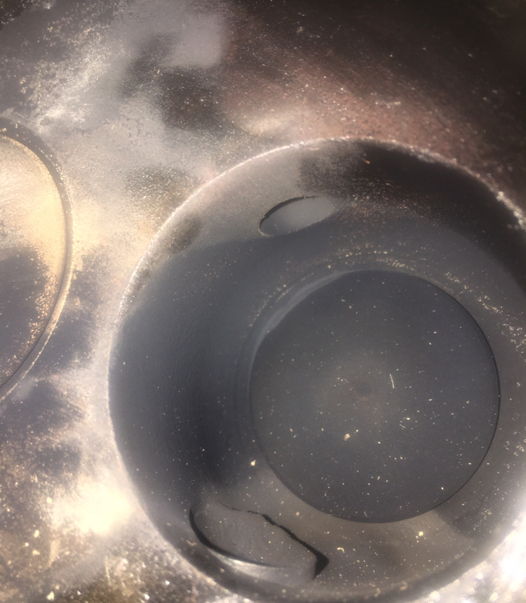

How hot does a d19 diesel run at for temperature? Got the head off and looked in where the thermostat is a suppose to be And there wasn’t any in there, so trying to figure out how hot to go with.
              Thanks!!!

Got the timing cover off by Loosening the frame rail and it came right off. Got the head on and the manifolds. Now just waiting on parts.

Posted By: 55allis
Date Posted: 03 Dec 2020 at 9:15pm
Got the head off of it and the head gasket looks fine but the head has a bunch of cracks around the intake valve.
If you look closely at the picture you can see the cracks.
Posted By: 55allis
Date Posted: 03 Dec 2020 at 9:16pm
Posted By: MACK
Date Posted: 04 Dec 2020 at 8:16am
Why do you want a copper head gasket? If the sleeves are low, a copper gasket won't help.           MACK
