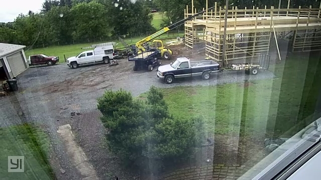

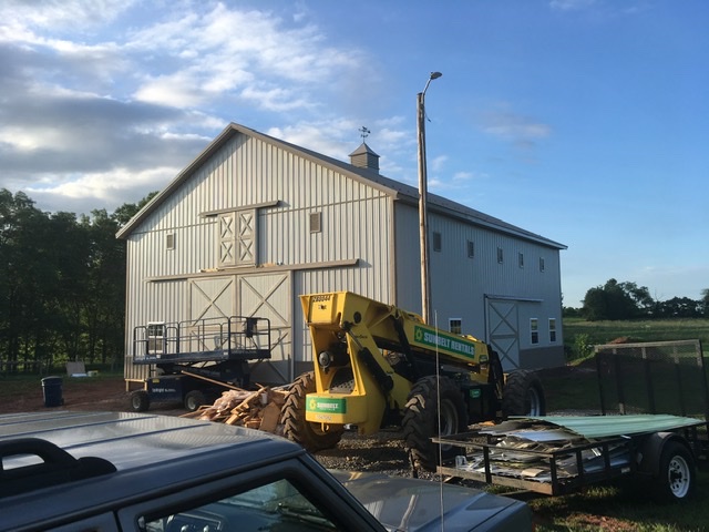

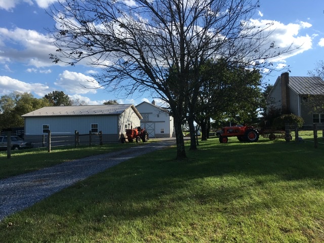

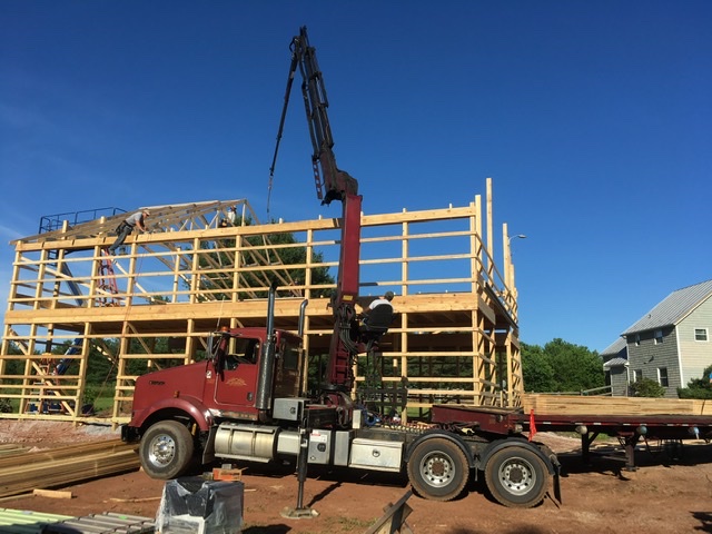

Posted By: allisbred
Date Posted: 29 Apr 2020 at 8:43am
Chris, I don’t know if you have locked a contractor yet. Price “Shirks Pole Buildings” out of East Earl PA and request “Linus” pronounced “Lunus”. I had them build my shop and barn a few years ago. They can do what you want, Morton was 2x the cost and are within 4 miles of me. I will attach some pictures of what I have. I am very happy with all aspects of their business.
Date Posted: 29 Apr 2020 at 8:51am
Date Posted: 29 Apr 2020 at 8:55am
Date Posted: 29 Apr 2020 at 8:59am
Small shop is 30 x 40 x 10’, barn is 40 x 50 x 18.4’ to the eve.

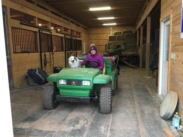

Date Posted: 29 Apr 2020 at 10:09am
I have the entire upstairs covered in 3/4” floor boarding for hay. The center bay is 16’ x 12’ H down stairs for clearance so the is a 2’ step up to the center section for the hay mow. Works very well because when loading it is a down hill Throw. I can put 2500 small bales in and still have 3’ of celling clearance.

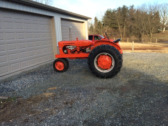

This is a picture of a 9 x 16’ door with 10’ ceiling height. 12’ will be nice if you want a lift, that is very tall though for a small shop. I have 12’4” for the barn.

Posted By: Sugarmaker
Date Posted: 04 May 2020 at 2:07pm
That helps get the look with the Allis setting there. I know I have only a inch or two clearance with the Allis tractors under a 7 foot door. So that just has to have taller doors in the new shop for sure. !2 feet seems over kill today! Have to polish the crystal ball and look into the future.
Hey that's a nice looking Allis.

Took the WZ for a nice ride down the road. It runs very good for a old tractor! A little bit of gear howl but  not as bad as my wide front.
Here it is headed up towards where I had the two proposed 12 foot wide doors facing west.
