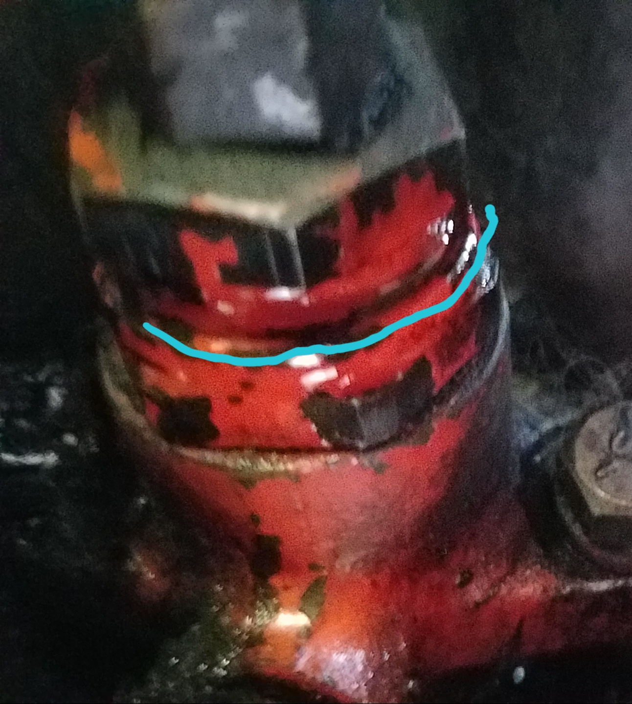

How do I fix this leak? it is not the return line.

From picture, I can tell nothing. If it is leaking between adjusting nuts, there is a oring inside. If it is leaking at nut on drip tube, there is a rubber bushing in nut. If it is leaking where injector goes into head, replace the valve cover gasket.   MACK

it is leaking at the blue line. It is diesel fuel.
Posted By: injpumpEd
Date Posted: 17 Apr 2019 at 7:21am
Inj has to come apart to replace the oring inside. That isn't an original 210 injector. It will need reset once the adjusting nut it removed, and oring is replaced.
Posted By: fastallis
Date Posted: 20 Apr 2019 at 9:10am
Thanks Ed, I pulled the injector and took it to the neighbor who has a injector tester. He took it apart replaced the oring and set it at 3100 psi. I put it back in and no leaks. He seems to think those injectors are out of a 7000 series tractor. Why would someone have changed them from the originals? Any thoughts of why they would have changed them out?
Posted By: bradley6874
Date Posted: 20 Apr 2019 at 9:29am
Being there not original I would pull the other five cuz you have no idea what they're set to now you got one correct and 5 maybe something else
