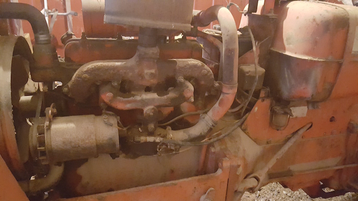

New member and first time poster.
Have potentially been presented with a FREE D15.
History is tractor was running when it was parked, and hasn't moved since. Exact time it has sat is unknown, but best guess is 15 years +/-.
Had new tires on it when parked, but fronts are flat and cracked nearly through. Backs are low, and cracked, but may still be usable.
Initial check, throttle and choke are locked up tight and won't move. Have not budged the tractor to see if engine will turn over. I checked the oil and it only had oil on the dipstick.....no water so that was promising.
I am not looking to go into a big restoration project, but would love to have the tractor as a user if I can get it running.
So my question is, what are the steps to get this going?

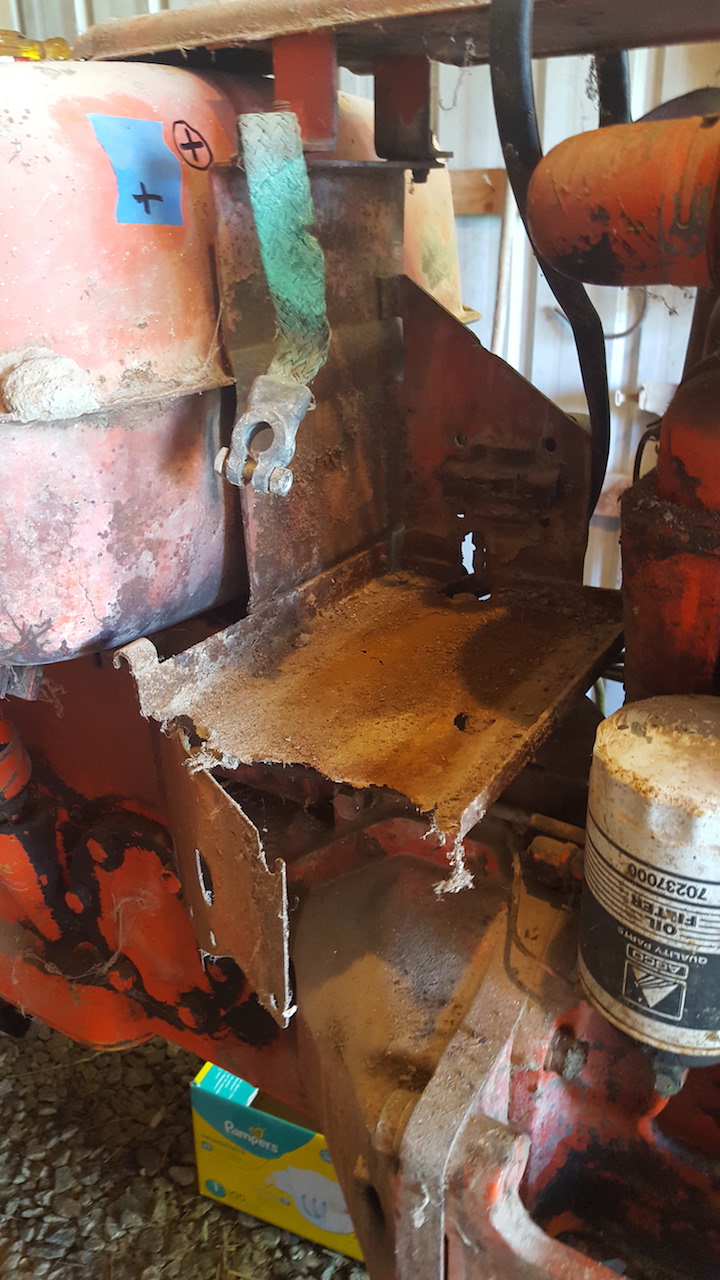

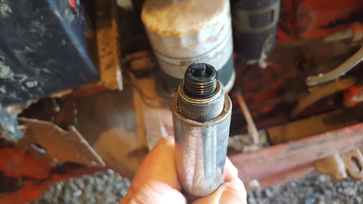

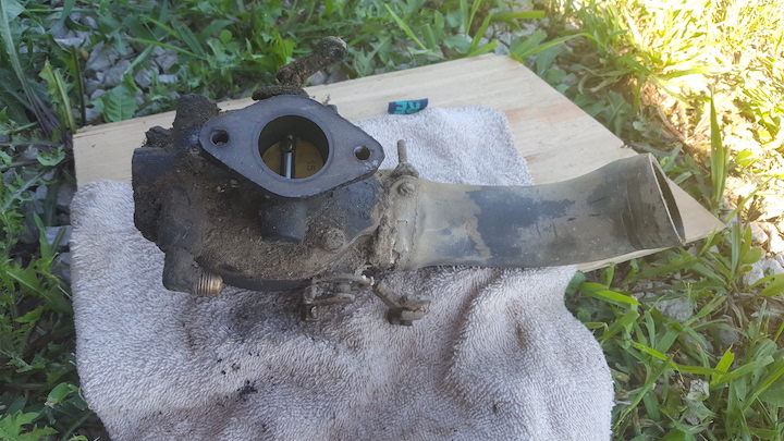

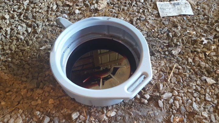

So this thing is currently in a barn across the road from me, so I can check on it, play with it there.
Gas tank is empty. Sediment bowl is half full of what looks like varnish, and is stuck and won't come off.
Eased off the choke linkage a bit, and was able to work choke a little, so while it remains very stiff, it's not entire frozen either.

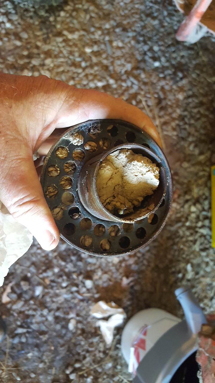

How does the breather cap come off? Right side engine cover can't get past it without it coming off, and this one seems to be stuck in place. Lifts off? Screws off? Hate to apply force if you don't know where or how.
Can't tell if there is any coolant. May dump some antifreeze in and see if it spills out.
Also, cannot see much evidence of oil or other fluids on the ground below. Oil on the dipstick is full, but is black and thick. It will rate a change before trying to turn the engine over.

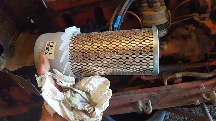

Oil fil cap just lifts off. A slight twist and lift should do it. Does it have the breather cap that comes thru the right side hood? If so, a twist and lift should remove it also.

Air cleaner top is just a press fit, if its stuck, just squirt your favorite panther piss, up, and around it, and tap it with a hammer, whilst twisting with a pair of channel locks...Wink

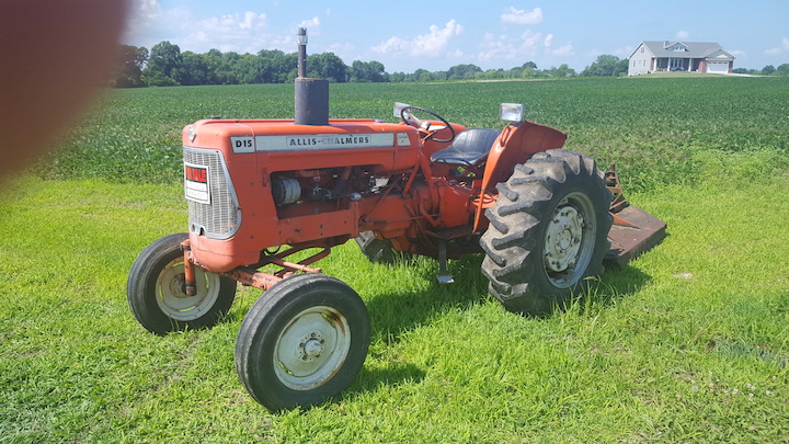

Congratulations you lucky dog! That is a Series II and is a very nice find. Welcome to the Forum. Already some good advice given and like has already been said the first thing I would do is drag it home.

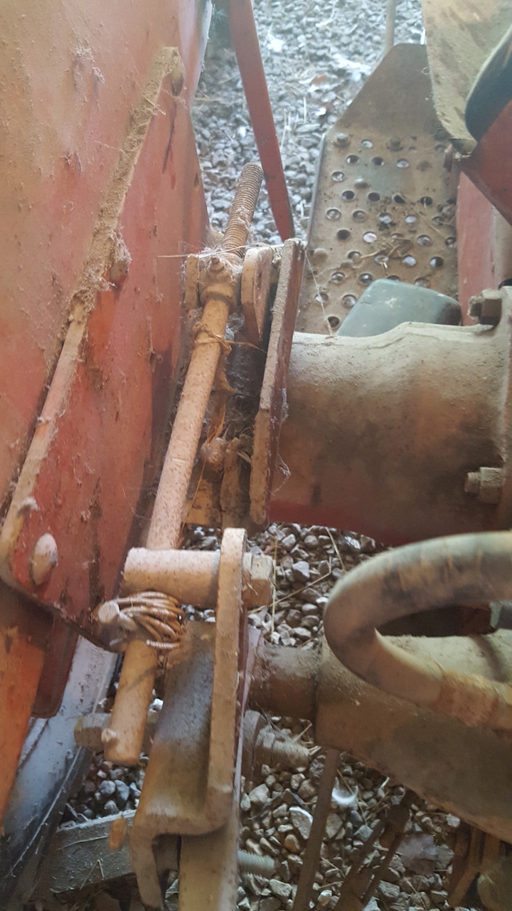

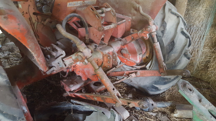

Looks like a sickle bar hold up rod tied to the left side of the tractor and the sickle mower parked behind it. If that was its job in life it should be a good tractor.
Posted By: modirt
Date Posted: 19 Jul 2018 at 1:24am
There is a pull type JD sickle bar mower parked behind it, and I'm told that when the original owner retired, this tractor and that mower were the only pieces of equipment he kept, and used it to clip pastures, mow pond dams and road banks, etc. Prior to that, tractor was used in his general farm operations. I suspect it has only had one owner. BTW, I'm hoping to revive the mower too.
I also noticed that rod and am not sure what its purpose was. It does not appear to be part of the existing JD mower. It appears to me it is tied to the 3 point hitch on the left side, and projects motion forward. Good news is the original owner is still alive and may be able to tell us what it is.

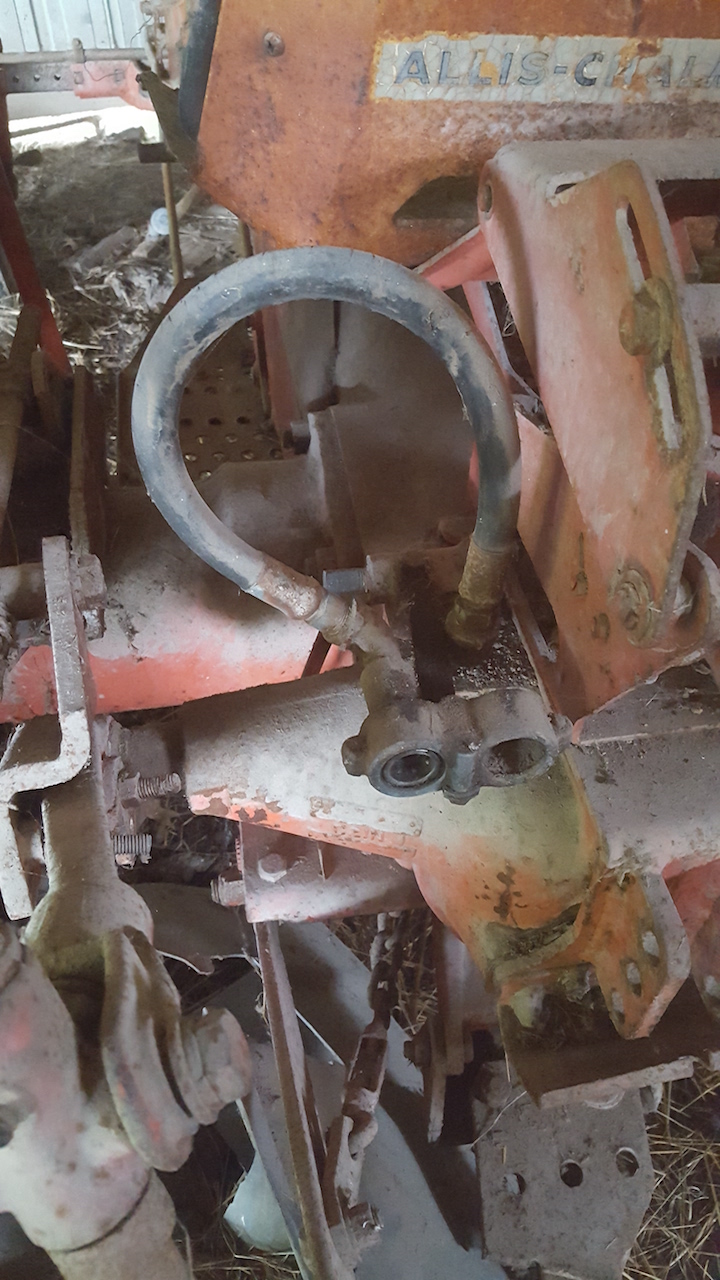

BTW, 3 point lift, no snap coupler and no center link to be found. One single hose hydraulic service. Fixed up and running, this could be a handy little tractor for a lot of things. Mowing and raking hay both come to mind.

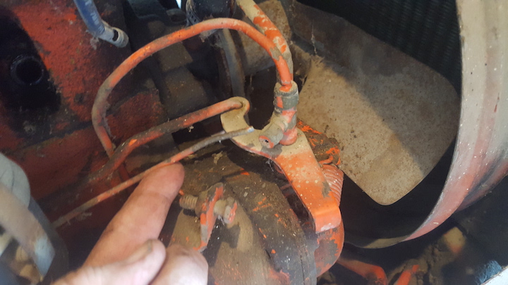

So......a progress update:
Got the tires aired up and they look much better than I expected. Flat, but NOT cracked as I thought. They look nearly new and were holding air. One rear had a bit of a crack in the sidewall, but came up and held. Rims have some rust down low however.
So with the tires up, we got her moved. I drove, and she handled well. Brakes were working perfect.

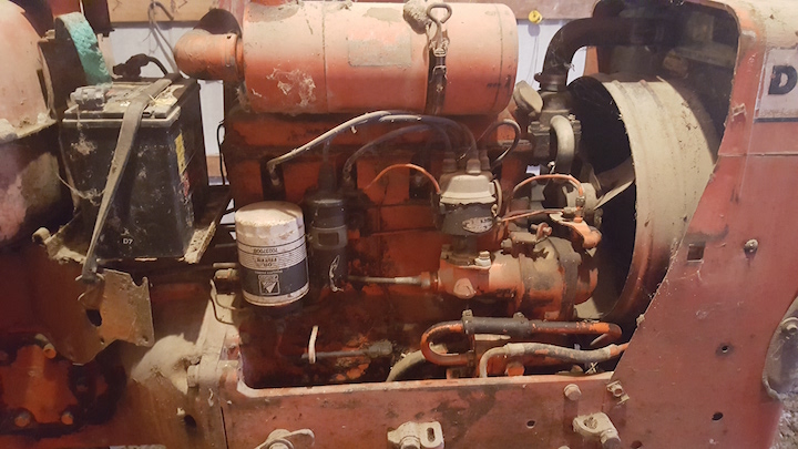

Engine covers off and so it begins........

Posted By: Kenny L.
Date Posted: 20 Jul 2018 at 9:26am
Modirt, congrats on your find you'll love the D-15. I see you've the mounting brackets for a cultivator and I believe the rod is part of the cultivator also. Have fun with the old girl.
Posted By: modirt
Date Posted: 20 Jul 2018 at 11:30am
I suspected the rod may have been for a cultivator. There is a forward projecting bracket mounted to the top of the left side 3 point link. We had something similar on a JD 620, which carried a front mounted cultivator. Except that one used two push/pull rods....one on each side, and they were more like 1.5" pipes. But if this one was used to lift in a pulling motion vs. a push, a single solid rod may have worked.
I was also wondering what those brackets would have been used for and a front mounted cultivator was the only thing I could think of.
My first "car".....was a JD B tractor. I got started on it when I was about 10 or 11. At the time, my interest was in the fact it had an engine and didn't need to be peddled like my bicycle did. It also had a 2 row cultivator and I tried to talk my dad into letting me put it on and use it. He refused, insisting that if I was interested in running a cultivator, I'd get more done with the 4 row, and the 620 had power steering and the B didn't. My guess now is he simply wanted to get out of all the work it would take to mount it up, knowing the glamor of that would wear off in about 10 minutes once I tried to steer the old B by hand. (Known of then as Armstrong Power Steering) Especially with the weight of the cultivator on it.
The D15 was probably big enough to have handled a 4 row cultivator too.

Date Posted: 20 Jul 2018 at 3:34pm
Progress updates:
This is starting to remind me of my first date with a lewd woman. Curiosity running wild as to what I'm likely to discover next.
Hour meter is showing something like 5200 hours. No clue if the tach is working or original.
Oil plug is out. Black as midnight but at least all oil. No water.
1 cup ATF in each cylinder.
Plugs a bit black for my taste. Two blacker than the others.
With plugs out, AFT in, and my curiosity getting the better of me, I rocked her a bit in 4th gear and fan blade twitched about 1/4". That was good enough for today.
Air filter pulled and looked newer than new. Air breather cap and stack tube full to the gills with mud dauber nests. Shop vac to the rescue. (Secondary benefit to this is I'm on my way to gaining 1/2 acre of accretion dirt from all the mud dauber nests).
Battery pulled and first real clue as to how long she may have been sitting. Battery was marked Sep - 7. Too old to be 2017 and not old enough to be 1997, so that leaves 2007 - 2010 as to about when she was running last. So maybe 10 years vs. 15? Battery box has got the cancer, so has a little life left, but not much. I'd put a new on one if I could find one. Battery was much smaller than the box it was sitting on and in true "make due" fashion, was held down with a tarp strap.
Aft of the engine dip stick, found two more dip sticks. Both had clean....bordering on new.....oil in them, although the one under the seat was barely showing anything on the dip stick, and I remember there was some dark dirt below that area where she had been parked. May have a slow leak.
Gas tank smells as bad as you would expect it to from ancient gas, but no rust. Carb is froze up solid. Time for that to come off for a cleaning / rebuild / kit job. Right now, that is looking like my biggest obstacle to a running engine.
Too much fun!
Posted By: DrAllis
Date Posted: 20 Jul 2018 at 3:37pm
The pistons have a bowl top. One cup of oil maybe doesn't quite fill the bowl, so you need another cup to flood the rings/sleeves.

Posted By: Kenny L.
Date Posted: 20 Jul 2018 at 3:51pm
Modirt, I think Matt Scott from Jordan make battery tray for  them but I could be wrong I know he made some hold down for them, his # is 612-508-4759.

Posted By: modirt
Date Posted: 20 Jul 2018 at 4:43pm
Added more ATF to the cylinders.......enough it ran out the plug hole of the aft one and I could hear it sloshing around in the others. Hopefully that should do it.
And while I understand what the purpose of the ATF oil is in there, I remain somewhat fuzzy on what becomes of it. On the other hand, the oil drips coming out the drain plug are now the color of the ATF, so given enough time, it may all seep past the rings and out the bottom?
Posted By: Jk chalmers
Date Posted: 20 Jul 2018 at 5:12pm
Yeah as long as Stuff Isnt locked up most of it will penetrate in between the cylinder wall the piston... Personally after you get a new battery I would leave the spark plugs off and blow most of that out of there as it seems your engine is free when you crank it over. Then proceed to put your plugs in them put fresh fuel in it and see if you have a running a tractor might smoke for a couple minutes. Before doing that I personally would have just seen if the engine would move in a gentle fashion but to each their own this is fun it’s like I’m reliving my D 15 barn find again!!

Posted By: modirt
Date Posted: 20 Jul 2018 at 6:25pm
I think I'm OK on the rings and pistons. With all the oil in, I jogged the fan a bit and it moved about 1/2" and I could hear stuff sloshing around. Sounded wonderful.
But at the least, she is going to sit where she is until the carb is working.
Next big worries are the starter and generator. Fan belt looked OK.

Posted By: DanWi
Date Posted: 20 Jul 2018 at 9:33pm
You need to get it turning over good without spark plugs to blow the oil out because you can't compress all the oil. Whatever is left in there thou will prevent a dry start and help the compression.

Those are sweet little tractors and highly collectible. We had one and traded it on an 8070. I hated to see it go but the only thing we used it for was pulling a trailer in the spring fixing fence.
Where in Mo are you. I’m northeast of Jefferson City.

Date Posted: 21 Jul 2018 at 12:53pm
Ah yes....nothing like the smell of ATF in the morning............That pan was empty last night, so all that came from the cylinders.......plus whatever is still left on top of them.
And the carb is off and is went to town to be cleaned up and rebuilt. Shop said they had an old guy (who turns out to be younger than me) who had done about 1,000 of them.
Throttle valve was stiff but working. Choke was not wanting to budge much at all.
Once free of the carb, choke cable freed up and while stiff, was working some. Throttle linkage remained stiff however. Not sure where to go looking for the trouble there. Don't know if simply working them back and forth some is the answer or if something else should be done.

Those asking about the cultivator, not sure if this would have been a part of it or what it was used for. Attaches to the 3 point lift arms, and when the arms are lifted, it would rotate forward.
On the rod in question, don't have a better picture of it than the original.
The rod in question is held up in the front by a loop of  baling wire. It runs back under through a loop under the left step, where it simply ends in space. The back end is threaded rod.
Don't know if the three point arm bracket thingy and this rod were supposed to be connected in any way or if both were for some other implements that are long gone.

Another question. She has a single hydraulic coupler for a one way cylinder. The mower she was pulling has a one way lift cylinder as does my 7' New Holland haybine. (If I get her running guess what job she is going to have?)
I assume this is a standard pioneer coupler fitting?
The newer D15 parked on the road has two working fittings? I assume that means a two way cylinder operation? Is that an option for this tractor?

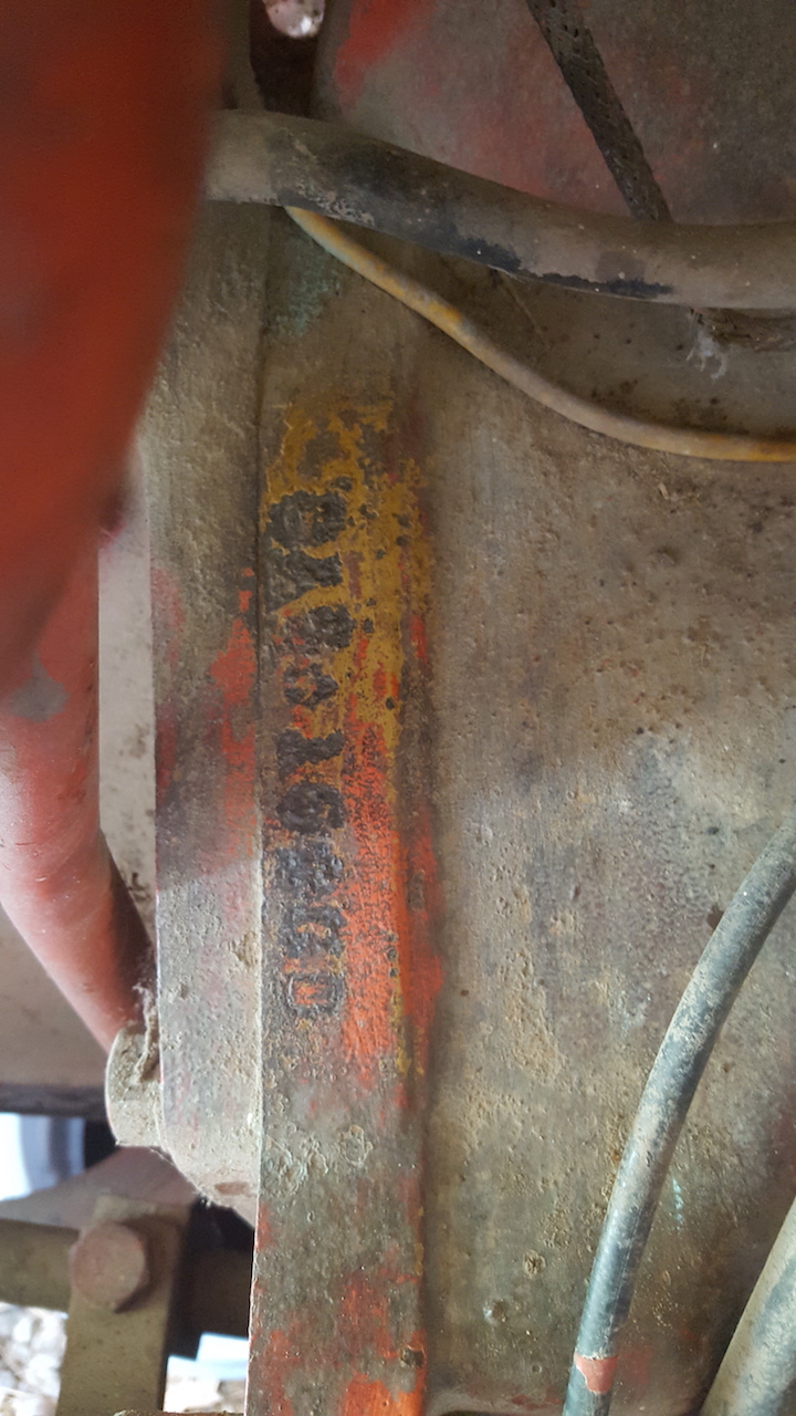

Date Posted: 22 Jul 2018 at 2:04pm

Posted By: modirt
Date Posted: 22 Jul 2018 at 2:09pm
Peeked up the back end of the generator and can see what looks like mud dauber nests inside the housing.
I assume that is bad and firing it up in that condition could risk fatal damage? (My dad had that happen to him with an air compressor motor that sat unused for a year or so. It fried the motor).
If this needs to be addressed and I slip the generator off, how extensive does one have to get to fix this?

Believe that serial number would put it as a 1963 If I’m reading it correctly it says 16,800 also if it’s the original carburetor a lot of times it will have the date on the brass tag.
Posted By: JayD-17(NY)
Date Posted: 22 Jul 2018 at 3:37pm
May be I am not seeing it right but the last # in serial # looks more like the letter "D" to me which would suggest it was a diesel at one time or the torque-tube/rear end came from a diesel?...may be not.......
Again, maybe I am looking too much into it;  but I'm seeing what looks like yellow paint peeking through around the serial # suggesting maybe ,at least that half of the tractor, came from an industrial model? Could be just my eyes, could be primer......any signs of yellow elsewhere on the tractor? It does appear to have been repainted and re-decaled in the past......
Posted By: AC720Man
Date Posted: 22 Jul 2018 at 3:59pm
They used a yellow primer from the factory. Primer may not be the correct term, but that was factory. Dad's had that on it when I sand blasted it to paint. I only removed what had flaked up. Primer never lifted.
Date Posted: 22 Jul 2018 at 4:07pm
Yeah I remember seeing that type of "Primer" on some of the Allises from that period...thats why I asked if any yellow was peeking through elsewhere....that 0 that looks like a "D" is likely a funny stamped 0 then , and the tractor is probably a all original 1963.....

Not sure about tractors with 3 point, but on my SC D-15(II), the lift mechanism is mounted under the foot rest.  The mechanism that is in the pictures appears to push forward as the arms lift.  The cultivator mechanism (at least on mine), pulls to the rear, as the arms are lifted.  Might be a farmer cobble-up, to adapt a JD mower, to an Allis tractor...Wink
Date Posted: 22 Jul 2018 at 5:35pm
Is that actually a D 15 with a factory three point?
Date Posted: 23 Jul 2018 at 12:01pm
Other people can chime in but you are oiling the valves and such as you pour the Oil on the top of the engine You’ll be fine just turning the engine over... That’s just my opinion it’s not gonna take much for the oil to be distributed everywhere and it’s not like the engine is going to be running so just turning it over will be fine.
Posted By: Steve Zidlicky
Date Posted: 23 Jul 2018 at 12:35pm
since it has sat several years, just unplug coil wire so it will not start and spin it over some to get the oil everywhere then hook up coil wire and start it
Posted By: Don(MO)
Date Posted: 23 Jul 2018 at 1:00pm
Like the guys said it will be OK to roll the engine over, I'd leave the plugs out when you roll it over to get as much of the ATF oil out/off the tops of the pistons before you try to start it.
Date Posted: 23 Jul 2018 at 1:02pm
Also don’t be alarmed after it fires up that it smokes for a second ha ha just make sure the oil pressure is good after it fires up...!! I’m sure you already knew that just had to say and can we post videos I’d love to hear the initial fire !!
Posted By: modirt
Date Posted: 23 Jul 2018 at 1:30pm

Posted By: modirt
Date Posted: 23 Jul 2018 at 3:47pm
What is this tube and why isn't it connected? Can't tell if it is broken off or simply pulled out.
It runs from a fitting at the base of the distributor to a similar fitting at the throttle linkage at the governor.
Posted By: modirt
Date Posted: 23 Jul 2018 at 5:06pm
Hmmm......D15 service manual I ordered off ebay arrived today. That is an oil line that runs from governor to distributor. Manual only mentions what it is. Not what it does or what happens if it's not connected as this one is.
Posted By: AC720Man
Date Posted: 23 Jul 2018 at 5:11pm
Go to Advance Auto store if you have one, they have a copper line kit made by Bosch for $10. Has all the parts you need to make a new line connection. You need that fixed before you turn it over. Looks like it goes into the connector at your finger tip. I can check dads after dinner.
Posted By: DiyDave
Date Posted: 23 Jul 2018 at 5:51pm
Yep dist oiler runs from that tee fitting with nothing sticking out.  Needs to be connected, or it will squirt oil from the tee...Wink
Posted By: modirt
Date Posted: 23 Jul 2018 at 8:04pm
OK, I now know what it is, and think I know how that happened (a self inflicted wound).
The oil tube T fitting, (the T fitting with nothing sticking out of it), is stuck to and rotating with the governor control rod lever mounted directly below it. The T fitting is swiveling back and forth with the control rod lever when the throttle lever is moved up and down. Even in the picture you can see the fitting and hole in it are not pointing to the oil tube.
So my guess is that needs to be freed up, so that the T fitting does not rotate with the control rod lever directly below it and remains pointing at the oil tube in a fixed position while everything else is moving. Otherwise, it bends back and forth at the fitting and will keep snapping off?
The self inflicted part came as I was manually working the throttle body back and forth once to free it up once the balky, sticky carb was off. Unknown to me, I was also working that line and it must have snapped.
That is a really small line. Is there a known Bosch number for a tubing kit to fit? The ones I saw online looked to be much larger OD/ID than this line is.
Posted By: AC720Man
Date Posted: 23 Jul 2018 at 8:31pm
The one I picked up is the only size they sell and it fit. I threw the packaging away. I think its 1/8” line. It’s used for oil pressure gauges.
Posted By: Dave (Mid-MI)
Date Posted: 23 Jul 2018 at 8:53pm
The rod under your footrest pulled back when the three point was raised to raise the front cultivator gangs. The mechanism near the fender is a depth stop for the rear cultivator gang.
Posted By: modirt
Date Posted: 24 Jul 2018 at 1:16pm
Dave: Thanks for confirming the info on the cultivator. That would have been my guess, but being a pull/lift was different than what was used on our old JD stuff.
But that being the case, once I confirm this thing is mine to have and to hold, and since there is no cultivator to be found, and since I don't want one, I suspect the cultivator stuff will be made available to someone who wants it. I've got an idea on the best way to ration this out, but will share that when the time comes.
Posted By: modirt
Date Posted: 24 Jul 2018 at 1:22pm
On the oil line, I have found it locally, and it is indeed 1/8" OD stuff and is sold for oil pressure gauges. Not sure if the compression fittings they sell with it will work with my existing ends, but we will find out. Does anyone know if the small compression fittings inside the existing ends can come off and be used again, or ??????
Also, I checked the roadside FS D15 and confirmed the T fitting and governor control lever are supposed to work independent of each other. Mine are turning together as a unit and seem determined to continue doing so. Looks like I need pull the stack to get them apart, cleaned up and working as designed. So how does that stack get pulled? Does the T screw out the top or is the entire stack screwed into the base as a unit?
