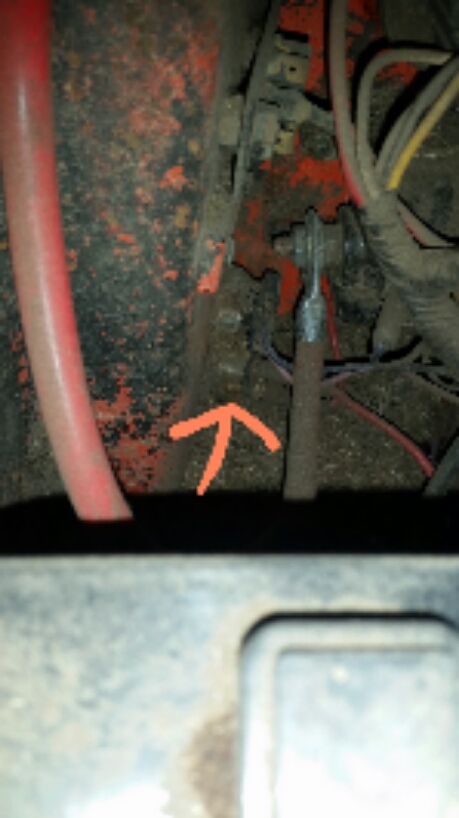

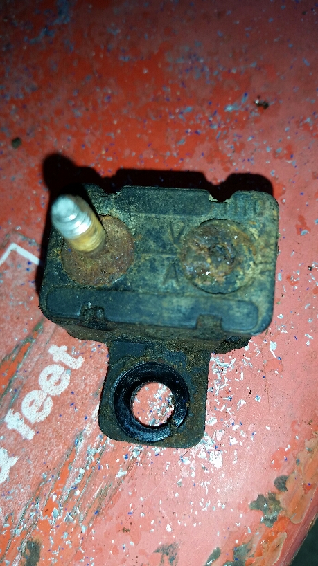

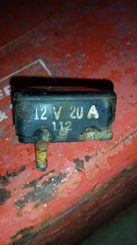

Posted By: irlbeck A-C'S
Date Posted: 04 Jun 2015 at 7:22am
Here is where the circuit breaker is located.
Here is a picture of the circuit breaker. One of the post had corroded off.

Posted By: Albow44
Date Posted: 04 Jun 2015 at 5:26pm
Ok, that's where I thought it was. I'll have to dig it out of there this weekend. Does anyone have a parts number for one? I'm pretty sure once that gets replaced, as well as the solenoid she'll start right up. Thanks a million guys!
Date Posted: 04 Jun 2015 at 5:32pm
Talk to Steve at b&b or go to an auto parts store. They make a universal 20A breaker that will replace it. It will have 2 threaded studs and a single hole on the side for mounting it.
You may have just a bad connection with the wires to and from the breaker.

Posted By: Albow44
Date Posted: 04 Jun 2015 at 7:36pm
http://m.advanceautoparts.com/mt/shop.advanceautoparts.com/p/bussmann-circuit-breaker-20-amps-bp-cbc-20hb-rp/25984935-P?searchTerm=20+amp+circuit+breaker&zoneAssigned=1&prefZC=17044&prefStoredSet=1&un_jtt_redirect
Would this be it?

Posted By: Albow44
Date Posted: 05 Jun 2015 at 5:54pm
Just pulled out the circuit breaker. One pole definitely eroded. Good call!
