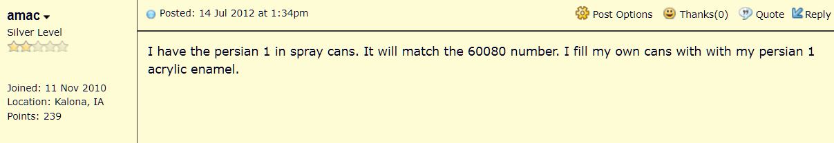

you might try amac...

AMAC is no longer in business. I think Merlin retired and closed shop. I reached out to him a few years ago. He had great PPG paint, sprayed nicely and the color looked great. That was PO2 though. I’m positive he sold PO1 also. I still have 3/4 of a gallon left. Bought 3 gallons at that time. Wish I had more. Unfortunately the formula is no where on the can. Local PPG dealer said to spray a flat panel and bring it back and they would let the computer take a picture of it and go from there. Allis Chalmers Alkyd enamel Q1590-9090. They said those numbers didn’t come up in the system.

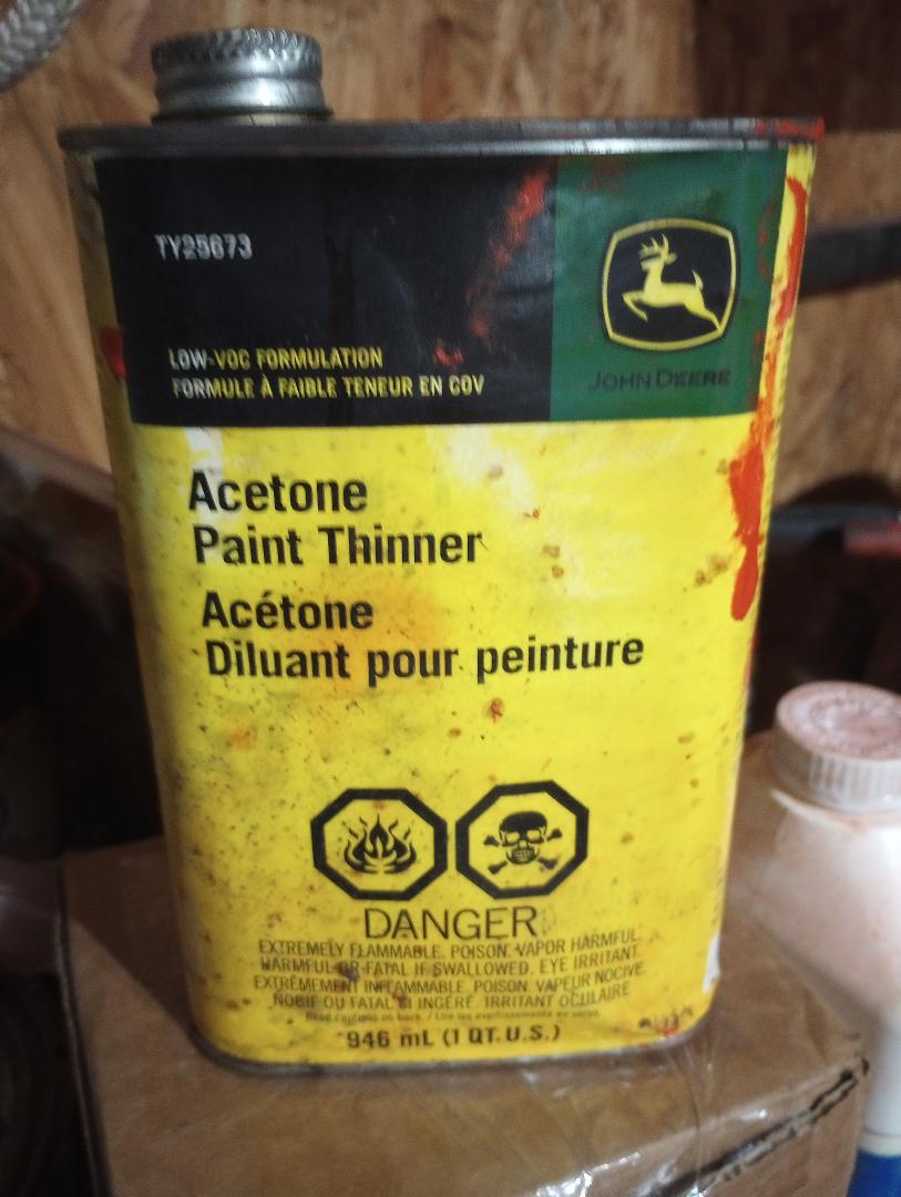

WF owner what do you use for reducer ?
WF owner View Drop Down
Joined: 12 May 2013
Location: Bombay NY
Points: 5325
Post Options Post Options   Thanks (0) Thanks(0)   Quote WF owner Quote  Post ReplyReply Direct Link To This Post Posted: 31 Jul 2023 at 7:06am
I use this acetone from John Deere, but acetone is acetone. When this is gone I will probably just buy acetone at a local hardware store.
