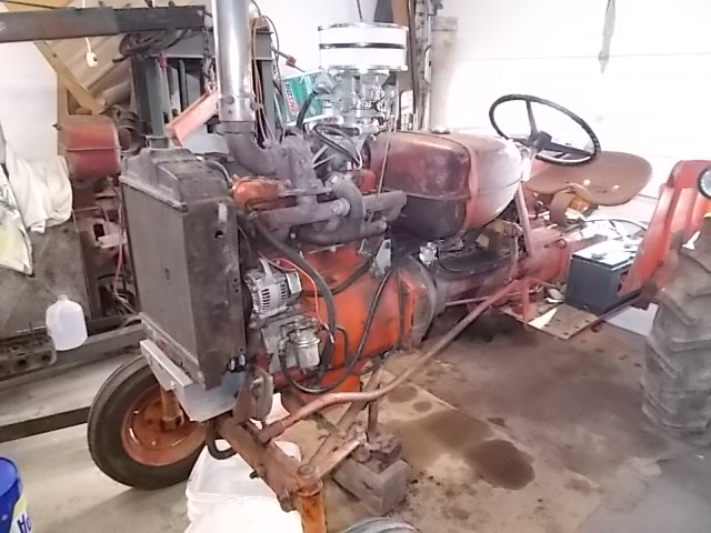

If you want POWER, TURBOCHARGE it Thumbs Up
  After I finish with work that is needed in the rear and transmission, it will get bigger tires.
If you remove the pan, you'll see how close the top of the rod bolts get to the cam as things are now. There is really no room to get closer. As the cam is hollow, you don't want to go grinding into it for clearance.. The rod journals are small enough already, so you really don't want to go using a different rod with a smaller journal if you expect it to live. I've seen a motor that the fellow said was a 4" stroke, although all he could show me was an inspection hole in the right side.
