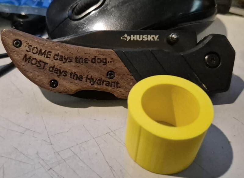

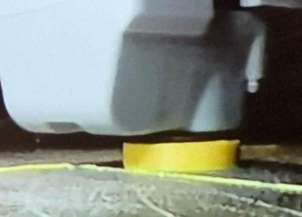

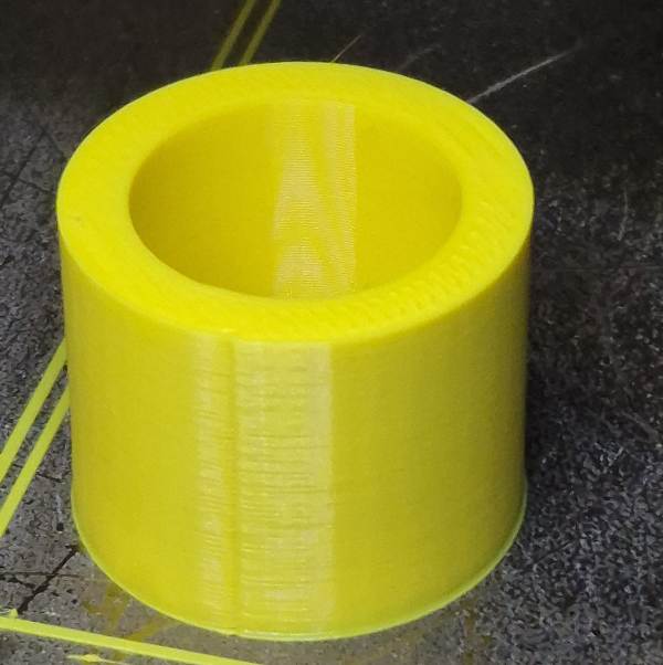

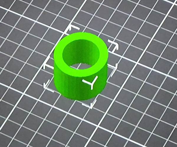

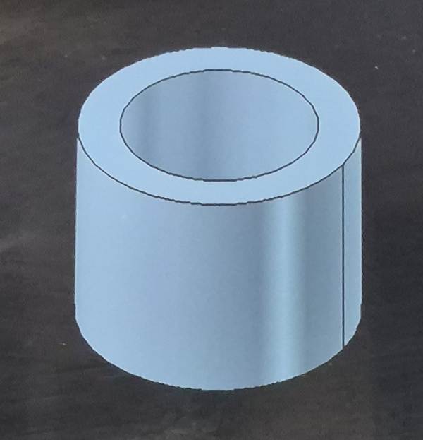

Correction... I drew it in 3... and going full solid (100% infill) it takes 18 minutes, plus the 4 minutes it does for self-test/calibration before a run...  this one is only an inch long, but it's running now.
I drew these to exact dimension... the printer nozzle is usually pretty accurate, but when going full-solid sometimes the IDs are a smidgen tight, and the ODs are a smidgen fat... so if either are really critical (meaning, it won't work with any variation), then either it gets hand-dressed to size (sandpaper on a dowel) or I make a little adjustment to the drawing to compensate, and re-run it.
