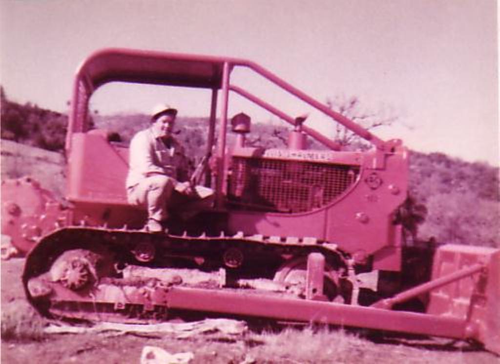

Would like to thank everyone for the great comments on our past restoration project and the logging show pictures. It was more fun than allowed by law, but we got thru it Thought we should post up what were going to try next. This is a picture of our father with the brand new HD11B dozer serial number #815,cable blade,Carco winch. It's a 1955 year model, the first year of production for this tractor. It was ordered from the Allis Chalmers dealer in Ukiah Ca., Akin Tractor and delivered in March or April  to the woods for logging the day this picture was taken.

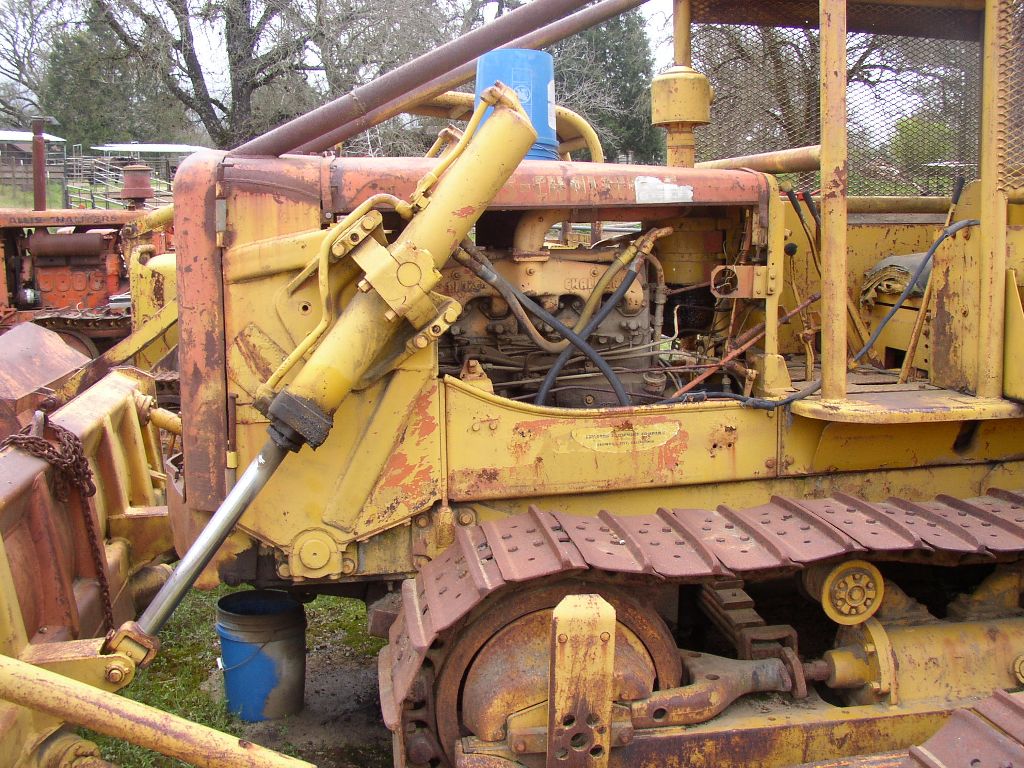

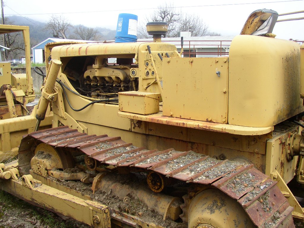

 We'll use this straight blade,converting it back to cable and we'll use this lanova style engine that did run. This tractor is also a 1955 year model. This tractor has a bad main case now from stripped bolts in the intermediate pinon caps. (we call them donor tractors)

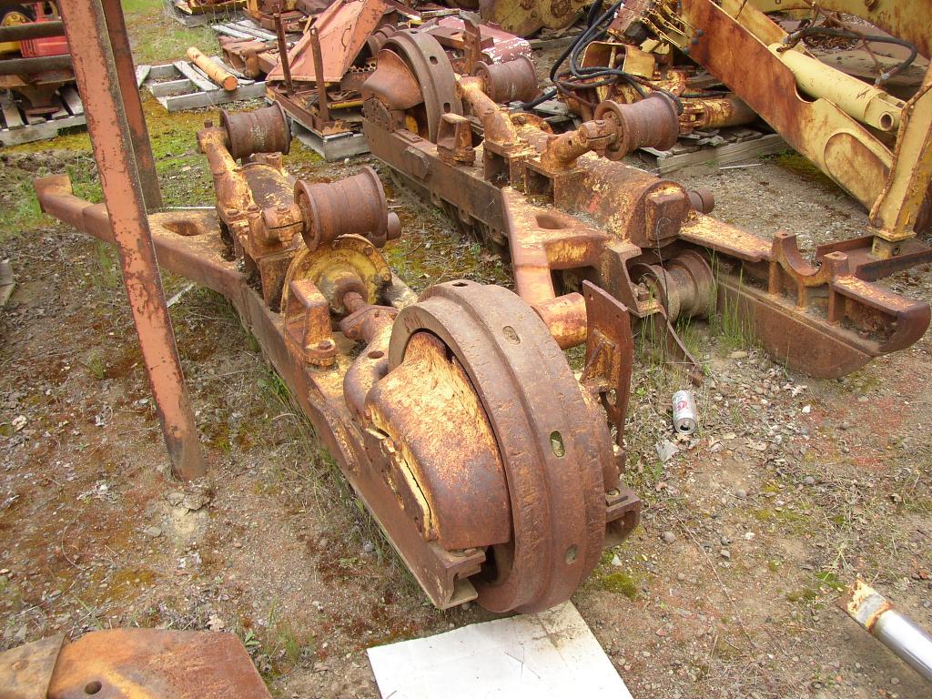

This will be the the transmission,frame and finals, this is a Lanova engine with a hole in the block, but it still has the dry steering clutches which we need (donor tractor)

These would be the swing frames and rollers

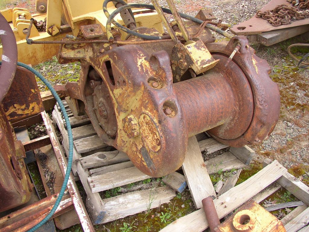

This would be the winch. All of these components were removed from a tractor that was the same year model except it had a cable angle blade (another donor tractor)

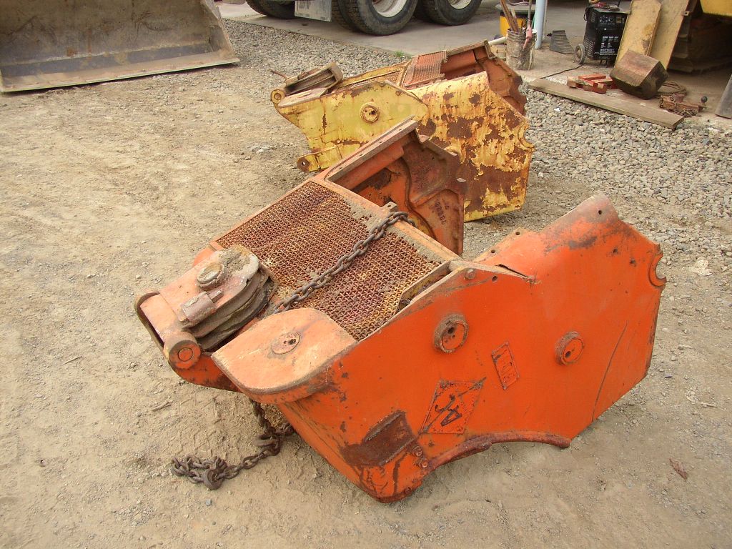

So my brother went down in back to the inventory and brought up the 2 choices for a cable hardnose, said here "take your choice,start at the front and let me know when you want me to start painting"  (so that's it,stay tuned)

Nice! Definitely keeping my eyeball on this thread since I missed your others. Love the pic of your dad on the new machine. How much would that have set one back in 1955?

Gday Mel thanks for posting the pictures its great to see your before and after pictures , Has someone put the track on backwards on that first tractor?

I'm pretty sure it was around $21,000.00 the way it was equipped for logging then. That was a lot of money when timber delivered to the mill was only $10.00-15.00 per MBF.

Steve, yes your right, both tracks are backwards, they were like that when we picked it up over 10 years ago

See quite a few pictures where someone has installed tracks backwards , wonder if the reason is to try to get more wear from bushings or ?
 Then it might be they run the machines more backwards than forward and it is the right direction for what they figured they were working in.

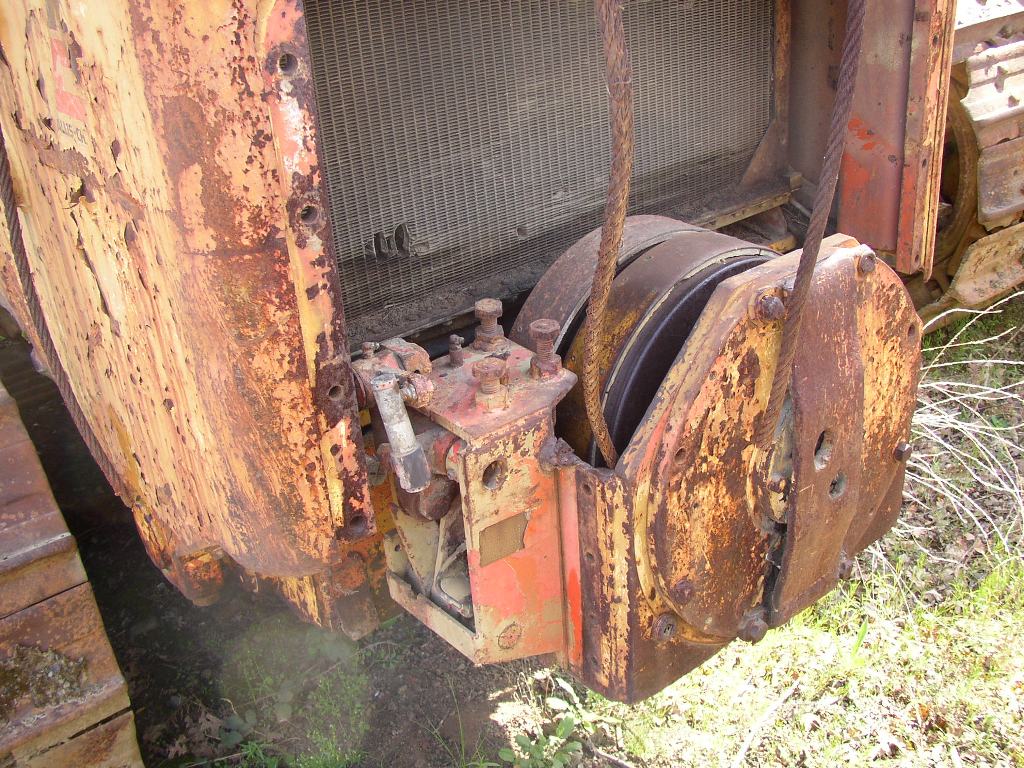

Coke, yes your right about backwards tracks.There could be other reasons, but are experience has always been most people just weren't paying attention or didn't realize there was a difference (we did it once) So the cable blade in this case is for rerestoration mostly. Hard to see in the early photo but the new tractor had a front mounted Garwood  cable unit, Model #151. The same model unit was used for 11s,16s,or21s, that allowed you to have your rear mounted winch still.Ironically are father opted for the cable controlled dozer at the time instead of the hydraulics  because the cable blade would lift higher and allow for more ground clearance around stumps. This would be the front cable unit.

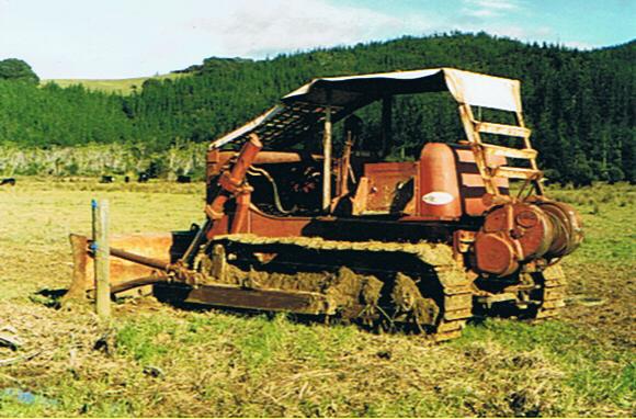

pic of a sister bush rigged HD11B1351 that made it to the bottom of the world !

Merv, Thanks for the comments, the sister tractor looks to be a 1956 model and you must still have the hydraulic tank on the right side of the deck. They only did that the first year or so before they put the tank and valve up in the front (and of course it's still orange too)

Yep hyd tanks on rh side fender;  is Mactractors machine now, has been in this area as long as me and did alot of work, still goes tooBeer
