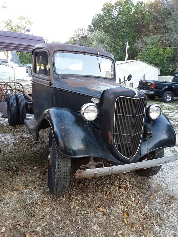

Changing directions a little but still fits in this Topic Heading.  Picked up this 35 Ford 1-1/2 ton truck.  Haven't gotten her to hit on more than 2 cylinders so far but pulled the distributor and a thorough cleaning and adjusting should help from what I've seen.  Previous owner said he had it running for a bit but I've discovered he had exaggerated some facts before the sale.  She does have 57K actual miles, and a PTO, considering putting a hoist on it, but first things first.  Haven't put air in the tires but they're probably so hard they won't go flat.

Very nice truck!!  I've always liked the old Fords.

 WOW! I really like it! I would also invite you to join the Ford Barn Forum. I have had a great success with help on my ragged ol truck from that site. (I am there with same handle)
 I like the looks of your truck! There is a new book on 35-36 Ford big trucks coming out soon too, semi-sponsored by Early Ford V8 Club.
Your dash looks great! What are your plans and what is some of the back story on your awesome big truck? What size tires will you be looking for?

Very nice ! Id drop an Allis 426 in it, make a Ratrod ! But thats me

  I would do a complete original restore on that beautiful looking ole truck

Been looking for a 37 to put in the line-up with my 37 WC, U and A but this came up I had to give it a look.  Attempting to put her back as original as possible, ignition/steering lock missing but switch and all work.  Thanks Sugrarmaker, will take advantage of the group and always up for a good read.  I also got a Ford flat bed in the deal but haven't made up my mind yet, would have to widen it by 5-1/2" but then fashion the hoist system.  She's got 20", five bolt wheels and all 4 hub caps are there and decent shape.

What motor is in a truck like that? Flathead V8?

Really nice shape!!

That is a cool looking front end

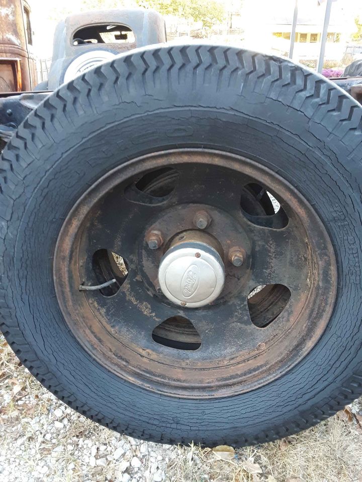

Be care of rims if split rims (widow makers) and not lock ring rims.

Make sure you are able to find the right size tires.
I have a 1954 Ford F-500.  Next impossible to find 7.50/20 or 8.25/20 truck tires.
Points: 36529
Post Options Post Options   Thanks (0) Thanks(0)   Quote DMiller Quote  Post ReplyReply Direct Link To This Post Posted: 03 Jan 2023 at 11:24am
Only GOOD Option is conversion to 18.5 or other Budd Style rims.

Lots of little issues will need to be addressed but all in all, it's in pretty good shape, no rust holes anywhere, even has the original floor board.  Yes, it's a flathead V8 but not sure which model yet.  Of course they make the tires, at 350 a pop.  I don't want to change the axles unless I absolutely have to but brake issues may make me rethink that.  If the motor or transmission turn out to be junk then it will get all different undercarriage but the plan for now is to keep it as original as possible.
The 18.5 conversion sounds intriguing, I'd like some more information.

As for wheels and tires, I would have a set of custom-made 19.5 wheels (Stockton Wheel, or someone like that) to bolt on to the existing hubs... go through the brakes thoroughly, make it safe to drive.

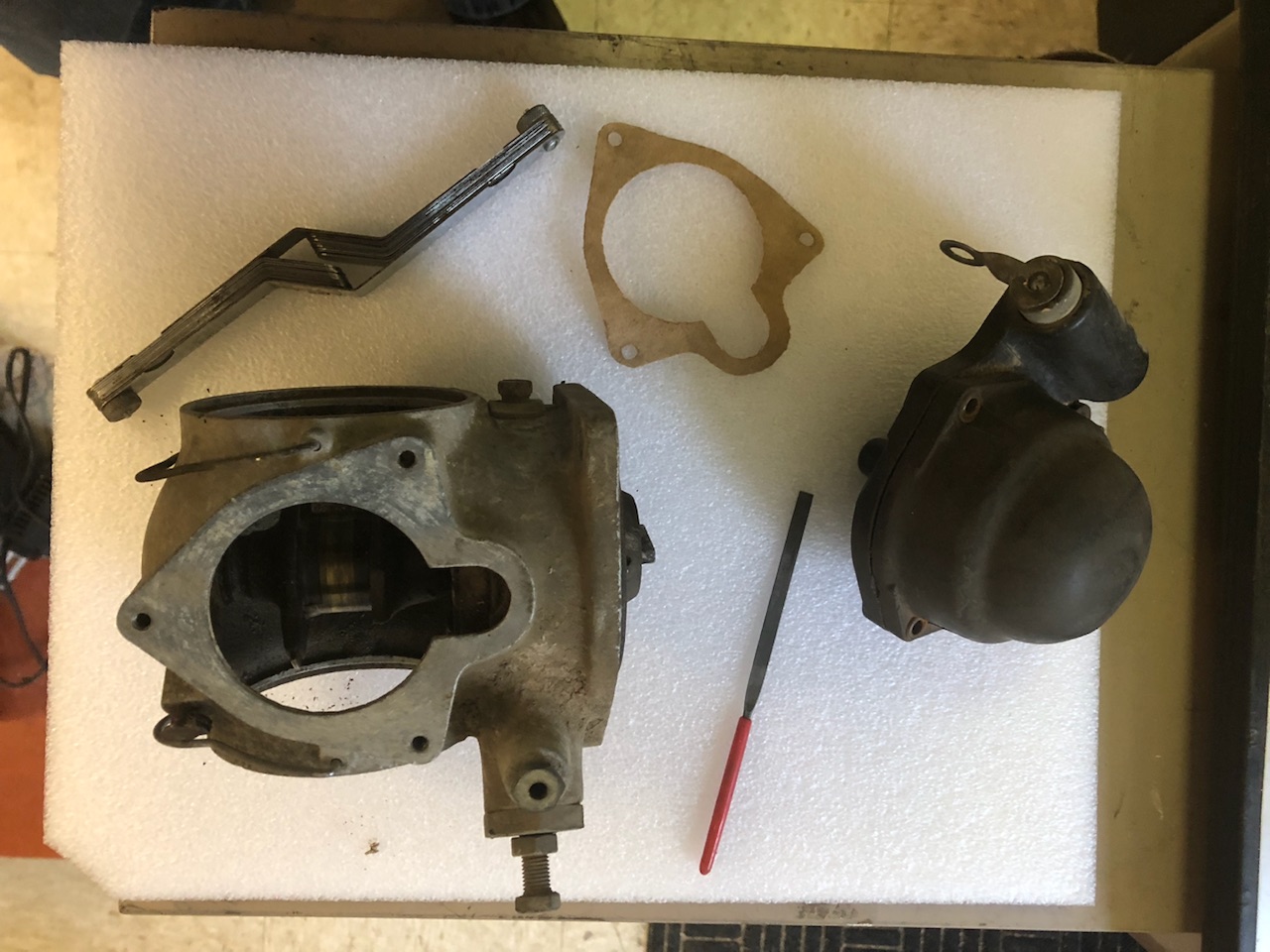

Today I set out to clean and set the points, gasket all but missing for the coil. Everything checked out OK, made a gasket and ready to reinstall. First gasket I’ve knocked out in years, taught my daughter and she was hammering out WC carburetor gaskets from age 10 but she up and grew up, moved out and got married so I’m back to making my own.

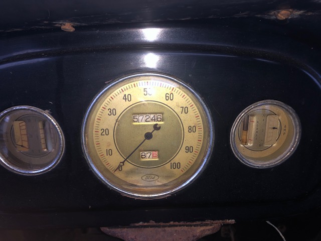

Nice find! I love the look of those old gauges.

The old girl runs as of today.  New plugs, plug wires, 2 new inner and 2 new outer distributor caps, a little gasoline down the carb and she came to life.  Mice took the stuffing out of the driver side of the seat and deposited it inside the muffler, the first pop blew that out and she purrs like a kitten.  Posted a short video on Facebook, now I need a get a second job cause I got a sneakin feelin this is gonna cost me.  The truck is one thing but this will probably add up to new curtains, furniture or whatever else will even out the spending.
