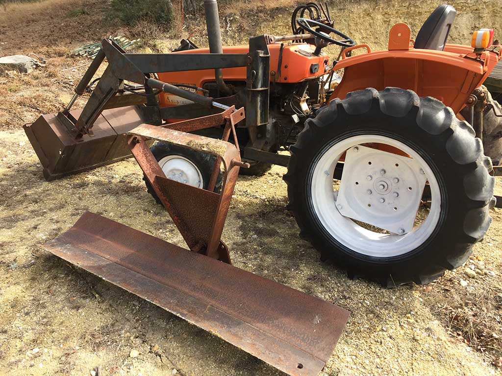

Forgive me for I have never owned anything but a little garden tractor. I'm a decent gear head but fairly clueless about tractors.
That said, on an impulse I ran across what I think is a 1980 AC 5020 4WD tractor. It just really spoke to me and I bought it. Probably over paid but such tractors are much in demand here (Texas Hill Country). The 4WD has been disconnected because of a bearing issue. Has a loader (not factory) on it that works. Starts, runs, drives but looks pretty worn out.
I'm guessing that parts are going to be an issue but other than the bearing, everything else seems to function. I'm mostly looking to find out where to look for parts, decals and such if they are available at all. I'd like to fix the 4wd and just get it looking more presentable. I'd like to be able to park it in front of the shed instead of behind it. (-:}

actually, that is an allis branded loader.  Model 430.  Have one on my 5020

Loader looks like it had CAREY STANLEY (close) written on the side of it (very faint, painted over).

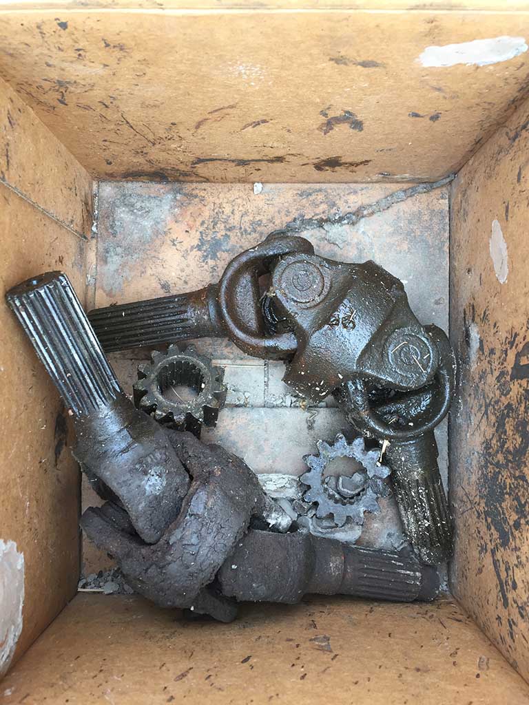

Guy I got the tractor from told me the guy HE got it from told him it only needed a bearing and he had taken these shafts out. I was told the tractor runs fine as long as I don't put it in 4wd. Seems odd to me. I just wonder what all kinds of crud have gotten in there. One shaft looks pretty good but one is caked in dirt. Assume the dirty side is where the bad bearing is.

Is that a break in the small gear to the right ?
Edited by Gatz in NE - 18 Jan 2018 at 10:50pm
No, just part of a mud dauber nest.

Do you still have the shafts with the u-joints and linkage that's in your picture?
