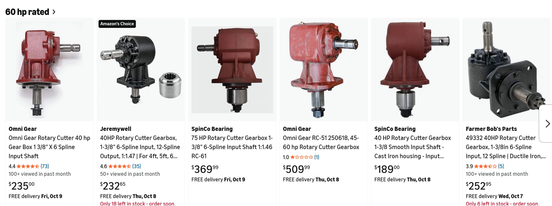

i am not familiar with that specific mower, but many Manufacturer BOUGHT the angle drive gear boxes instead of making their own.. It may have a manufacturer tag on it... If not, you can Google "angle drive gear box for 60 HP" and get a variety of options.. You just need to know if the input or output is splined or keyed or shear bolt style... I just did that for a generic 7 ft hog mower that was "generic"  manufacturer..
