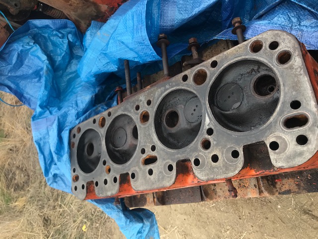

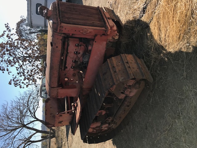

Hello all new here, I just picked up a model M the engine is stuck can’t find number on transmission but engine makes it a 1939. Any parts sources for these? Thanks!!

That M with the PTO looks very familiar to me, was it sitting with an All Crop combine by any chance?

I can't believe how straight it is. Looks real good. For that PTO miner leak I'd try a quart of brake fluid in it and run it for a while,  at least run it around until it warms up good. Those old seals dry and get hard over time but brake fluid softens them and makes them swell.               Leon

Congratulations on the M - they are a favorite of mine.  By appearances, it looks to be in pretty solid condition!  Pfouts is a good place to start, as well as placing wanted ads in the classified ads section of the forum.
By some of the features, I believe your M is earlier than a 1939, probably more in the 35-36 range, but parts can always have been changed too.  Your M is the wide-tread version too, so when you find the serial number it will begin with a WM.  Congratulations again!

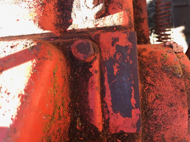

Could be earlier, I found the spot that i believe the number should be, It only has a Y stamped into it. The tractor was sitting kinda in a ditch next to a green fuel tank trailer.

The earliest M's had the serial stamped behind the master clutch inspection cover.  Here are the two locations I've seen most M serials stamped.  I think I may have seen one with it stamped on the rear of the machine, but it had some very involved attachments including an operators platform.  Would love to see more pictures if you have them.

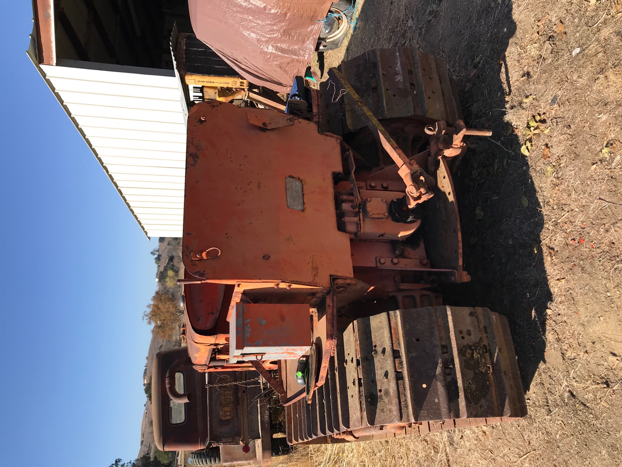

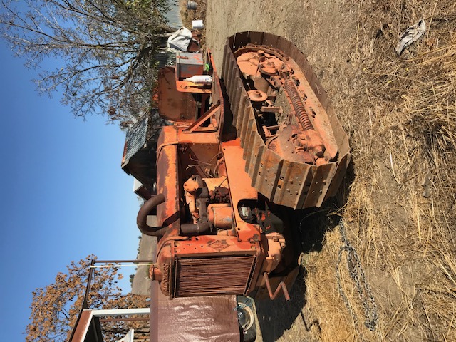

No number under the clutch cover spot. Here are more pics.

Thanks for the additional pictures - it sure does look nice.  I suppose the main housing may have been replaced at some point, negating the serial number.  Would have to go through the features to make a better determination of year.  Doesn't really matter though - it's great example of an M either way!

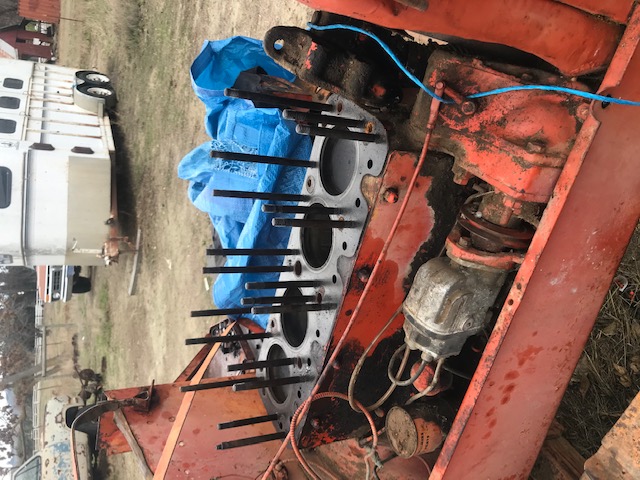

Hello everybody thought I’d post an update, got the engine free and turning well. Gonna be putting it back together this coming weekend.
