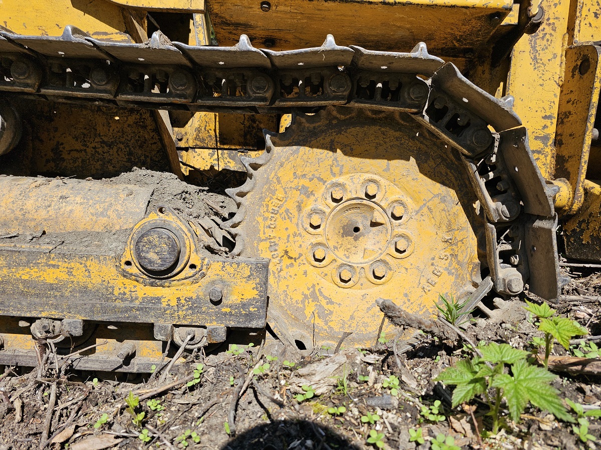

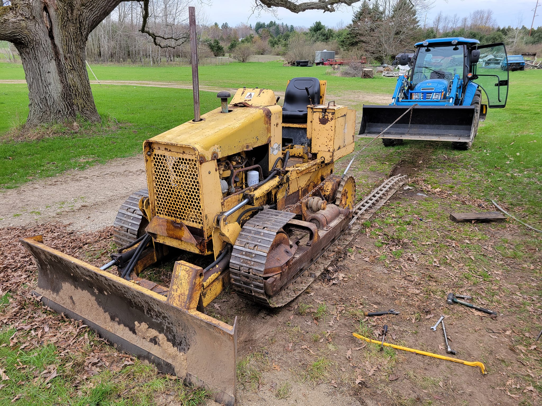

 I was able to remove a link on each side, and get the LH track going in the proper direction while I had it apart. The pic shows the RH side adjusted to the 1 1/2" sag per the maintenance manual, while the LH hasn't been adjusted yet. I feel much better now that the tensioners are threaded into the yokes, and the whole idler assembly tracks better. I can start putting some of the bolts back in the shims that were removed to tighten it up more.
 I will only be using this for light duty such as driveway grading, until hopefully I can find replacement tracks and sprockets. At least now I can run the machine and get the feel of everything and start cleaning it up with some fresh paint.

The left side adjustement is oké but the right need more adjustement.

Wha-cha got in the way of a press ?  How tight were the pins ? Pull together with a comealong or winch ?
 I used a old ball joint press I've had for about 30 years, it fit perfectly. The pins were very tight, I found if I tightened up the press as much as I could, then hit it with a hammer the pins moved, did this a couple of times and they came out.
 I used my tractor to pull the track when I removed it, and a comealong to tighten the tracks together.

A pic of the tractor helping out.

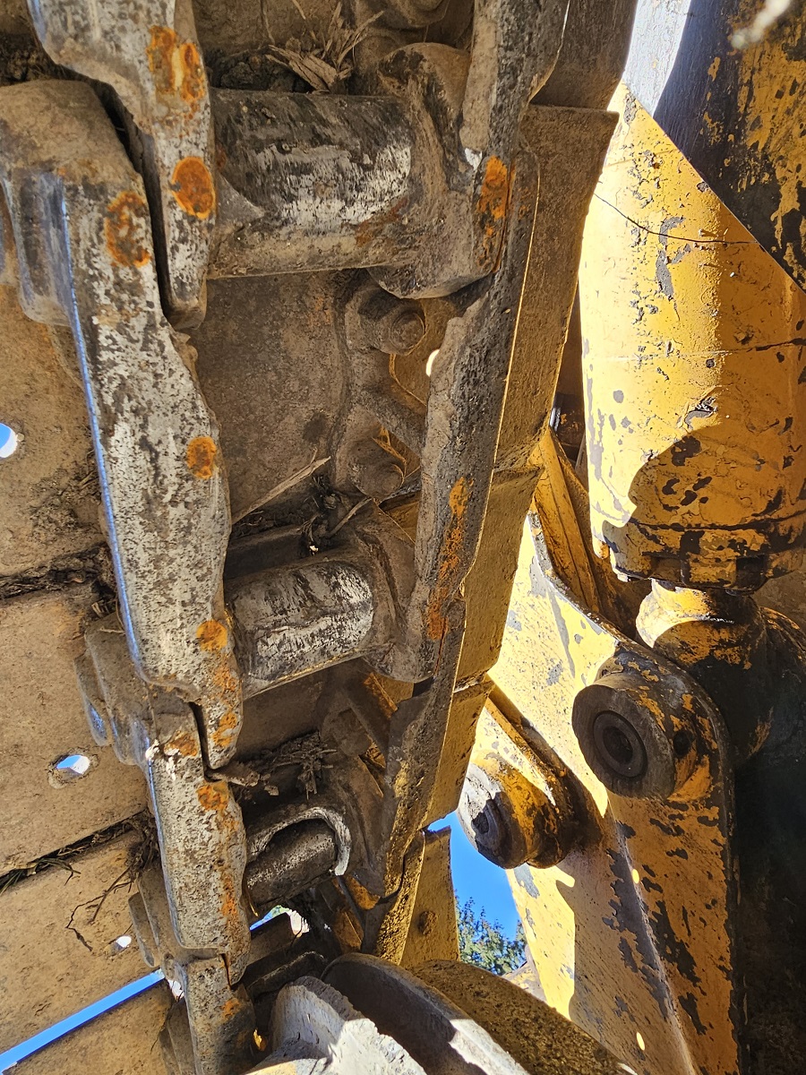

After discovering that the bushings on my HD4 track are worn right through to the pin in some places, I am VERY interested in any info you have on this Alibaba/Chinese source.

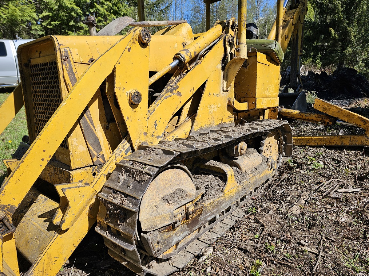

In closing, here are some photos of my machine. I think the sprockets appear to be in decent shape still, but that's just based on pics I've seen of other machines where the sprocket teeth look like they've been worn down to the point of looking like sharks teeth.

Originally posted by Les Kerf Les Kerf wrote:
For the life of me I can't see how removing a track link can change the contact points on the sprocket, not saying it doesn't happen, I just can't see how? I understand the wear has changed things, but that has already been done and I look at it as the sprocket and links have wore together. Like removing a link from a motorcycle chain, it shortens it, but doesn't change its geometry? I know that's is over simplifying it.
 I'll look into flipping the bushings and pins, but I'm not sure that would be enough to remove enough slop for the tensioners to thread into the yokes properly.
[/QUOTE]
Well, yes and no.
Removing a link allows you to take all of the slack out of the chain; the chain has already 'stretched' due to wear, and if you pull it tight like a fiddle string then each link is now slightly longer, thus preventing the bushings from settling down into the sprocket.
The contact point is now higher up on the sprocket tooth and above the previous wear area. Since the same amount of force is now concentrated in a smaller area, this area will wear more rapidly than before, hastening its demise.
If the pins and bushings have never been turned, it will indeed help to have this done because the bushing area would then fill the sprocket more fully, plus the pin and bushing contact area is at a different spot inside. The chain will appear to be shorter.
If the pins and bushings have already been turned, then your options are now:
A) Run it as-is and hope the track stays on
B) Find a better set of tracks (good luck with that!)
C) Park it and use it for a yard ornament
D) Scrap the machine
E) Remove a link and get what little life remains out of your machine
If you do remove a link, run the tracks as loose as you can get away with
[/QUOTE]
A stretched track washes out your sprocket because it lengthens your pitch. Pitch has nothing to do with the number of links you are running.
