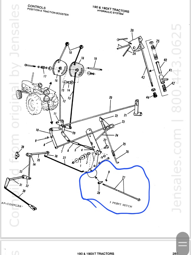

I'm looking for part 0234574-1.
It's the 'sensing rod' that connects the bell crank to the 3pt lower arm on the right side of the tractor.

With your draft arms let down to "level", grab a hold of them and see if they can move forward/backwards by pushing/pulling on them by hand. There should be basically zero movement. If there is, the torsion bar hex ends, left mounting bracket and bushings are worn out. That link rod is what sends the draft signal to the "Traction Booster" system to  transfer weight when plowing with a mounted plow.  The TB system is useless if things are worn out.

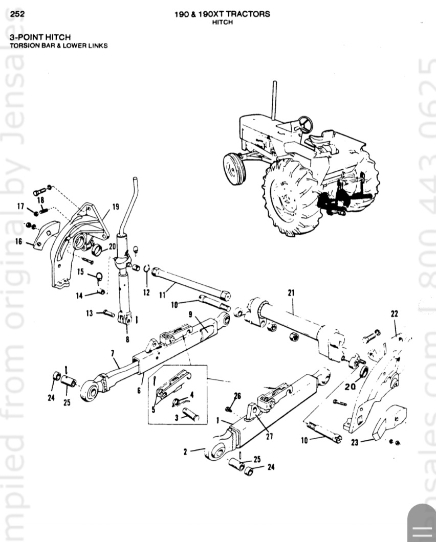

So looking at parts
11, 19, 20 in this pic? Is there any hope on 11 and 19? How warn is too warn? Anyway to repair them without CNC?

Post Options Post Options   Thanks (0) Thanks(0)   Quote 8070nc Quote  Post ReplyReply Direct Link To This Post Posted: 10 Oct 2026 at 2:37pm
With a milling machine and a indexer sure. I know a man that had thise parts repaired. I dont know what welding on the torsion shaft would do to the temper of it. It might take the spring out of it

Post Options Post Options   Thanks (0) Thanks(0)   Quote DrAllis Quote  Post ReplyReply Direct Link To This Post Posted: 10 Oct 2026 at 6:18pm
The pictures confirm that while it is worn, it could still be considered functional because it isn't bottomed out on the rearward swing. Make/get a link rod and adjust as per owners manual.
