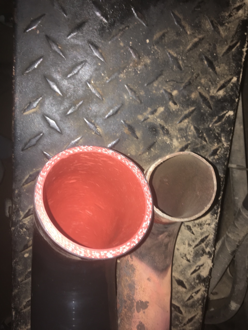

Post Options Post Options   Thanks (0) Thanks(0)   Quote shieldslx13 Quote  Post ReplyReply Direct Link To This Post Posted: 09 Apr 2019 at 9:38pm
Old vs new intake crossover

Post Options Post Options   Thanks (0) Thanks(0)   Quote shieldslx13 Quote  Post ReplyReply Direct Link To This Post Posted: 10 Apr 2019 at 8:00am
My 220 will be getting the same setup and a front mount air/air intercooler
