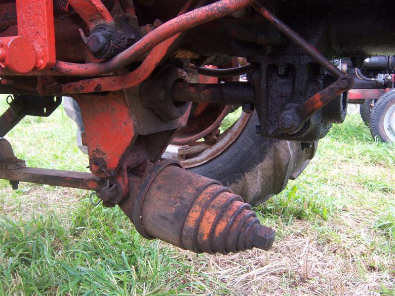

Post Options Post Options   Thanks (0) Thanks(0)   Quote Ted J Quote  Post ReplyReply Direct Link To This Post Posted: 18 Dec 2015 at 7:17am
Are you talking about something like this?  Look at GrayRay's WD pic just a short ways down.
OOPS.....forgot the URL
http://www.allischalmers.com/forum/forum_posts.asp?TID=113705&title=whats-your-pride-and-joy-tractor

Post Options Post Options   Thanks (0) Thanks(0)   Quote WD45 Quote  Post ReplyReply Direct Link To This Post Posted: 18 Dec 2015 at 7:32am
Yes , that is the spring.

Post Options Post Options   Thanks (0) Thanks(0)   Quote CTuckerNWIL Quote  Post ReplyReply Direct Link To This Post Posted: 18 Dec 2015 at 10:08am
That spring was common on WD's with plows up till the SC set-up anyway.

Post Options Post Options   Thanks (0) Thanks(0)   Quote Brian G.  NY Quote  Post ReplyReply Direct Link To This Post Posted: 10 Apr 2019 at 11:17am
Some people call this the "beehive" spring.
It was an option when ordering the plows.
I would guess it was used for the drawbar
mounted plow on this particular tractor since
it has neither the pin hitch nor the snap-coupler
bell.
