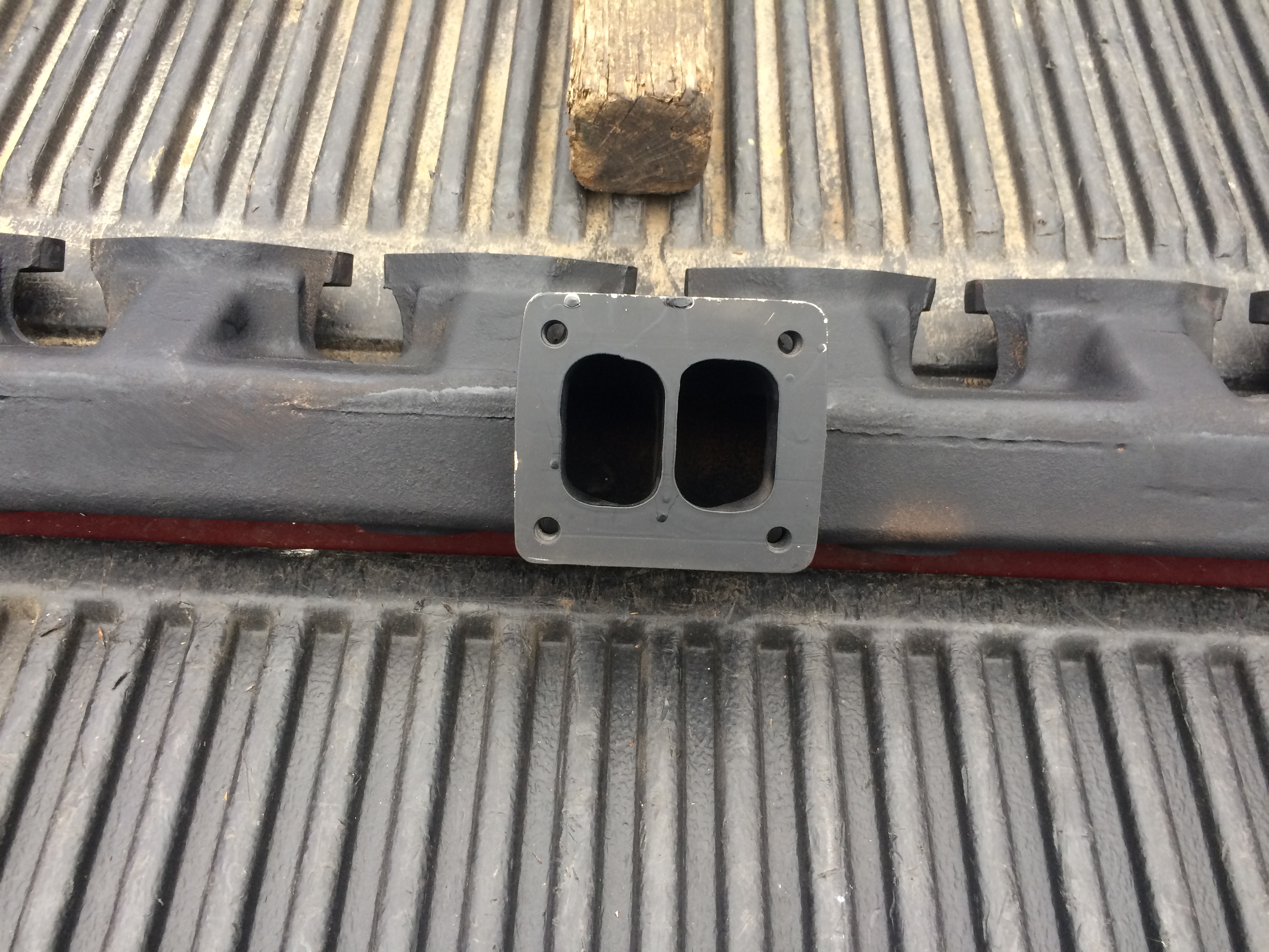

Post Options Post Options   Thanks (0) Thanks(0)   Quote cms Quote  Post ReplyReply Direct Link To This Post Posted: 19 Mar 2026 at 5:39pm
Here’s an option.

Post Options Post Options   Thanks (0) Thanks(0)   Quote DrAllis Quote  Post ReplyReply Direct Link To This Post Posted: 19 Mar 2026 at 8:14pm
The reason the IH-400 series manifold is superior to the A-C original manifold is because the exhaust gases basically take one turn out of the cylinder head port and then head down the tight sized runners. The tight runners keep the exhaust gases from expanding until they hit the turbo exhaust wheel, which is more efficient. The manifold is also designed for the "pulse" effect by splitting 1-2-3 and 4-5-6 to separate runners. This manifold pictured still takes two turns for the exhaust gases and the runners look to be large which slows down the exhaust gases speed. It is split ports at the turbo mount but that's about it.
