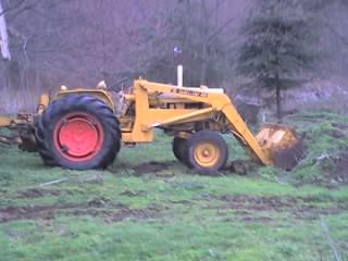

I'm looking for the decals that go on the side of the boom for the I-40.I also need the lengths for the indicator tube and rod that show the tilt on the bucket.
Thanks in advance.

If you still need the tube and rod length for the loader - please email me and I will go measure mine.  I have an all stock I-40 with Allis loader and backhoe. Sorry it does not have the decal your looking for - but I had someone make me the front I-40 for each side of the radiator cover.

Here is a copy of the sales lit.
Brad

Brad,
Just measured the indicator rod for my Loader.
Tube is 26 1/2" long and the Rod is overall 44" includes 1" of threads that go thru mounting bracket on loader.
Hope this helps,
