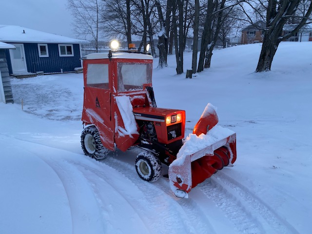

Post Options Post Options   Thanks (0) Thanks(0)   Quote snowman(MI) Quote  Post ReplyReply Direct Link To This Post Posted: 28 Jan 2026 at 5:53am
It is back alive with power steering and hydraulic.  Was a matter of tracking down the relief valve components of which I ordered online from a parts house on Dec 31, only to find out that a month later that the parts were no longer available from the manufacturer when I spoke with a real person.  They wondered if I wanted to cancel the order, ha ha.  So, off to an ebay search of which Small Engine Parts Warehouse had the complete kit of Simplicity bagged parts in a larger bag with an Allis Chalmers tagged part number.  Had the parts in two days.  Got the pieces installed, did the pressure check of which I didn't get all of the spec'd pressures, but things appear to function as they should.  Took it for a test spin with the blower and will finish up today getting the soft sided cab back on.  Will be nice to have the power steering and hydraulic lift on my winter warrior.
Thanks for the help of tracking down the tribal knowledge I need to get the hydraulics working as they should.
