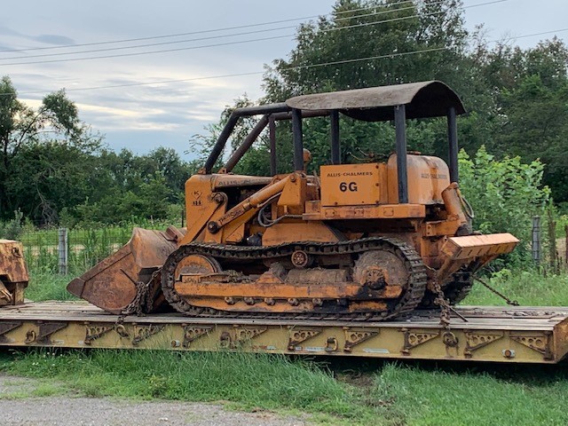

I have an HD6G that I'm working harder than its had to work for the last 20 or more years clearing fence rows.  We've had this machine for about the last 50 years so I do have a little history with it.  The machine sat idle for about 15 years up until about 4 years ago.  But I was able to get it started after new batteries and refreshing the fuel.  Over the last 4 years I've used it for some small short term projects with no noticeable issues.  However, I started using it to push over some trees while clearing an old fence tree line.  The longer I use it the weaker the hydraulics become.  Can anyone point me in the right direction? I have not been able to locate a new hydraulic filter.  I don't have a book on the loader part of the machine so any information would definitely be helpful.  Recommended fluid? Filter part number?  Any other suggestions..... Thanks for the help

I have finally gotten back to work on this HD6G and still not having much luck.  My gut tells me its a problem with the hydraulic pump.  Here's what I've done:
1)  Drained the old hydraulic fluid and replaced with new.  While draining I found a lot of dirt in the tank.  The Suction screen was completely plugged with stuff.
2) I have not been able to find replacement filters from anyone I've tried'
3)  I cleaned out all of the dirt out of the tank prior to refilling.
The hydraulics is still sluggish when bucket is empty particularly after it gets about 1/2 way up.
With the bucket full (with dirt) it does not want to lift it.
I do not hear any unusually noise or sounds when operating.
At idle it will only lift the empty bucket about 1/2 way.  I have to increase the RPM to get a full lift.
I'm thinking I probably damaged the pump by using it with the plugged suction filter.
Any Suggestions on next steps?  I this Hydro pump still repairable?
Thanks for any and all help and suggestions.
